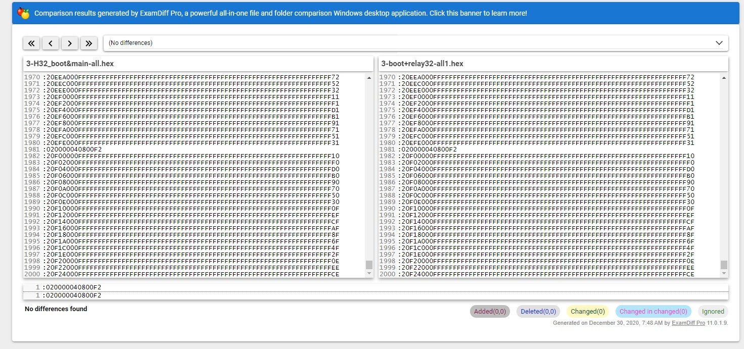

Dear Admin and technical guys. I got into my email firmware for my K868-H32 PLC
1st was named 3-boot+relay32-all.hex - after downloading I could't start working with my keyboard and new extended switch board Confused
You send me new file named 3-H32_boot&main-all.hex
I compare this hex file and it's the same file only name was changed. Checksum 0xBBC71F is identical on both files.

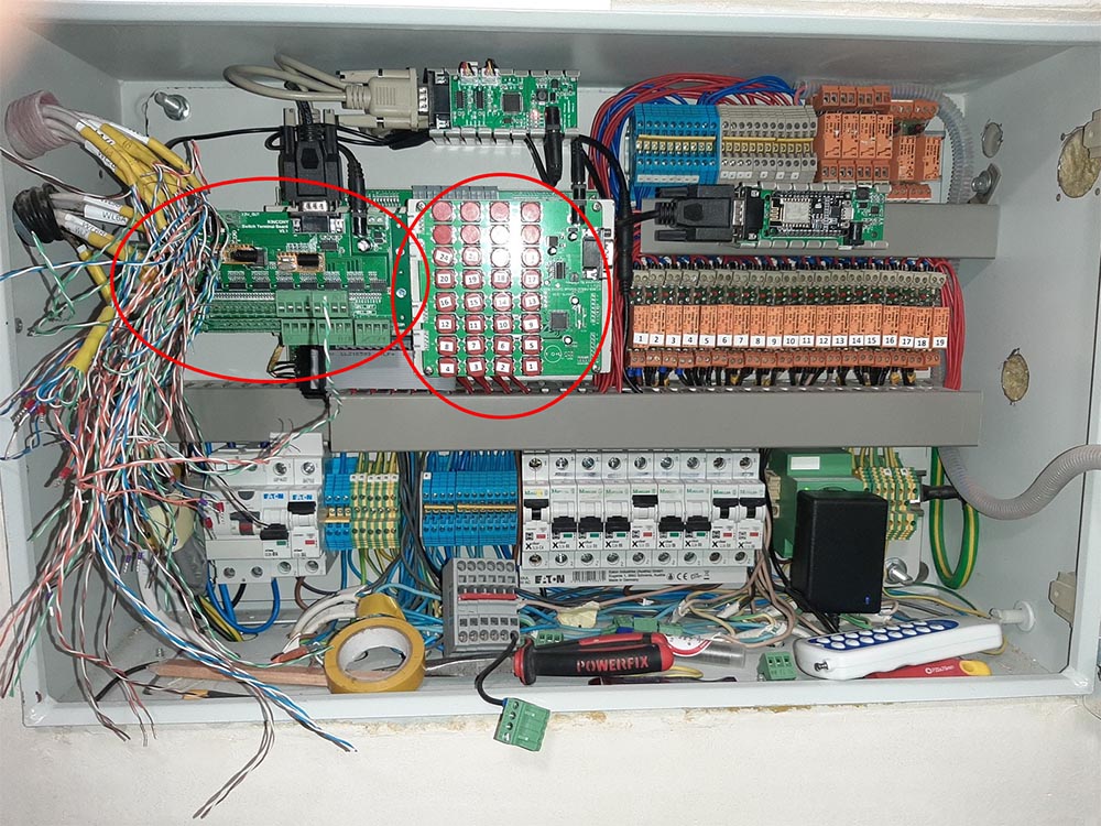

we have received your email, do you want to confirm with this red button board?
or you need to confirm with this board?
[Image: switch-board-1_pix750.jpg]
new switch board can't work with old firmware. other people updated the relay controller no problem. I think you can flash and download the old firmware for a test, if relay controller work well, then download new firmware again have a test. any questions leave message on forum. make sure every stop as our video, some settings.
