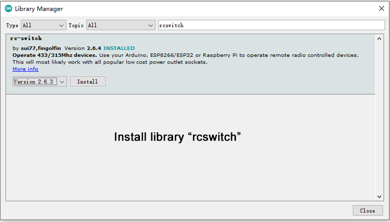

Code 2: //The demo code is 433Mhz receive code   You can copy the code to your Arduino IDE
#include <RCSwitch.h>
