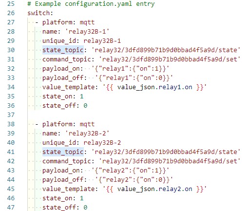

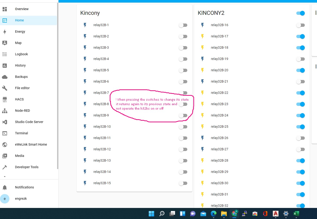

hello everyone , Please help me solve my problem
When pressing the switches to change its state, it returns again to its previous state and not operate the h32bs on or off
continued
