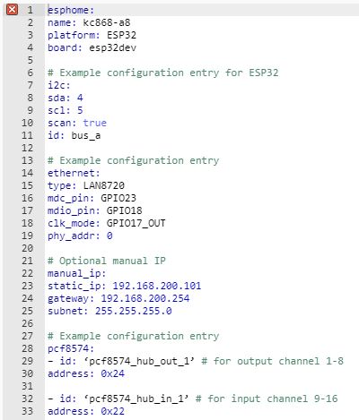

Reading configuration /config/esphome/IO_Bord_001.yaml...
ERROR Error while reading config: Invalid YAML syntax:
Duplicate key "– id"
  in "/config/esphome/IO_Bord_001.yaml", line 32, column 1:
    – id: ‘pcf8574_hub_in_1’ # for i ...
NOTE: Previous declaration here:
  in "/config/esphome/IO_Bord_001.yaml", line 29, column 1:
    – id: ‘pcf8574_hub_out_1’ # for  ...

[Image: KC868-A16_ESPHome.png]

check your space number behind - , because the webpage format problem.

it's format problem by webpage. look at the color of - and '
you can download this config txt file, unzip it , copy text to your ESPHome config file directly.
.zip   Made_for_ESPHome_KC868-A16.zip (Size: 882 bytes / Downloads: 1,115)
send to your email, but failure, you just download the zip file will be ok.
Working great.
