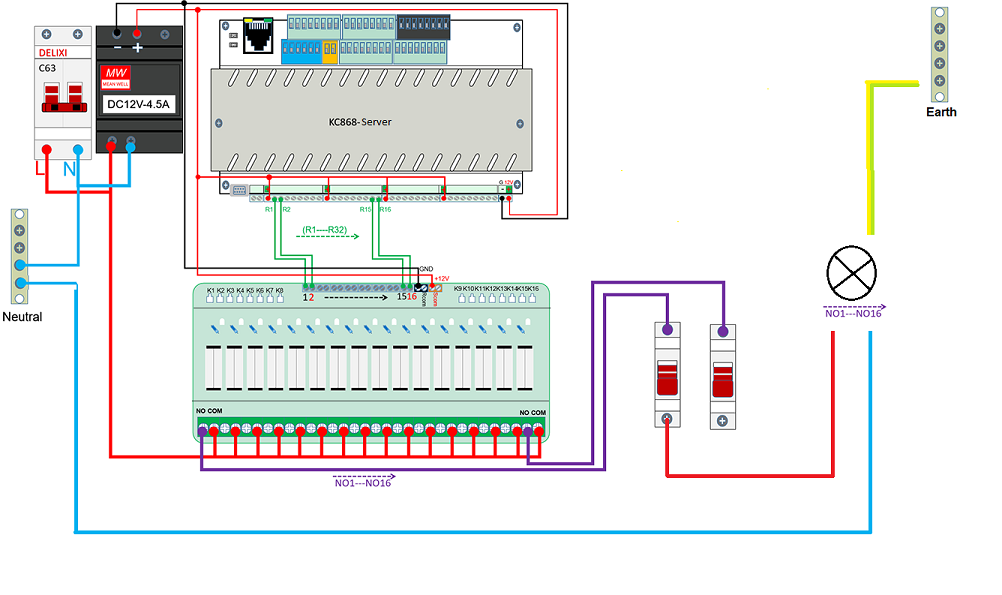

(03-11-2022, 12:51 PM)admin Wrote: https://www.aliexpress.com/item/10050034...0108.pic_3 Hello Admin, My wife not give me that much moneies. ![]() I have a basic design to get me started again, The time I will do it the correct way. Hopefully. I may send the h32l and the h32b back to you as they are no use to me as I cannot solder that good, May need address to send back. Can you just tell me if this design will work and protect The KC868-server, I'm under strict orders to get this right this time. Gary I couldn't find a suitable schematic for the KC868-Server so used this one?

you can see this link about KC868-Server schematic diagram : https://www.kincony.com/forum/showthread.php?tid=1747
we will make video lessons based on home assistant this year. your board have overload and burned. For safety, not suggest to use again.

(03-14-2022, 01:23 AM)admin Wrote: you can see this link about KC868-Server schematic diagram : https://www.kincony.com/forum/showthread.php?tid=1747 Hello Mr Kincony, Many thanks, Makes total sense now, I do have a question, As our monies are limited at the moment do we need to have the KC868-A16? Kind Regards Gary

that diagram just a sample project. you can use KC868-Server:1pc without KC868-A16, so that can use 16 channel output. it's up to you. just want to use how many load.
