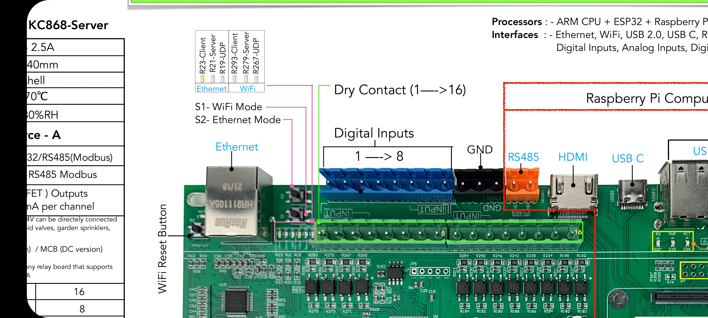

3. Plug your host PC USB into the KC868-Server USB port, making sure you have setup the board as described above.
4. Apply power to the board; Windows should now find the hardware and install the driver.

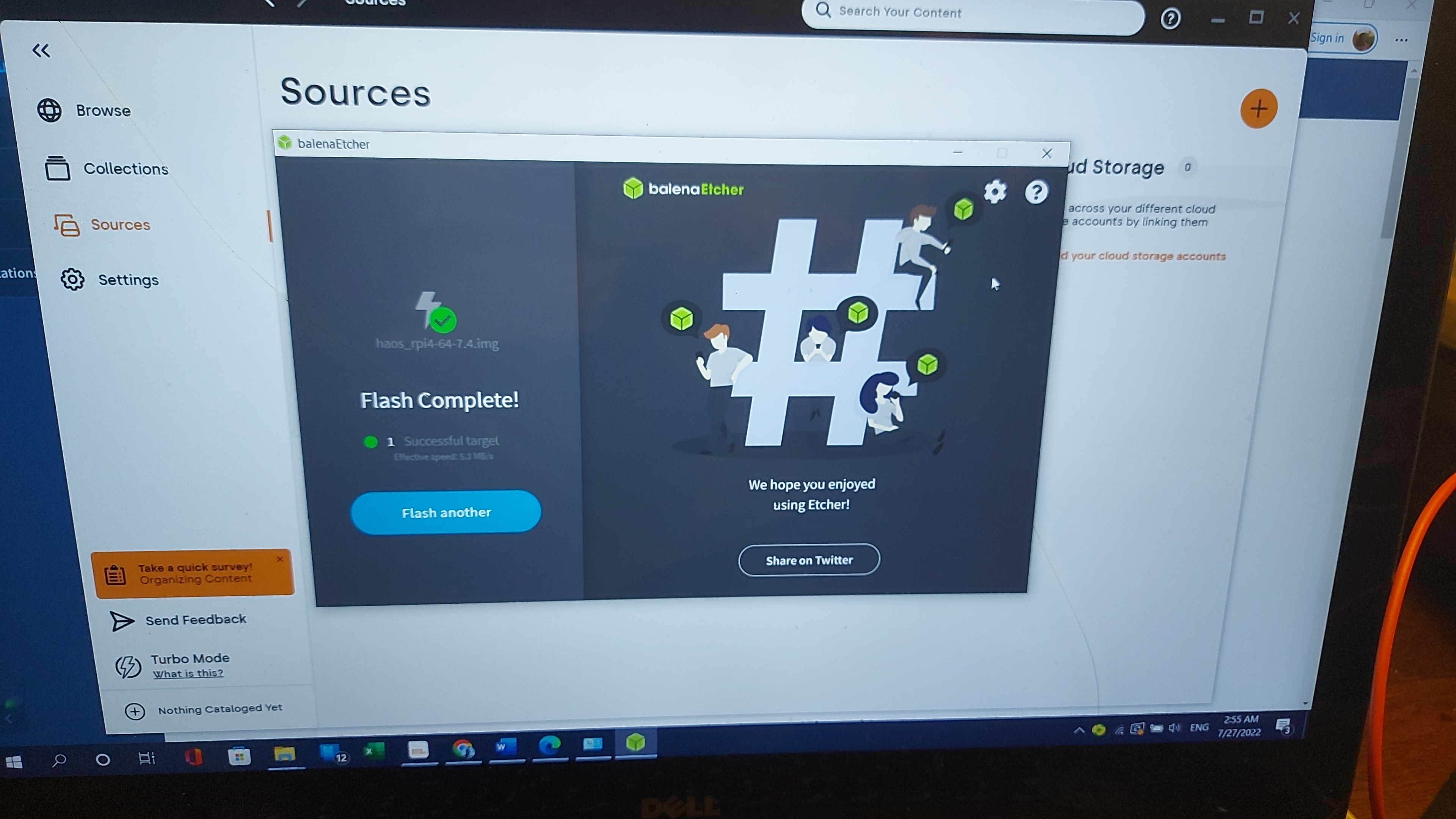

7. When Balena Etcher is finished writing the image you will get this confirmation

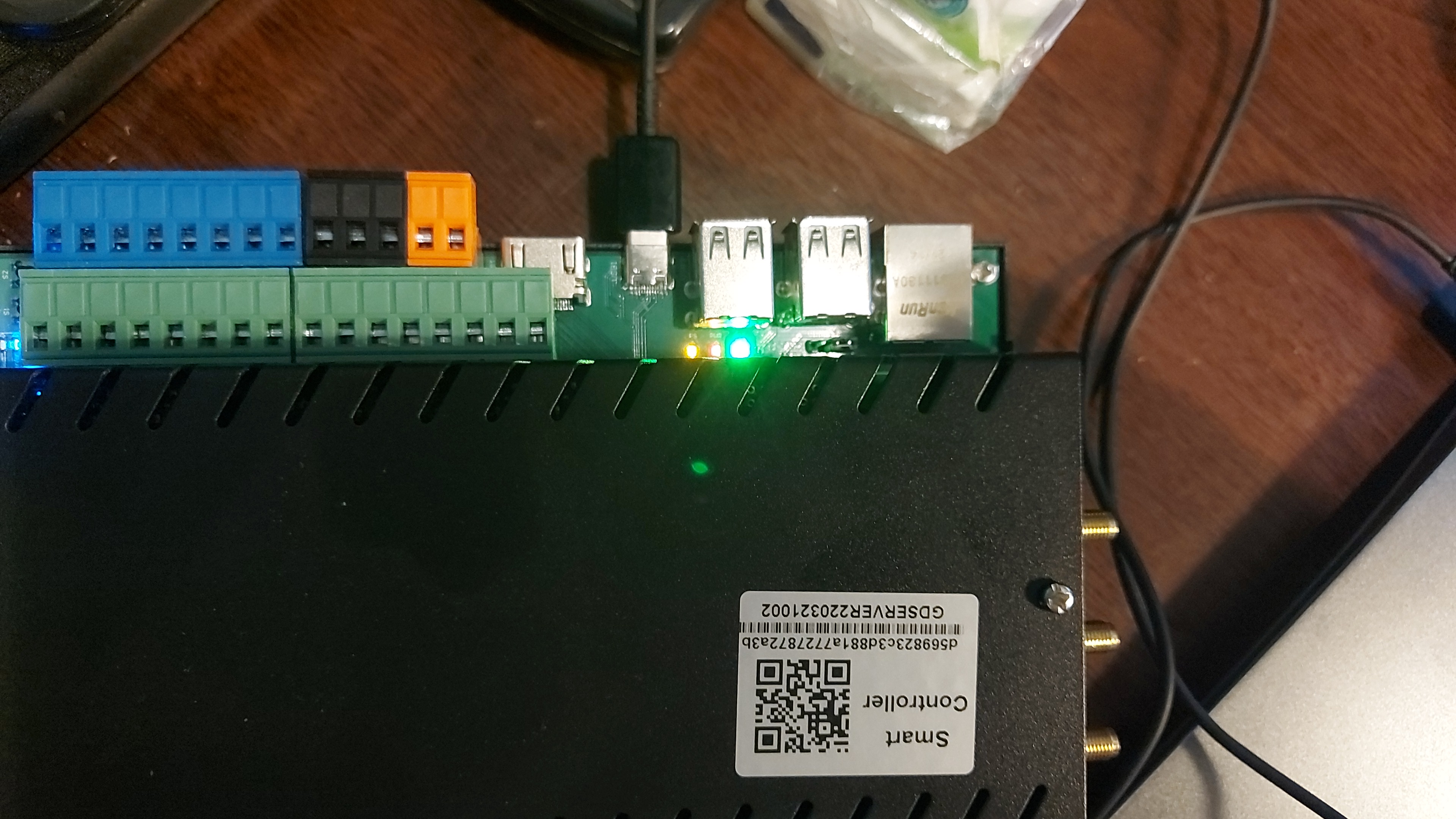

START UP YOUR KC868-Server
1. Insert the boot media (SD card) you just created. if use eMMC , skip this step.
2. Attach an Ethernet cable for network.
3. Attach the power cable.

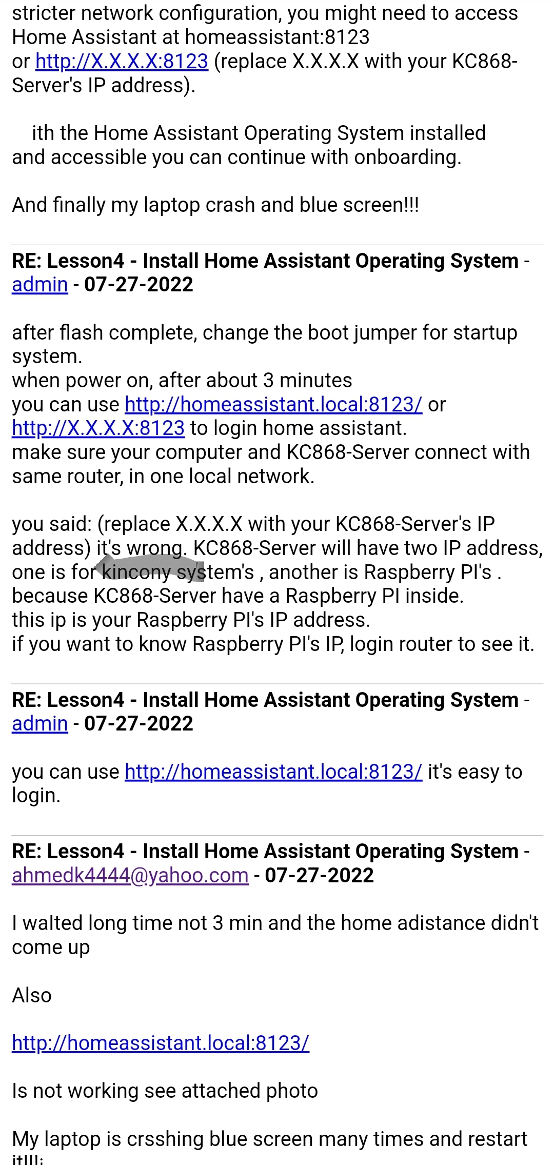

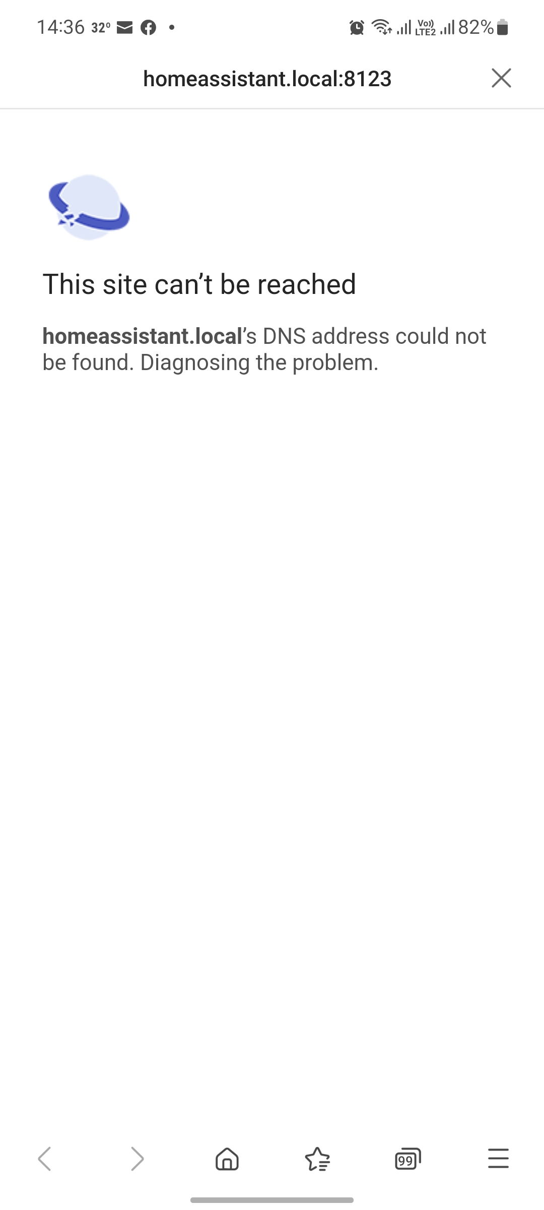

4. In the browser of your Desktop system, within a few minutes you will be able to reach your new Home Assistant on homeassistant.local:8123.
If you are running an older Windows version or have a stricter network configuration, you might need to access Home Assistant at homeassistant:8123 or http://X.X.X.X:8123 (replace X.X.X.X with your KC868-Server's IP address).
With the Home Assistant Operating System installed and accessible you can continue with onboarding.
