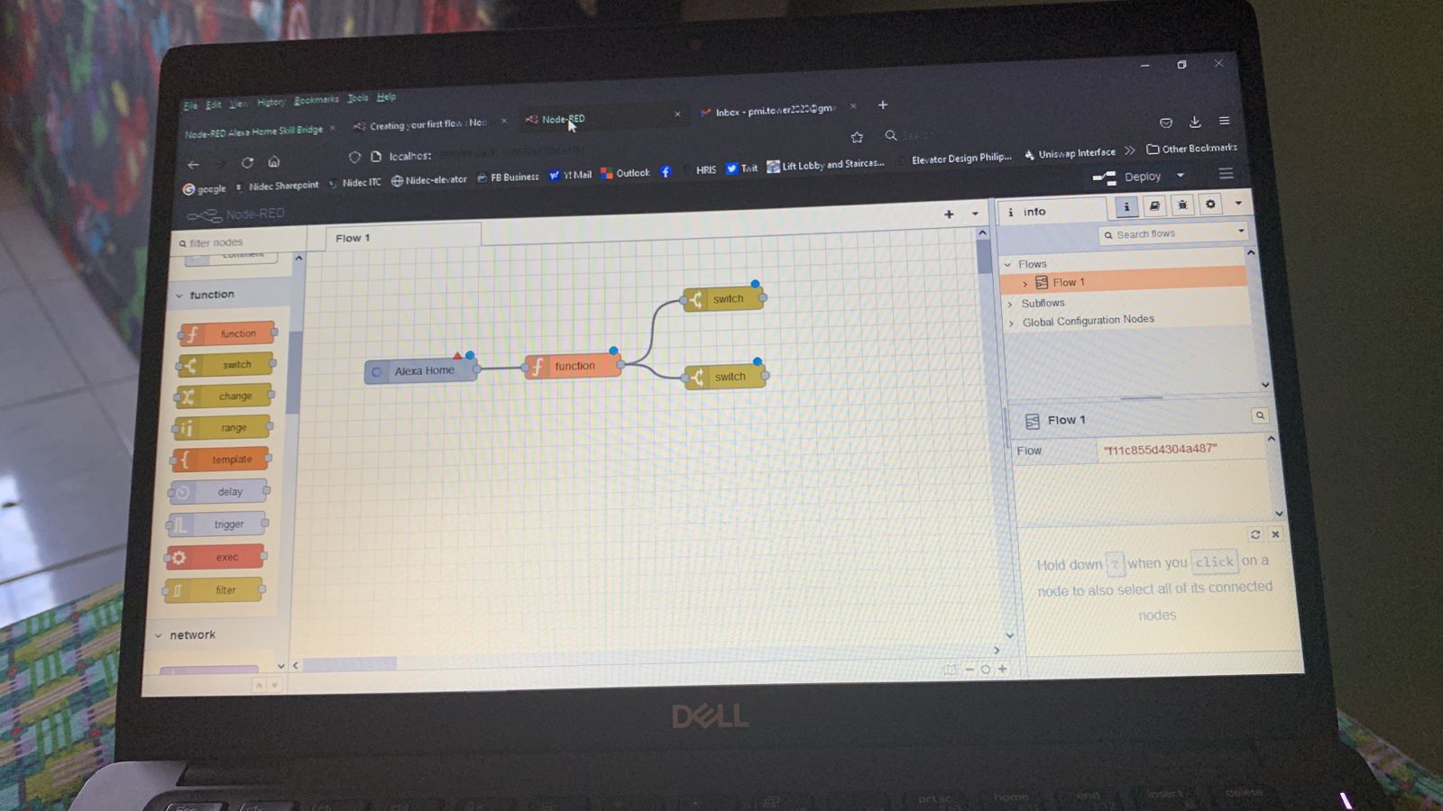

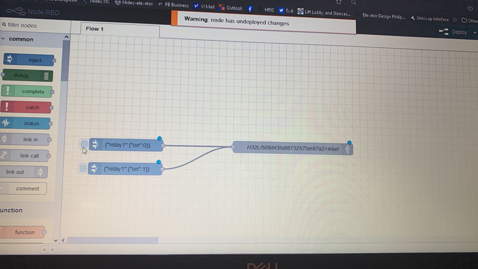

Scenario: I tried using the ESP8266 with the K868-H32L to link to Alexa. However, Alexa could only detect 10 switches out of the 32. Kincony notified me that ESP8266 is only limited. Now, I have a bunch of OLD PCs lying around with ready windows. Kincony told me I can use PC with red NODE. I managed to install and sign up for red-node. Again, Kincony support told me that I cannot use MQQT with K868-H32L. I am posting here because I need help how to set-up red-node using TCP-out.

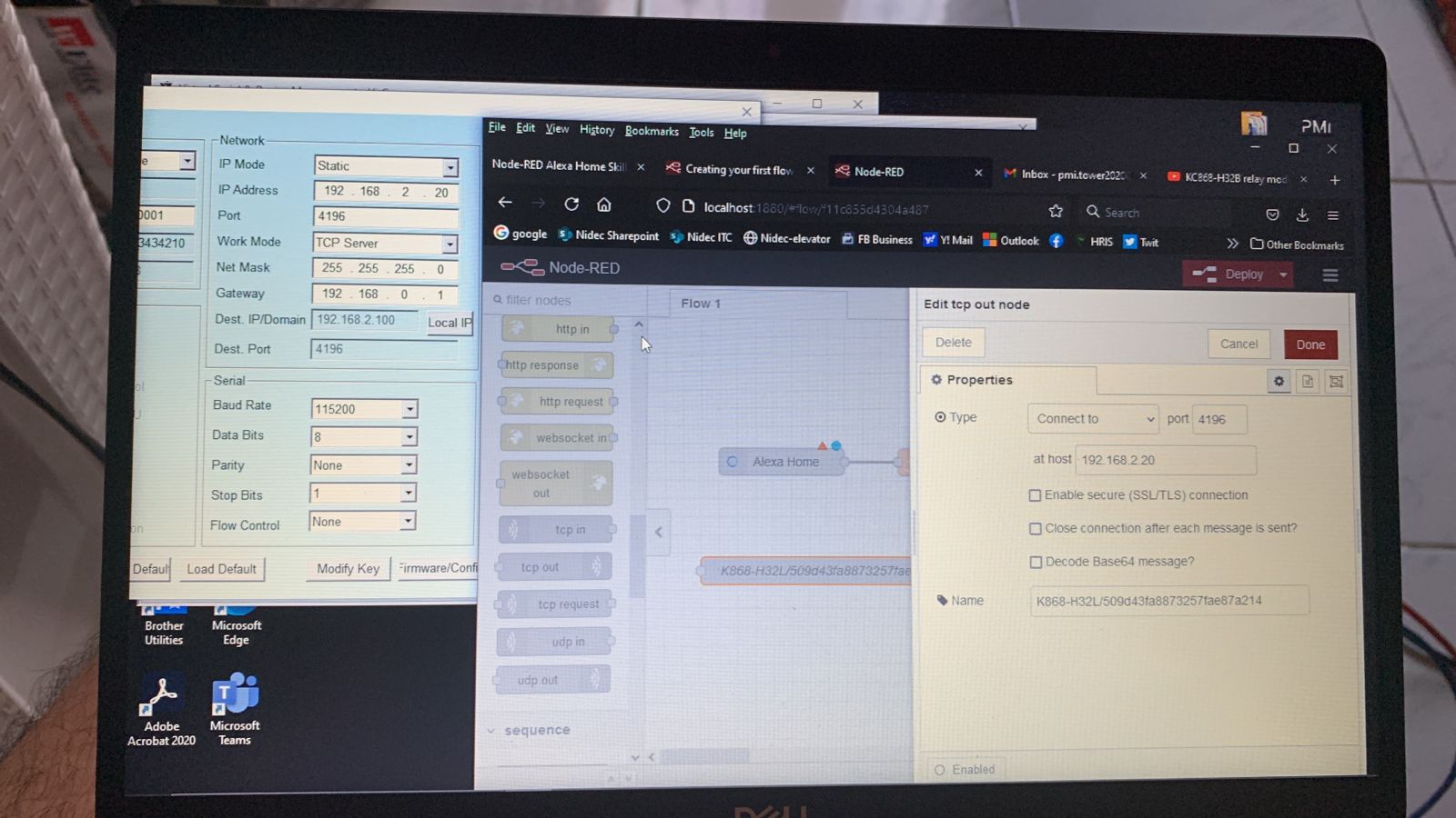

The videos posted are MQQT are very similar to TCP-out. I followed it however, TCP-out would not connect to my 868-H32L, I connected PC and H32L relay to LAN of wireless router, Internet access thru WAN of Wireless router, Alexa module connected to Wireless Router. Everything is working with the KC868-H32.exe pc software so I know parts are working.
I need to automate the system via Alexa. Kindly assist how to connect 868-H32L relay to red-Node via TCP-Out. The programming of Alexa to red Node is already in the MQQT videos.
