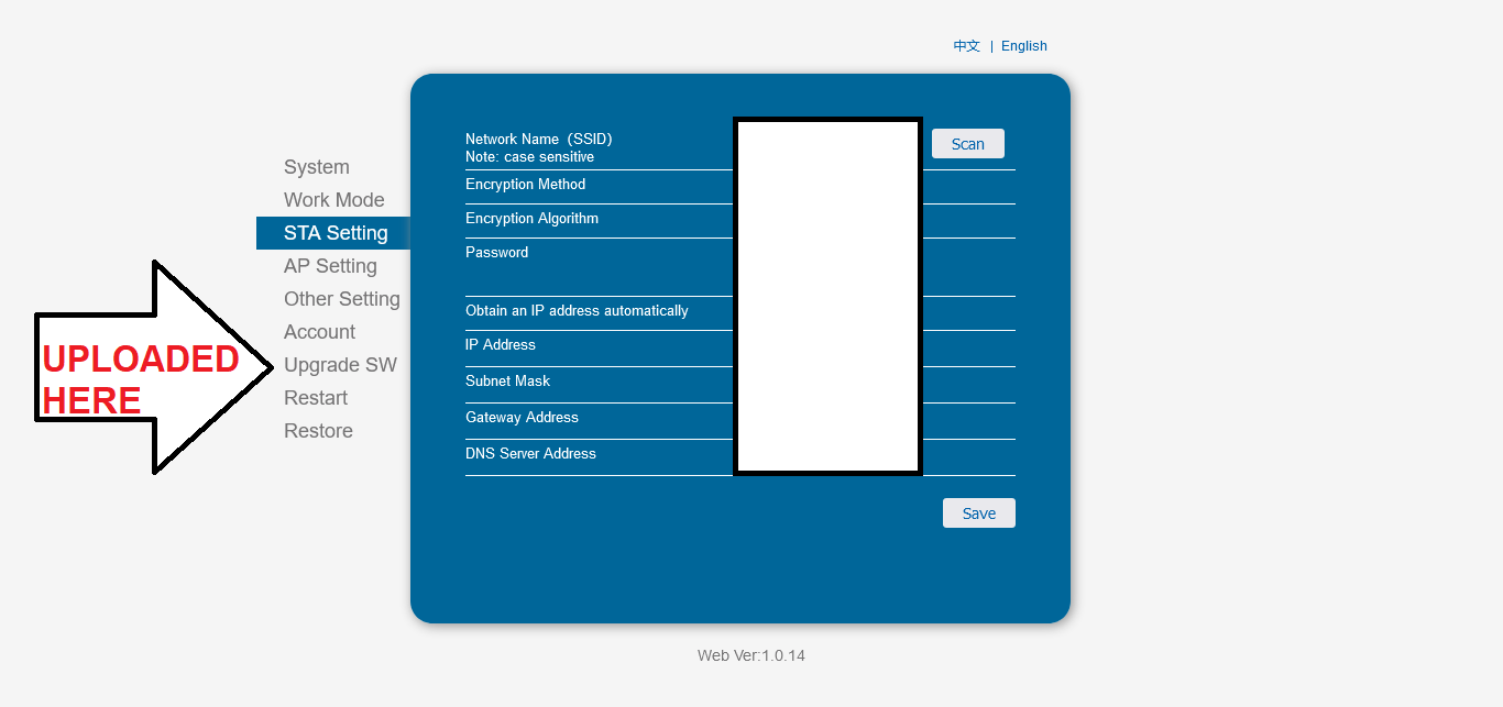

Hello.
i uploaded this firmware into the wifi TCP server page, but now it isn't work anymore... how can i reset it?
no, you have mistake update for the wifi module, you should update use by KinCony's update tool. give me your email, we send you the wifi module firmware.

I upload the wifi firmware in the same mode as i uploaded the h32b 4.44 firmware?

I have found this.. i tried to upload it by your firmware download tool but it doesn't work
http://www.hi-flying.com/download-center...0-firmware
can you find the AP "LPT230" , if you can find, just upload wifi module firmware as before.
Note:
wifi module firmware should upload by wifi module's tool (webpage)
controller's firmware upload by kincony's bootloader tool.
(05-07-2022, 03:07 PM)cris93ita Wrote:
(05-07-2022, 12:22 PM)admin Wrote: Monday when begin work , send to you.
after you download the firmware package ZIP file, here have a file "HF-LPX30_Module_Upgrade and Debug_V1.4.pdf" , you can see here have details about download wifi module firmware.
