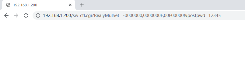

At last the HTTP command is :  http://192.168.1.200/sw_ctl.cgi?RealyMulSet=F0000000,0000000F,00F00000&postpwd=12345
After send this command: Relay32,31,30,29 will be ON,  Relay4,3,2,1 will be OFF,  Relay24,23,22,21 will be TOGGLE.

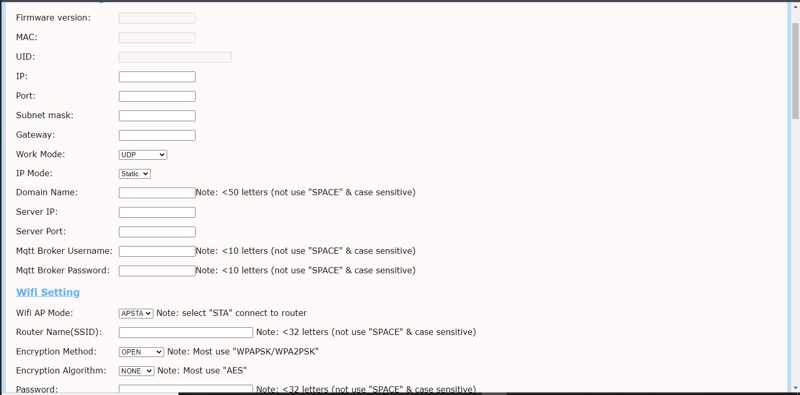

After the firmware, I can't log in to the configurator. It takes a long time to load the home page. Writes the wrong user and password.
after download firmware, password will be reset. just use username: admin password: admin to login
This is how the network settings are displayed
if you download to V4.43, how about the result? only V4.44 have this problem?
Yes, on the new firmware.

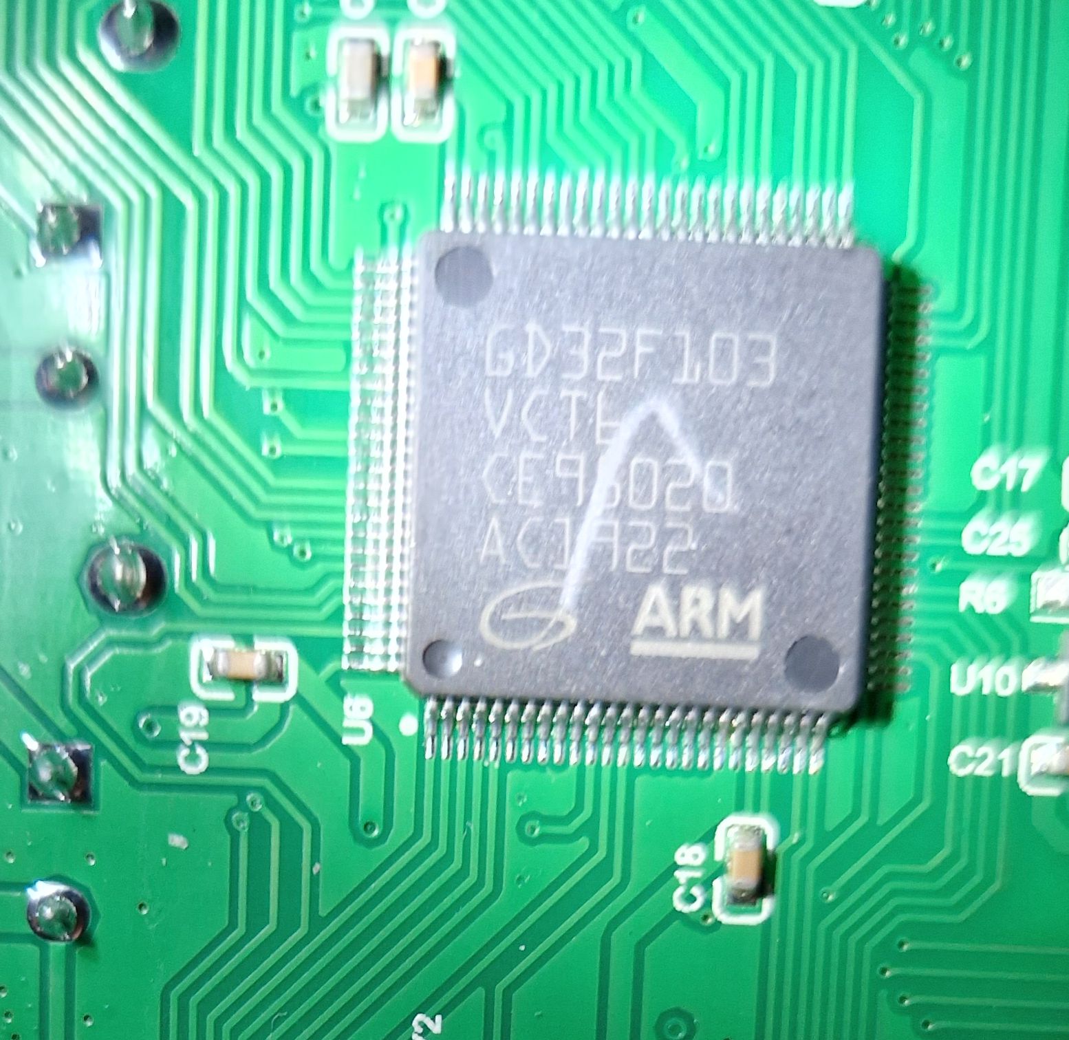

can you take a photo of your H32B's CPU. on the PCB, the biggest chip. I want to see the model.
now these, on the bottom of PCB, a black chip.
