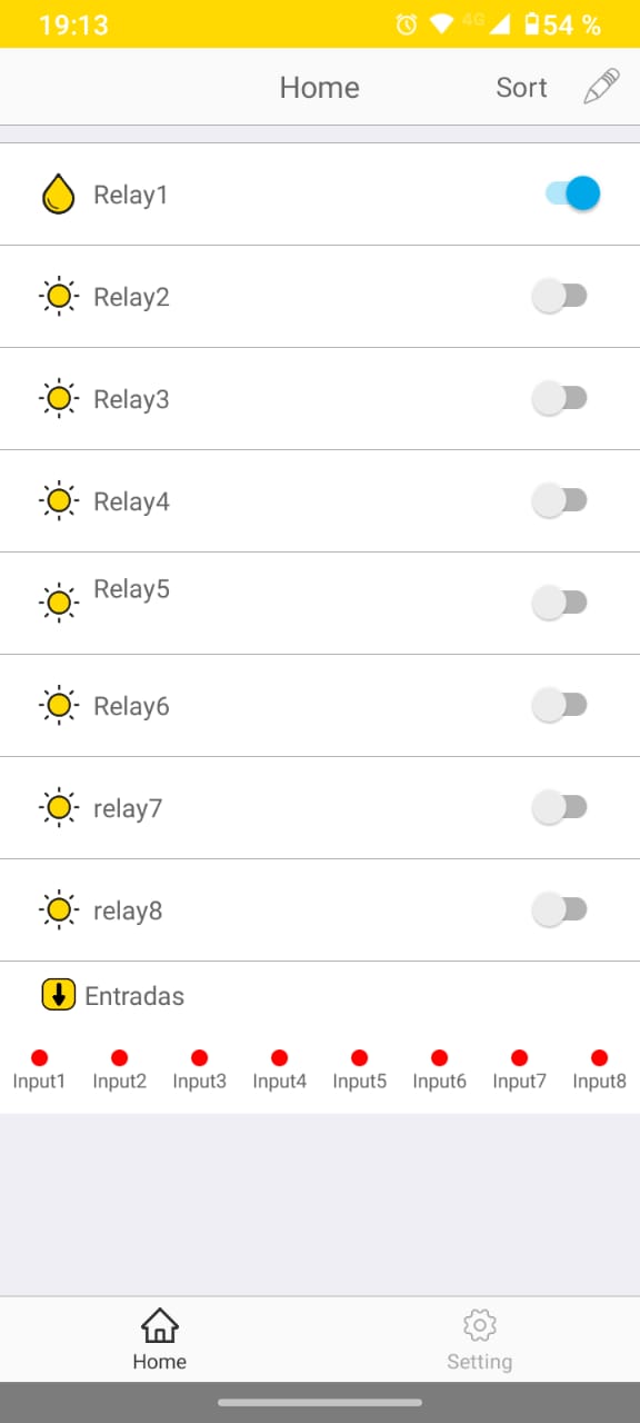

(05-04-2022, 11:40 AM)admin Wrote: use for "KBOX" phone app in local network , without internet.
hello admin.
I have a KC868-A8, I am trying to use KBOX to control the Relays, but running the application does not activate the relays, can you help me with this?
Thanks for everything.
this is the code:

(05-07-2022, 02:56 AM)Hector_Lozano Wrote: I think so,
I'm using for outputs.
PCF8574 pcf8574_S(0x24);
These two lines of code are modified into the following:
//Salidas -OUTPUTS
PCF8574 pcf8574_S(0x24,4,5);
//Entradas -INPUTS
PCF8574 pcf8574(0x22,4,5);
That's right, I modified
you should set the A8 to MQTT mode    i think now your code is use TCP mode
