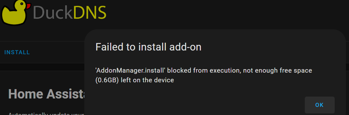

Hello, in my KC868-Server - unable to install duckdns it showing "No Space"

you can plugin a USB-disk to KC868-Server, move home assistant data to USB disk, then you will have enough space.
04-28-2023, 05:34 AM
(04-28-2023, 12:29 AM)admin Wrote: you can plugin a USB-disk to KC868-Server, move home assistant data to USB disk, then you will have enough space. Hi, could you please share the process step to move Home assistant data to USB Disk, I am trying to take backup but giving "unknow error" message

(04-28-2023, 05:34 AM)ARSHAD Wrote:(04-28-2023, 12:29 AM)admin Wrote: you can plugin a USB-disk to KC868-Server, move home assistant data to USB disk, then you will have enough space. Got it >>>> Home Assistant Dashboard >>> setting >>> storage >>> click on right 3 dot sign >>> move disk to USB Disk

yes, right.
