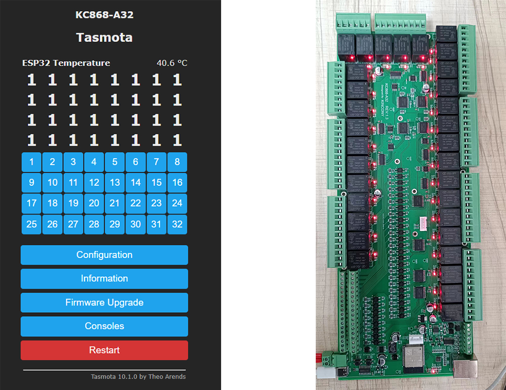

How to use tasmota for KC868-A32 via PCF8574 IIC extend GPIO
Rainbow
The Tamplate code is:
{"NAME":"KC868-A32","GPIO":[32,0,1120,0,641,609,0,0,0,608,1,640,0,0,5600,0,0,0,0,5568,0,0,0,0,0,0,0,0,1,1,0,0,1,0,0,1],"FLAG":0,"BASE":1}
Set all Device port to  "OUTPUT"

A32 support tasmota, but tasmota support input+output total=32 channel , such as you can use 32 channel for output, or 16 channel input and 16 channel output. just input ports + output ports <=MAX 32 channels.
