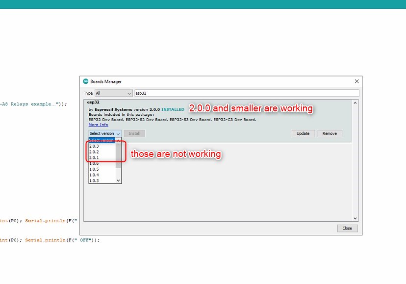

i am pretty new to ESP32 and programming with Arduion IDE. I have purchased a KC868-A8-V1.4 board and now i wanted to do the Realy programming according to the instruction from your site KC868-A8 programming

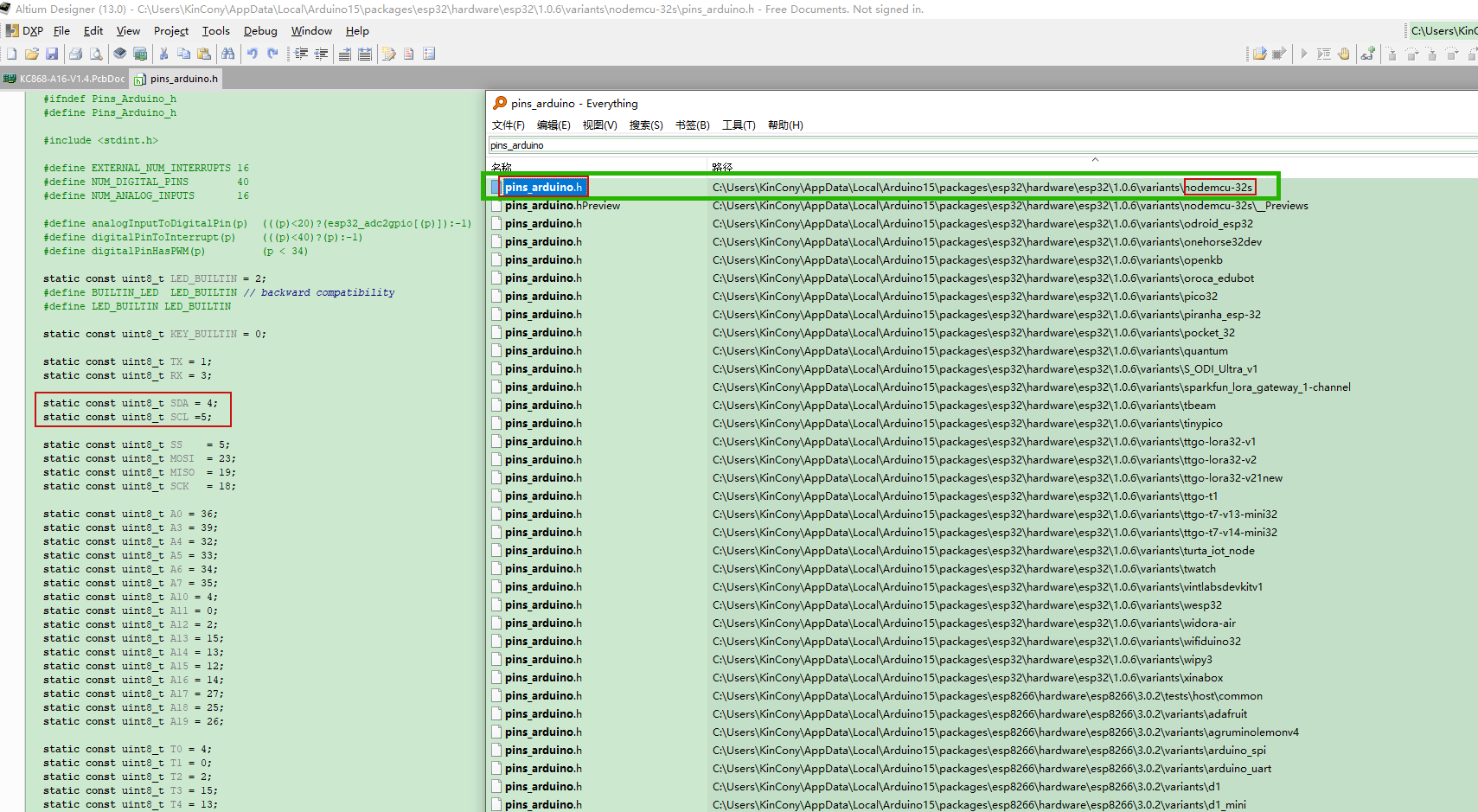

Correct type of board is selected NodeMCU-32S and the pins in pins_arduino.h are changed to 4 + 5, PCF8574 library V2.3.1 from Renzo Mischianti is installed.
The problem i am facing is that the PCF8574 throws all the time "error" instead of "OK" and therefore the relays are not working.
In order to test whether the board has a hardware problem, I have also tried once the TASMATO accoring to the video Tasmato KC868-A8, this has worked without any problems. So the hardware is ok.
Do you know what i am doing wrong that the PCF8574 throws the error?
Any help would be appreaciated
