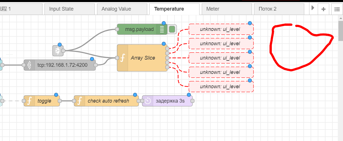

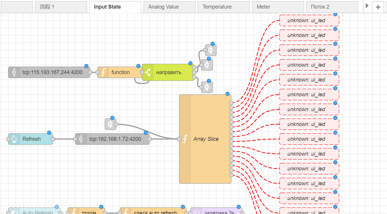

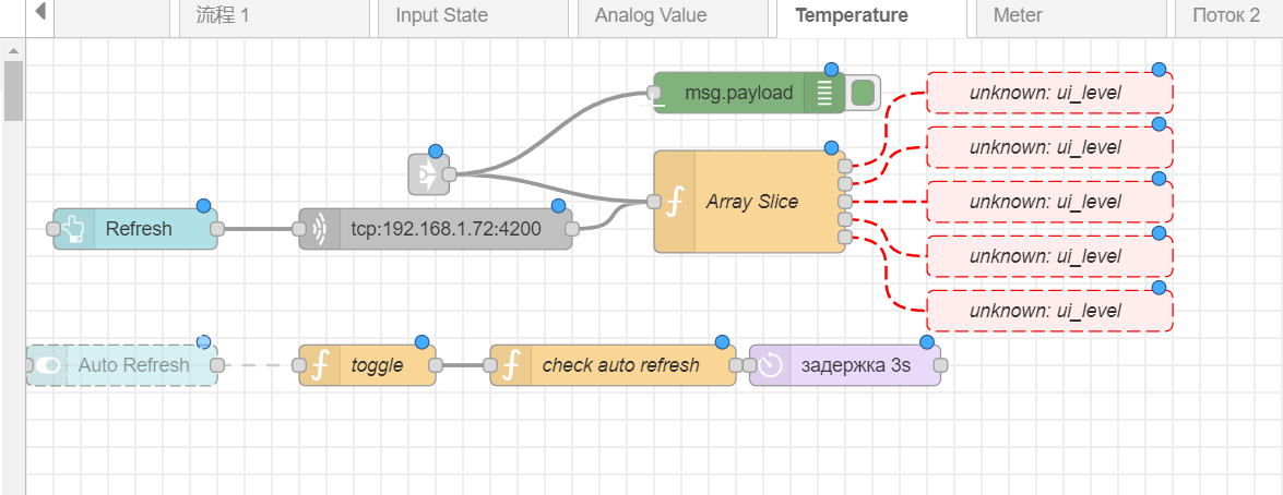

Hello! Have some problems with import NODe_RED-COL file to home assistant!IT doesnt undestand some types - type of digital sensor and temperature/ i can fix it by your youtube video but there isnt discription for LEVEL box after temperature sensor. can you explain what I shold type there. or export correct node red file for current Home Assistant! thanx

01-30-2021, 01:25 AM
before import flows , you need install these nodes for Node-Red:
1. node-red-contrib-ui-led 【LED UI】 2. node-red-contrib-ui-level 【Temperature】 3. node-red-dashboard 【dashboard UI】
01-30-2021, 06:15 AM
Thanx! now its imports well!
