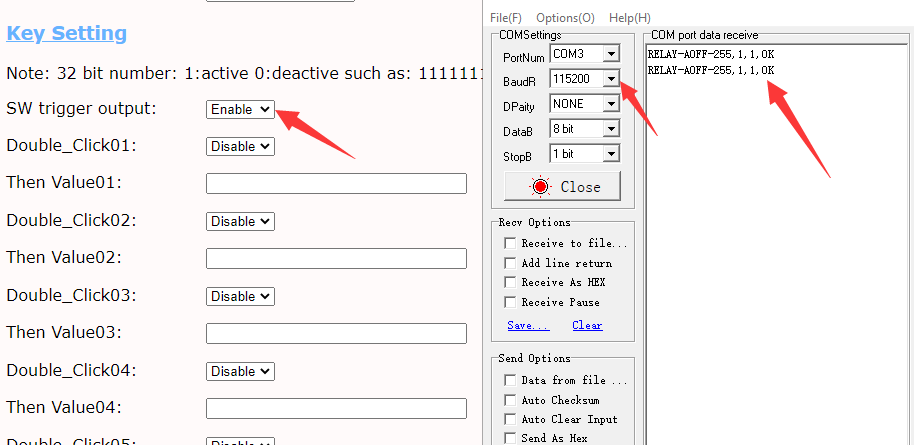

Posts: 62
Threads: 11
Joined: Apr 2022
Will controllers send status update if button was pressed via RS232?
Posts: 62
Threads: 11
Joined: Apr 2022
will it update if SW trigger output is disabled?
