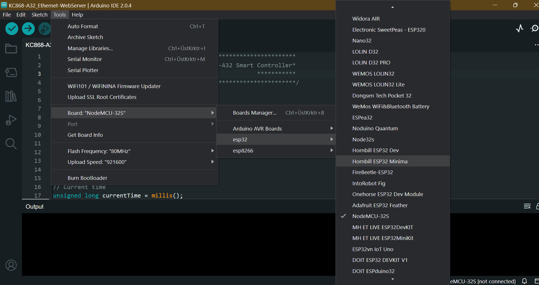

[Arduino IDE demo source code for KC868-A32]--#08-Ethernet_LAN_Web_server
this arduino source code is web server use for Ethernet via KC868-A32
digital input can trigger relay output. just connect with ethernet cable
.zip   KC868-A32_Web_Server - ETH.zip (Size: 478.62 KB / Downloads: 1,096)
* Create Your own Ethernet-WebServer for KC868-A32 Smart Controller*
* https://www.kincony.com                                ***********

Hello I tried to compile the code but getting an error. Could you help me, what I am doing wrong?
Error Message: Compilation error:
WebServer_WT32_ETH01.h: No such file or directory
Using board 'nodemcu-32s' from platform in folder: C:\Users\tugal\AppData\Local\Arduino15\packages\esp32\hardware\esp32\1.0.6
Using core 'esp32' from platform in folder: C:\Users\tugal\AppData\Local\Arduino15\packages\esp32\hardware\esp32\1.0.6
cmd /c if exist "C:\\me\\codes\\arduino\\KinCony\\KC868-A32_Web_Server - ETH\\KC868-A32_Ethernet-WebServer\\partitions.csv" copy /y "C:\\me\\codes\\arduino\\KinCony\\KC868-A32_Web_Server - ETH\\KC868-A32_Ethernet-WebServer\\partitions.csv" "C:\\Users\\tugal\\AppData\\Local\\Temp\\arduino\\sketches\\F9C5D244B8014A3484EB69CC2958BCC1\\partitions.csv"
cmd /c if not exist "C:\\Users\\tugal\\AppData\\Local\\Temp\\arduino\\sketches\\F9C5D244B8014A3484EB69CC2958BCC1\\partitions.csv" copy "C:\\Users\\tugal\\AppData\\Local\\Arduino15\\packages\\esp32\\hardware\\esp32\\1.0.6\\tools\\partitions\\default.csv" "C:\\Users\\tugal\\AppData\\Local\\Temp\\arduino\\sketches\\F9C5D244B8014A3484EB69CC2958BCC1\\partitions.csv"
Detecting libraries used...
"C:\\Users\\tugal\\AppData\\Local\\Arduino15\\packages\\esp32\\tools\\xtensa-esp32-elf-gcc\\1.22.0-97-gc752ad5-5.2.0/bin/xtensa-esp32-elf-g++" -DESP_PLATFORM "-DMBEDTLS_CONFIG_FILE=\"mbedtls/esp_config.h\"" -DHAVE_CONFIG_H -DGCC_NOT_5_2_0=0 -DWITH_POSIX "-IC:\\Users\\tugal\\AppData\\Local\\Arduino15\\packages\\esp32\\hardware\\esp32\\1.0.6/tools/sdk/include/config" "-IC:\\Users\\tugal\\AppData\\Local\\Arduino15\\packages\\esp32\\hardware\\esp32\\1.0.6/tools/sdk/include/app_trace" "-
IC:\\Users\\tugal\\AppData\\Local\\Arduino15\\packages\\esp32\\hardware\\esp32\\1.0.6/tools/sdk/include/fb_gfx" -std=gnu++11 -Os -g3 -Wpointer-arith -fexceptions -fstack-protector -ffunction-sections -fdata-sections -fstrict-volatile-bitfields -mlongcalls -nostdlib -w -Wno-error=maybe-uninitialized -Wno-error=unused-function -Wno-error=unused-but-set-variable -Wno-error=unused-variable -Wno-error=deprecated-declarations -Wno-unused-parameter -Wno-unused-but-set-parameter -Wno-missing-field-initializers -Wno-sign-compare -fno-rtti -c -w -x c++ -E -CC -DF_CPU=240000000L -DARDUINO=10607 -DARDUINO_NodeMCU_32S -DARDUINO_ARCH_ESP32 "-DARDUINO_BOARD=\"NodeMCU_32S\"" "-DARDUINO_VARIANT=\"nodemcu-32s\"" -DESP32 -DCORE_DEBUG_LEVEL=0 "-IC:\\Users\\tugal\\AppData\\Local\\Arduino15\\packages\\esp32\\hardware\\esp32\\1.0.6\\cores\\esp32" "-IC:\\Users\\tugal\\AppData\\Local\\Arduino15\\packages\\esp32\\hardware\\esp32\\1.0.6\\variants\\nodemcu-32s" "C:\\Users\\tugal\\AppData\\Local\\Temp\\arduino\\sketches\\F9C5D244B8014A3484EB69CC2958BCC1\\sketch\\KC868-A32_Ethernet-WebServer.ino.cpp" -o nul
Alternatives for PCF8574.h: [PCF8574 library@2.3.5]
ResolveLibrary(PCF8574.h)
  -> candidates: [PCF8574 library@2.3.5]
IC:\\Users\\tugal\\AppData\\Local\\Arduino15\\packages\\esp32\\hardware\\esp32\\1.0.6/tools/sdk/include/fb_gfx" -std=gnu++11 -Os -g3 -Wpointer-arith -fexceptions -fstack-protector -ffunction-sections -fdata-sections -fstrict-volatile-bitfields -mlongcalls -nostdlib -w -Wno-error=maybe-uninitialized -Wno-error=unused-function -Wno-error=unused-but-set-variable -Wno-error=unused-variable -Wno-error=deprecated-declarations -Wno-unused-parameter -Wno-unused-but-set-parameter -Wno-missing-field-initializers -Wno-sign-compare -fno-rtti -c -w -x c++ -E -CC -DF_CPU=240000000L -DARDUINO=10607 -DARDUINO_NodeMCU_32S -DARDUINO_ARCH_ESP32 "-DARDUINO_BOARD=\"NodeMCU_32S\"" "-DARDUINO_VARIANT=\"nodemcu-32s\"" -DESP32 -DCORE_DEBUG_LEVEL=0 "-IC:\\Users\\tugal\\AppData\\Local\\Arduino15\\packages\\esp32\\hardware\\esp32\\1.0.6\\cores\\esp32" "-IC:\\Users\\tugal\\AppData\\Local\\Arduino15\\packages\\esp32\\hardware\\esp32\\1.0.6\\variants\\nodemcu-32s" "-Ic:\\me\\docs\\Arduino\\libraries\\PCF8574_library" "C:\\Users\\tugal\\AppData\\Local\\Temp\\arduino\\sketches\\F9C5D244B8014A3484EB69CC2958BCC1\\sketch\\KC868-A32_Ethernet-WebServer.ino.cpp" -o nul
Alternatives for Wire.h: [Wire@1.0.1]
ResolveLibrary(Wire.h)
  -> candidates: [Wire@1.0.1]
IC:\\Users\\tugal\\AppData\\Local\\Arduino15\\packages\\esp32\\hardware\\esp32\\1.0.6/tools/sdk/include/fb_gfx" -std=gnu++11 -Os -g3 -Wpointer-arith -fexceptions -fstack-protector -ffunction-sections -fdata-sections -fstrict-volatile-bitfields -mlongcalls -nostdlib -w -Wno-error=maybe-uninitialized -Wno-error=unused-function -Wno-error=unused-but-set-variable -Wno-error=unused-variable -Wno-error=deprecated-declarations -Wno-unused-parameter -Wno-unused-but-set-parameter -Wno-missing-field-initializers -Wno-sign-compare -fno-rtti -c -w -x c++ -E -CC -DF_CPU=240000000L -DARDUINO=10607 -DARDUINO_NodeMCU_32S -DARDUINO_ARCH_ESP32 "-DARDUINO_BOARD=\"NodeMCU_32S\"" "-DARDUINO_VARIANT=\"nodemcu-32s\"" -DESP32 -DCORE_DEBUG_LEVEL=0 "-IC:\\Users\\tugal\\AppData\\Local\\Arduino15\\packages\\esp32\\hardware\\esp32\\1.0.6\\cores\\esp32" "-IC:\\Users\\tugal\\AppData\\Local\\Arduino15\\packages\\esp32\\hardware\\esp32\\1.0.6\\variants\\nodemcu-32s" "-Ic:\\me\\docs\\Arduino\\libraries\\PCF8574_library" "-IC:\\Users\\tugal\\AppData\\Local\\Arduino15\\packages\\esp32\\hardware\\esp32\\1.0.6\\libraries\\Wire\\src" "C:\\Users\\tugal\\AppData\\Local\\Temp\\arduino\\sketches\\F9C5D244B8014A3484EB69CC2958BCC1\\sketch\\KC868-A32_Ethernet-WebServer.ino.cpp" -o nul
Alternatives for WebServer_WT32_ETH01.h: []
ResolveLibrary(WebServer_WT32_ETH01.h)
  -> candidates: []
C:\me\codes\arduino\KinCony\KC868-A32_Web_Server - ETH\KC868-A32_Ethernet-WebServer\KC868-A32_Ethernet-WebServer.ino:12:34: fatal error: WebServer_WT32_ETH01.h: No such file or directory
compilation terminated.
Using library PCF8574 library at version 2.3.5 in folder: C:\me\docs\Arduino\libraries\PCF8574_library
Using library Wire at version 1.0.1 in folder: C:\Users\tugal\AppData\Local\Arduino15\packages\esp32\hardware\esp32\1.0.6\libraries\Wire
exit status 1
Compilation error: WebServer_WT32_ETH01.h: No such file or directory
maybe you have not chosed correct "board" in arduino IDE. need use board -- "NodeMcu-32S"
(03-03-2023, 09:04 AM)admin Wrote: maybe you have not chosed correct "board" in arduino IDE. need use board -- "NodeMcu-32S"
I did actually. But I have never plugged the board phsically or bind the COM yet.
do you have use ESP32 board v2.0? i think you can try to use ESP32 board V1.0.6 for a test.
(03-03-2023, 09:54 AM)admin Wrote: do you have use ESP32 board v2.0? i think you can try to use ESP32 board V1.0.6 for a test.
No actually.
I am just a java programmer, I do not have many inventory.
Although I have EEE diploma, I am just good with screw driver trainning Confused
That is why, I really want to use this board.
But i feel think the fix is, somehow written here.  Idea
I just have to do a controlled experiment with copying files and such.
https://github.com/khoih-prog/WebServer_WT32_ETH01
my means: do you have installed "ESP32 v2.0 board" in arduino IDE.
not error "WebServer_WT32_ETH01.h: No such file or directory" , is wrong of your arudino environment.
(03-03-2023, 10:33 AM)admin Wrote: my means: do you have installed "ESP32 v2.0 board" in arduino IDE.
For the product: KinCony KC868-A32 Rev:1.2
With arduino: 2.0.4
With the custom libraries below:
CF8574_library.zip
WebServer_WT32_ETH01 (click Code button, and download zip)
When I open up the arduino, It wants to update the custom libraries. I Updated
Then I restarted the Arduino.
Then, I could able to compile the project with below warnings:
In file included from C:\me\codes\arduino\KinCony\KC868-A32_Web_Server - ETH\KC868-A32_Ethernet-WebServer\KC868-A32_Ethernet-WebServer.ino:14:0:
c:\me\codes\arduino\libraries\WebServer_WT32_ETH01-main\src/WebServer_WT32_ETH01.h:47:6: warning: #warning Using code for ESP32 core v1.0.6- in WebServer_WT32_ETH01.h [-Wcpp]
c:\me\codes\arduino\libraries\WebServer_WT32_ETH01-main\src/WebServer_WT32_ETH01.h:60:4: warning: #warning Using ESP32 architecture for WebServer_WT32_ETH01 [-Wcpp]
can you test with arduino IDE 1.8.19. i am tested with this version.
(03-06-2023, 10:29 AM)admin Wrote: can you test with arduino IDE 1.8.19. i am tested with this version.
I installed IDE 1.8.19, and compile. As you have mentioned, there was no compile warning.
Then i looked at prefrences, Compiler warnings are set to none.
If I change it to Default manually, you can see the warnings.
I think, warnings are not important enough that, IDE 1.8.19 comes with CompilerWarning set to None.
Hence, it can compile, ok.
