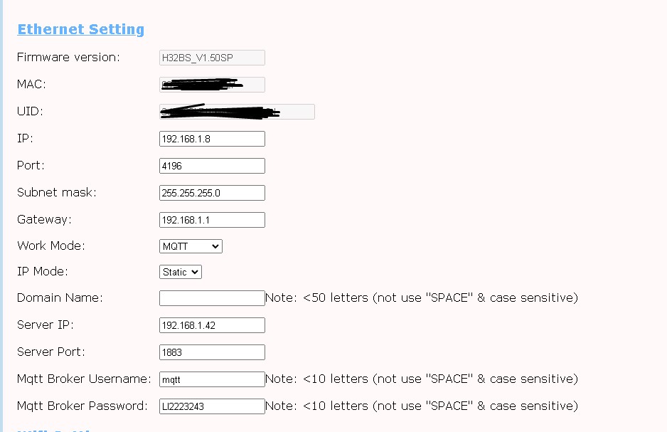

i used mqtt in homassistant to control H32BS but  after update firmware  for H32BS  I noted homeassistant not response feedba  in spite of work H32BS
i used Home Assistant 2022.12.7

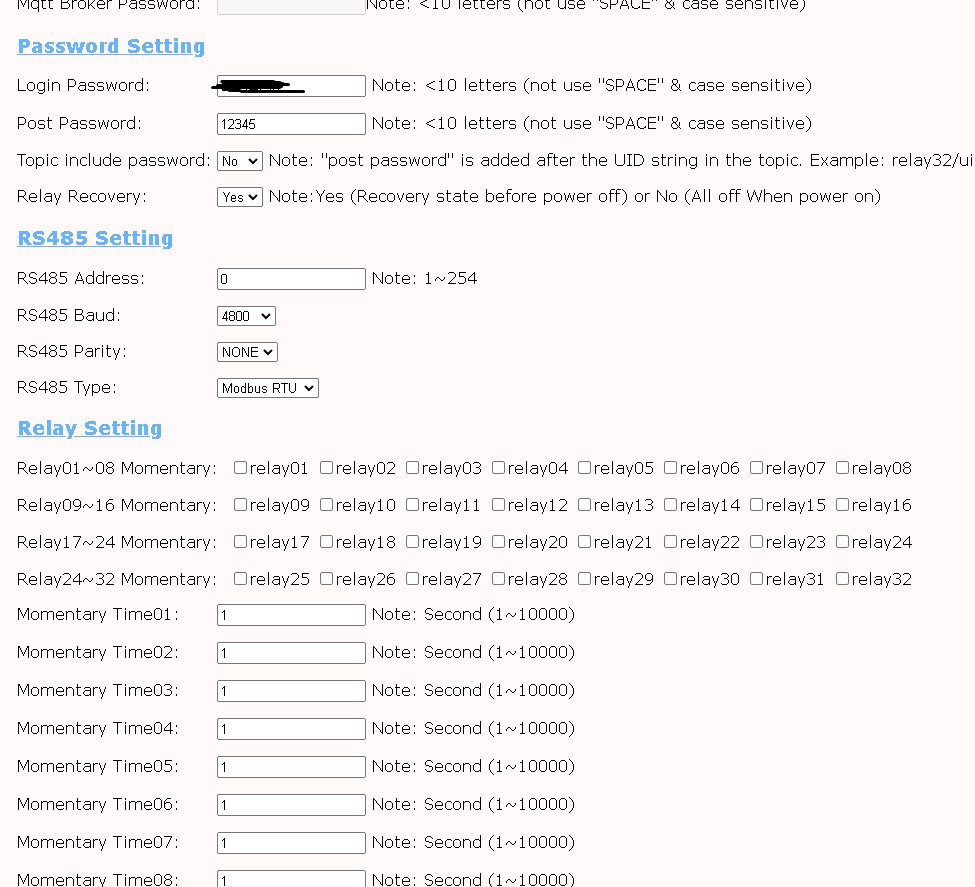

photo of configration

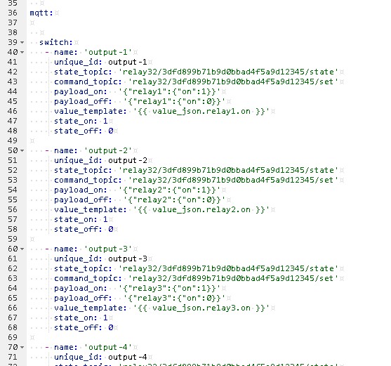

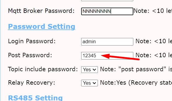

we have checked, no problem, new home assistant MQTT syntax is updated. here is sample config file:
https://www.kincony.com/kc868-h32b-integ...-mqtt.html
I updated my configuration file as shown in the attachment
But it didn't work
Please use AnyDisk to help me
SAMPLE:
mqtt:
  broker: 192.168.1.42
  port: 1883
  username: mqtt
  password: NNNNNNNN
  - name: 'switch-1'
    unique_id: switch-1
    state_topic: 'relay32/XXXXXXXXXXXXXXXX/state'
    command_topic: 'relay32/XXXXXXXXXXXXXXXX/set'
    payload_on:  '{"relay1":{"on":1}}'
    payload_off:  '{"relay1":{"on":0}}'
    state_on: 1
    state_off: 0
.txt   NEW MQTT - Copy.txt (Size: 11.66 KB / Downloads: 552)
see HA log, what information have showed.
