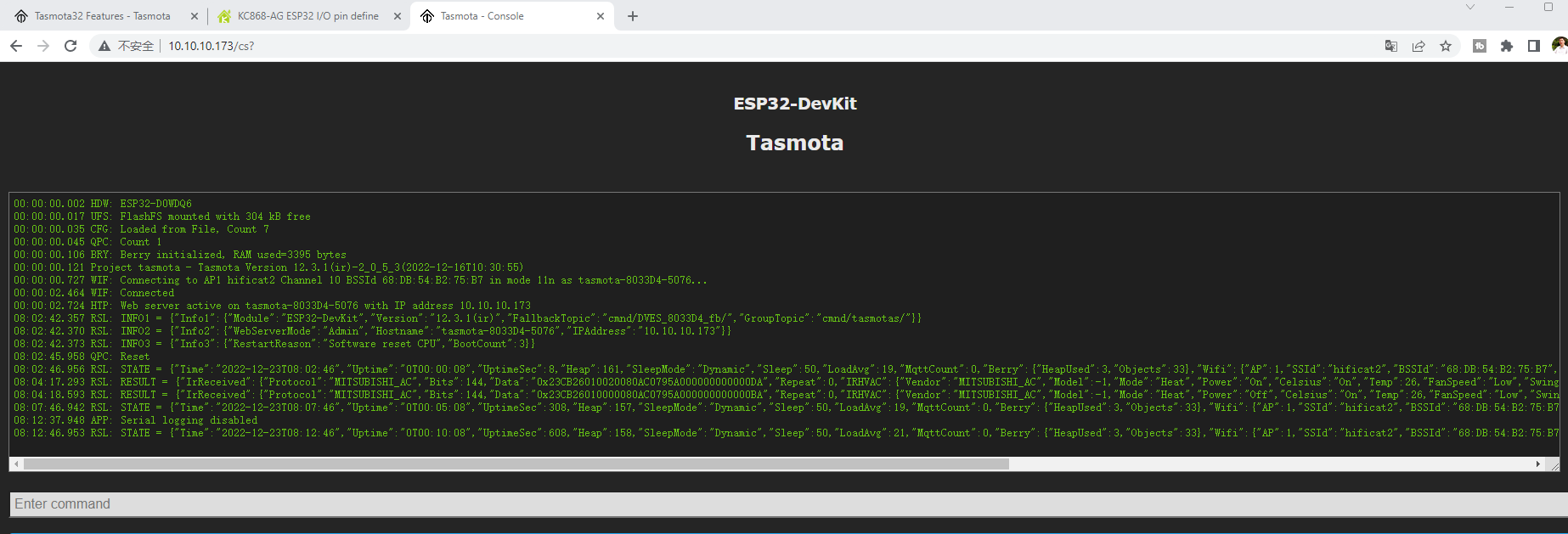

after that i have no idea how to read te code of a ir remote control of mine.
when i go to console I can see only this :
image 03 - tasmota console
Is there a way to read the remote control IR signal through the console?

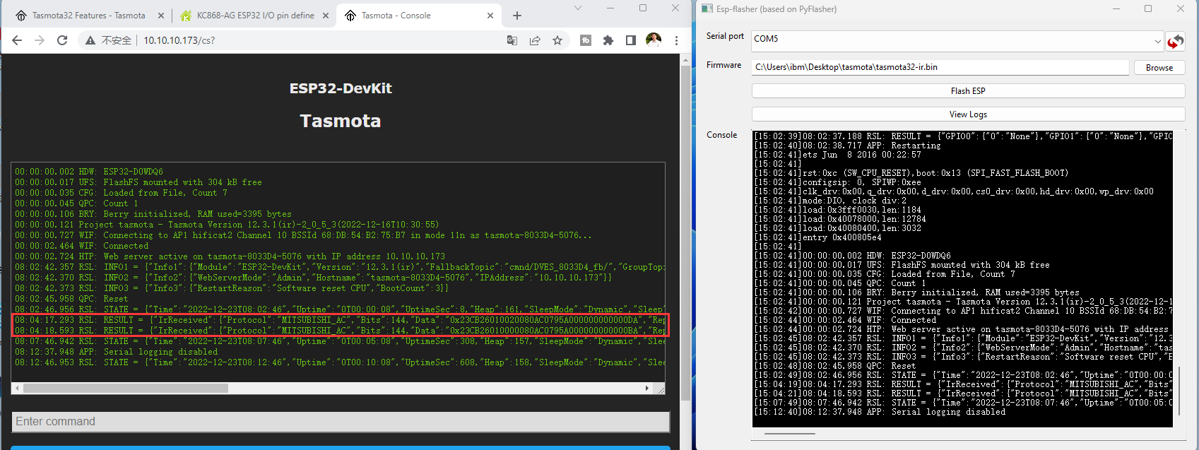

hello, i have downloaded this tasmota firmware to KC868-AG. when use Mitsubishi air conditioner remoter, you can see that is feedback IR message.
.zip   tasmota32-ir.zip (Size: 854.45 KB / Downloads: 828)
