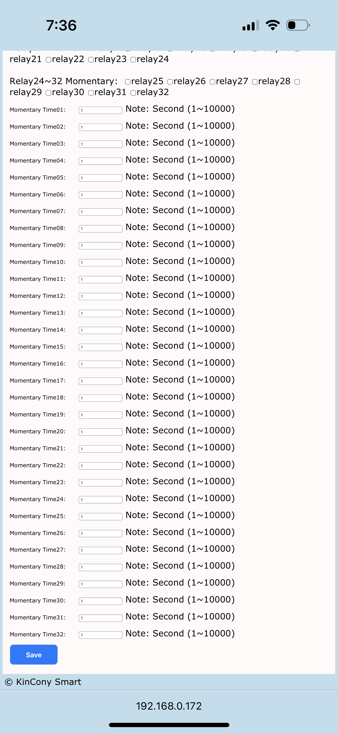

no, not to use "KCS", can you take a screen photo of your AK's setting and H32B Pro's setting.
#13
Please find attached screenshots for both H32B pro and KC868-AK
#14

Thanks for your support over WhatsApp, it works now after a firmware upgrade
