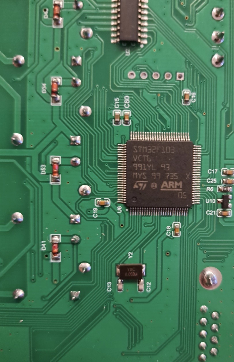

for example, your KC868-COLB CPU chip is AT32F403AVGT7.

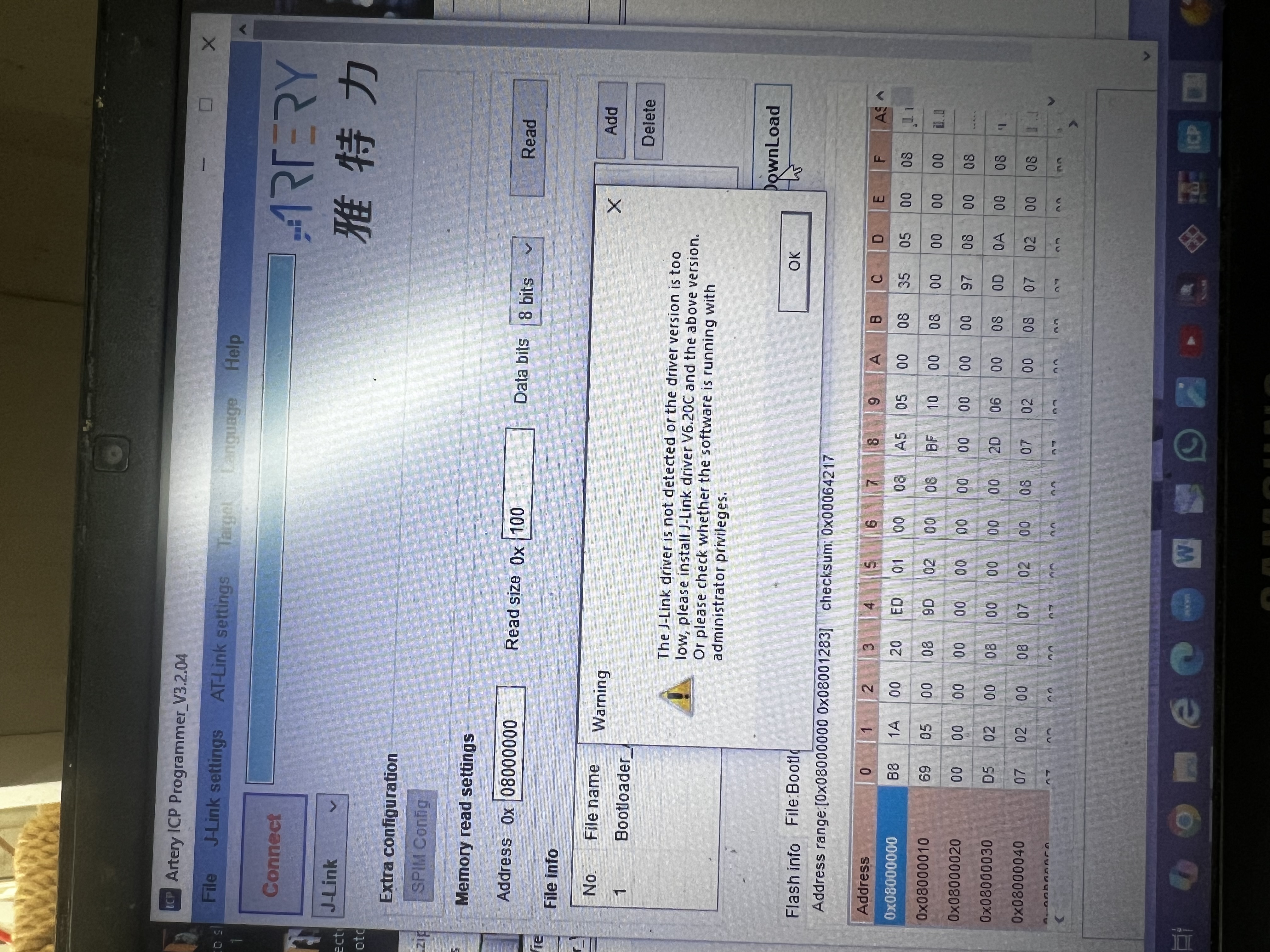

so download AT-link tool for flash BOOTLOADER.
Artery_ICP_Programmer_V3.0.07.zip (Size: 14.28 MB / Downloads: 963)

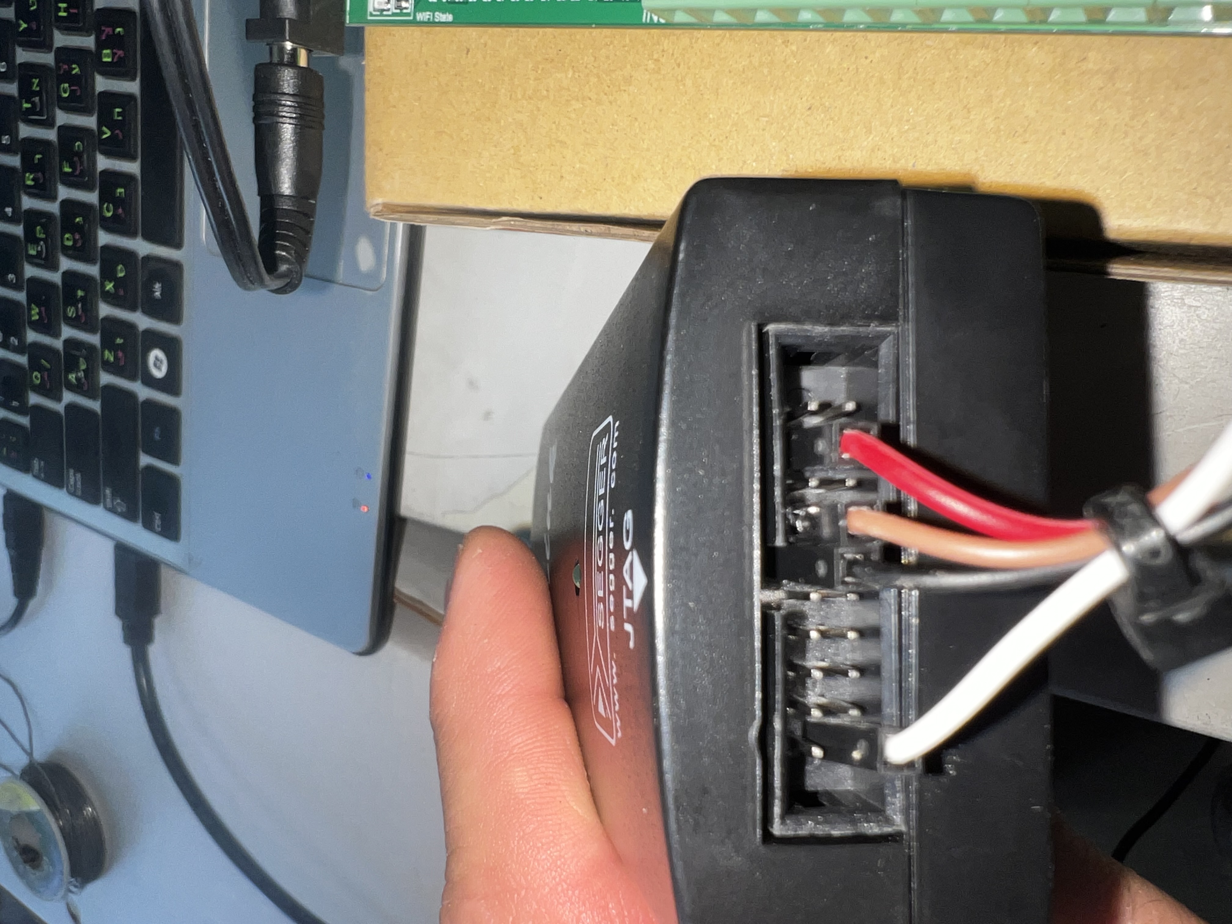

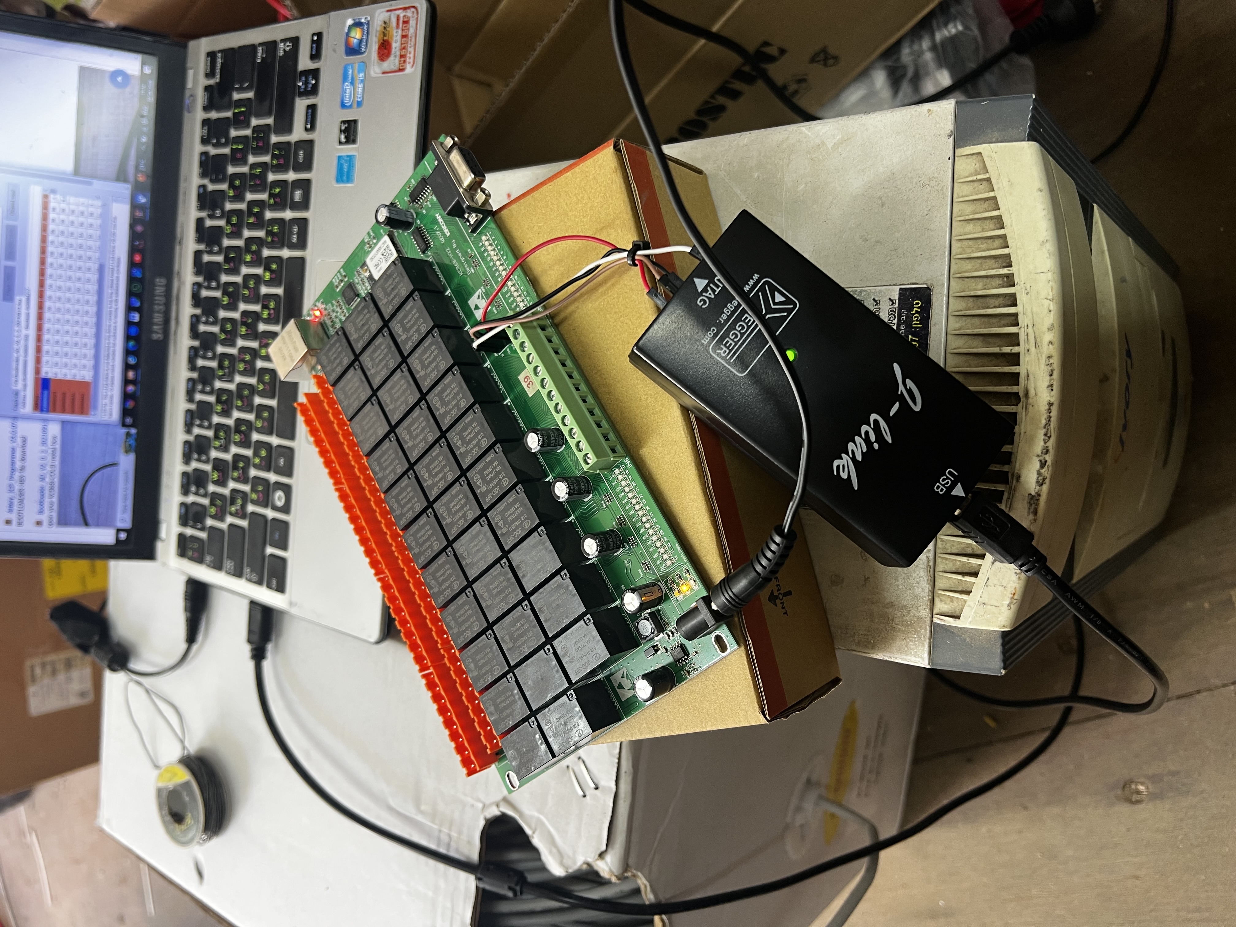

open your KC868-COLB metal box
installed jlink computer driver and ready to use it.

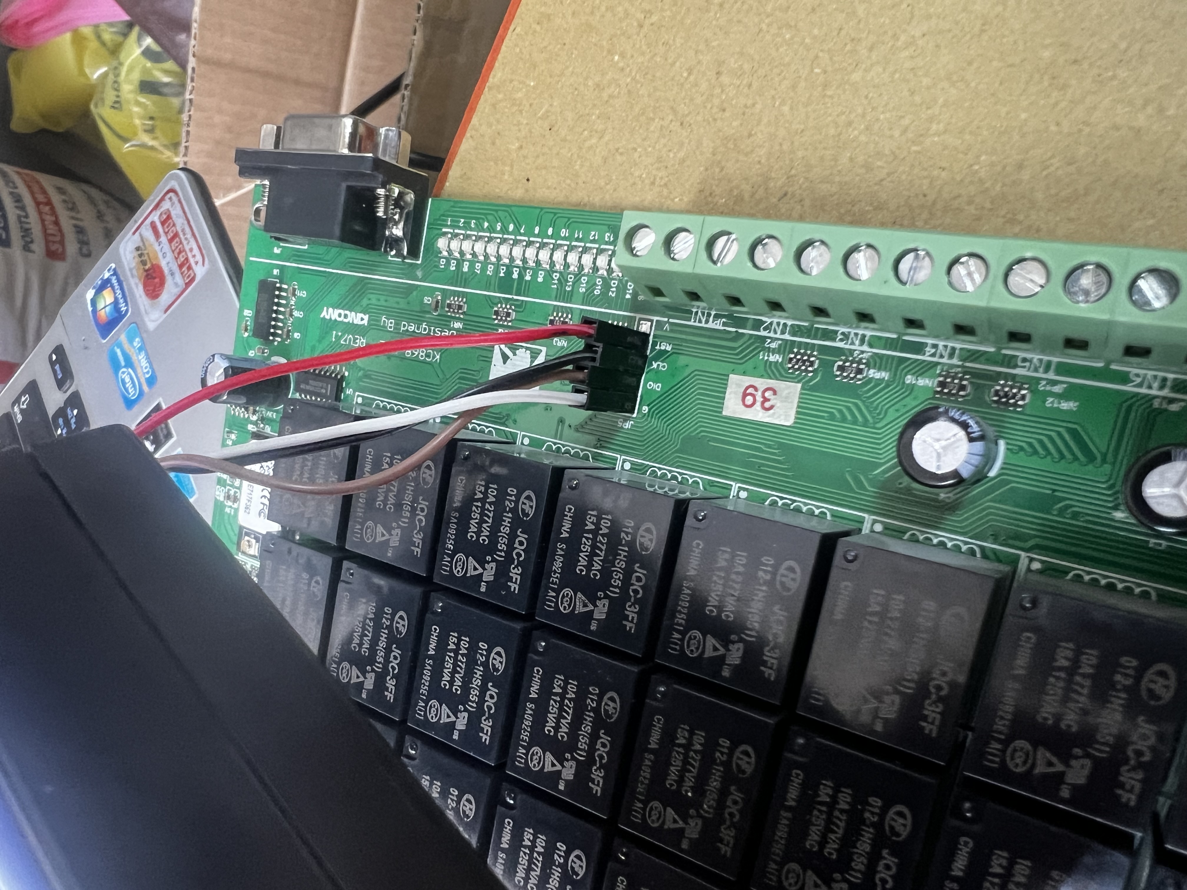

here is pin define , connect jlink to your KC868-COLB PCB's download interface
begin download BOOTLOADER HEX file , just do as follow images:
