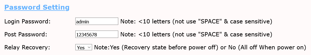

However, this version has some bug. Password settings are not working. You can enter any password, save it, but logging into "Web KINCONY" is still done using the standard "admin" password ...
the photo you have set login password for "admin". user name is fixed by "admin". so if you want set login password is 12345678. you should input with "Login Password" option.
second line "Post Password" means http command string password, that's for software engineer use.
Thank you for your response. My mistake Blush
