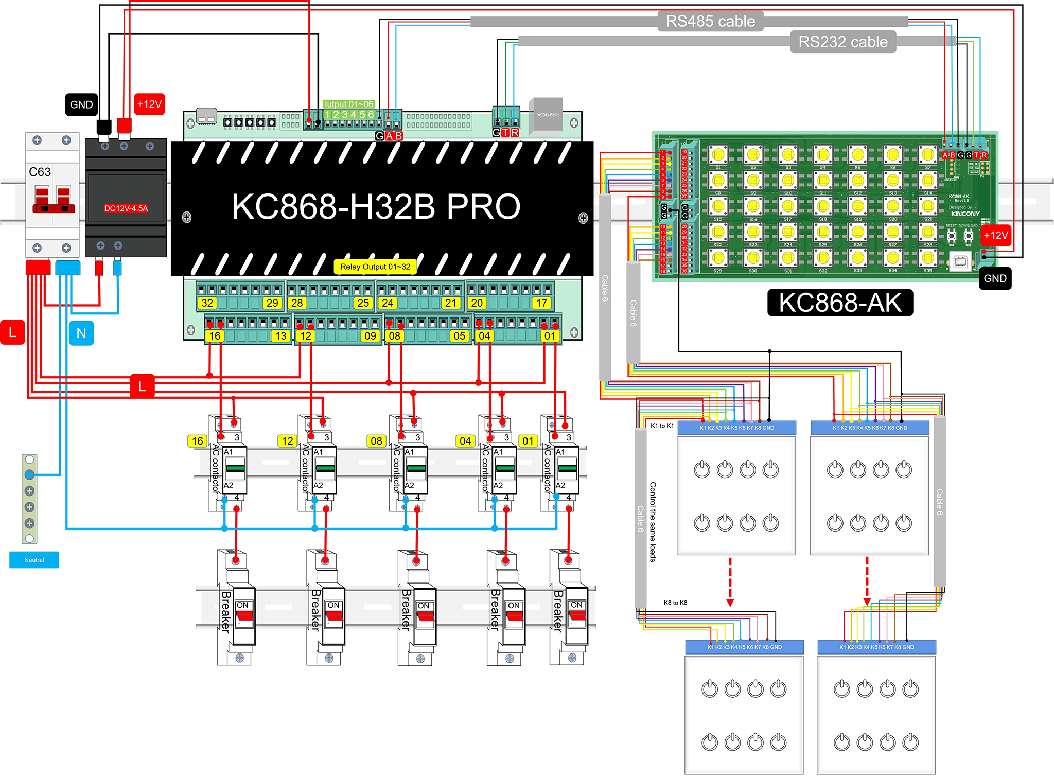

(10-17-2023, 11:33 AM)Nikhil Wrote: (09-30-2023, 11:28 PM)admin Wrote: if you want use use KC868-AK work with KC868-H32BS, need config AK board firstly, here is details:
https://www.kincony.com/how-to-use-kc868...board.html

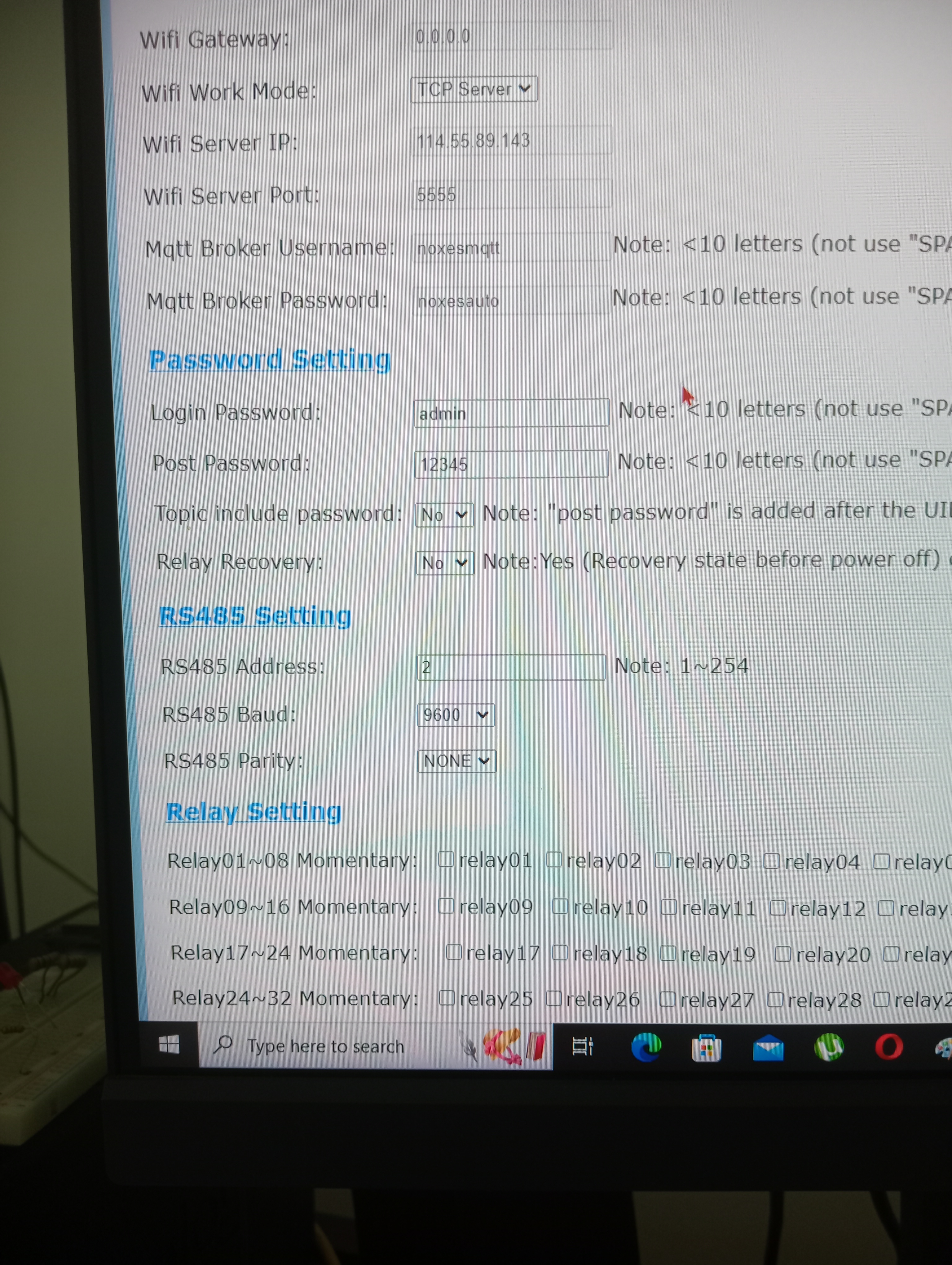

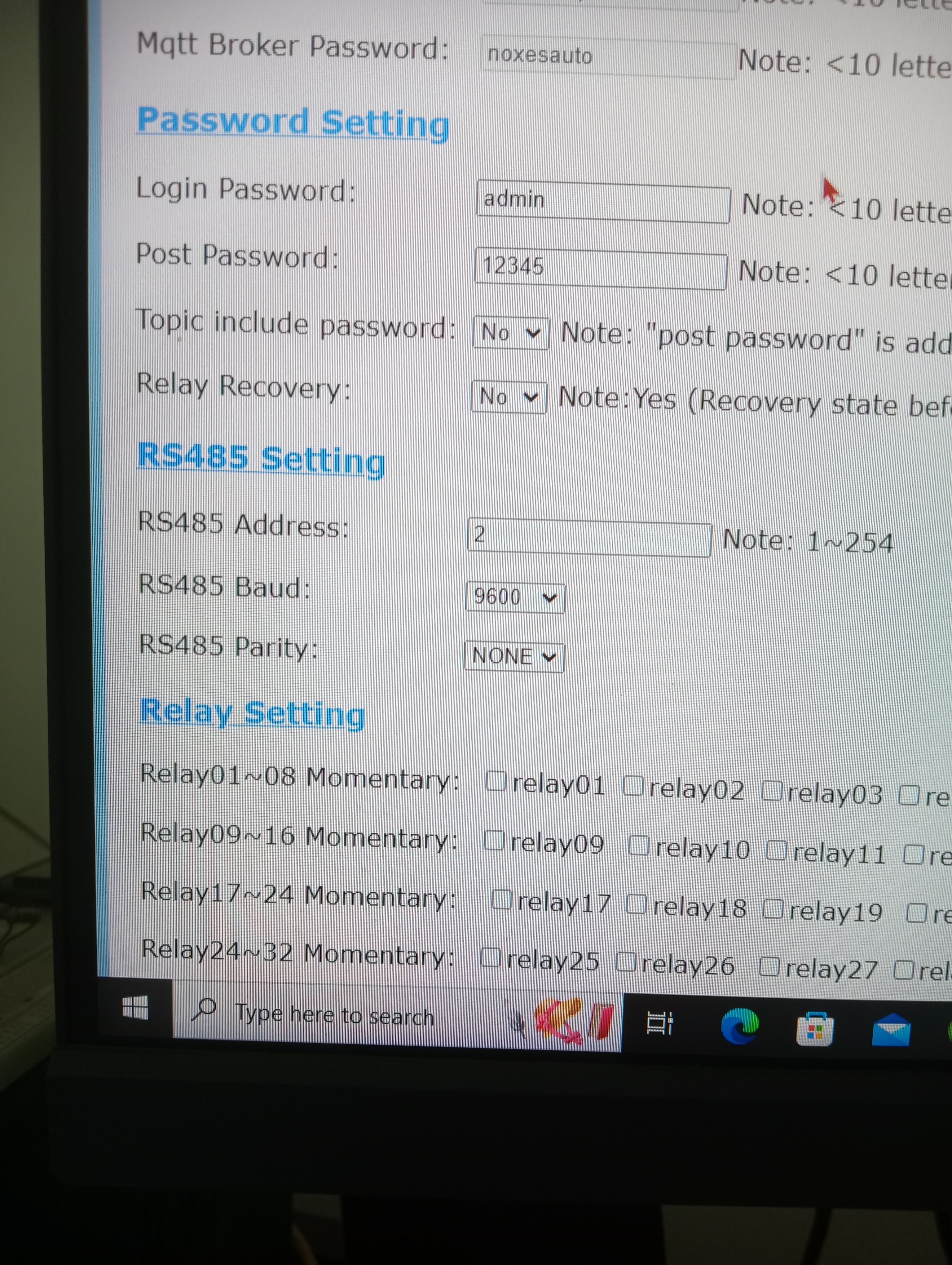

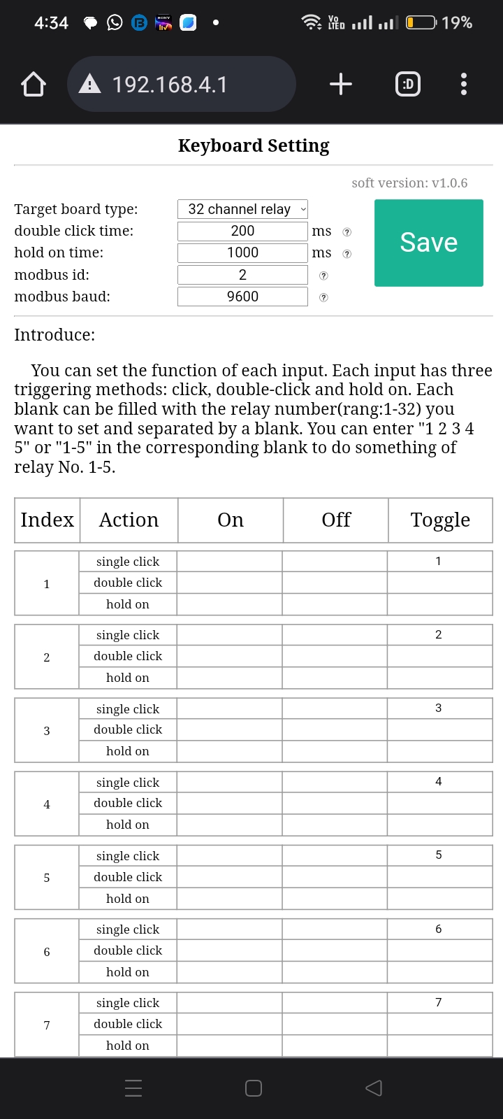

I am attaching configuration pics for h32bs and 868ak
Show me your connections about KC868-AK and KC868-H32BS.I want to make sure the connection is OK.
