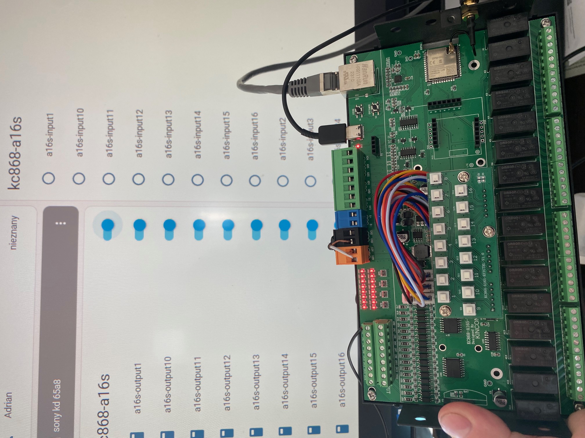

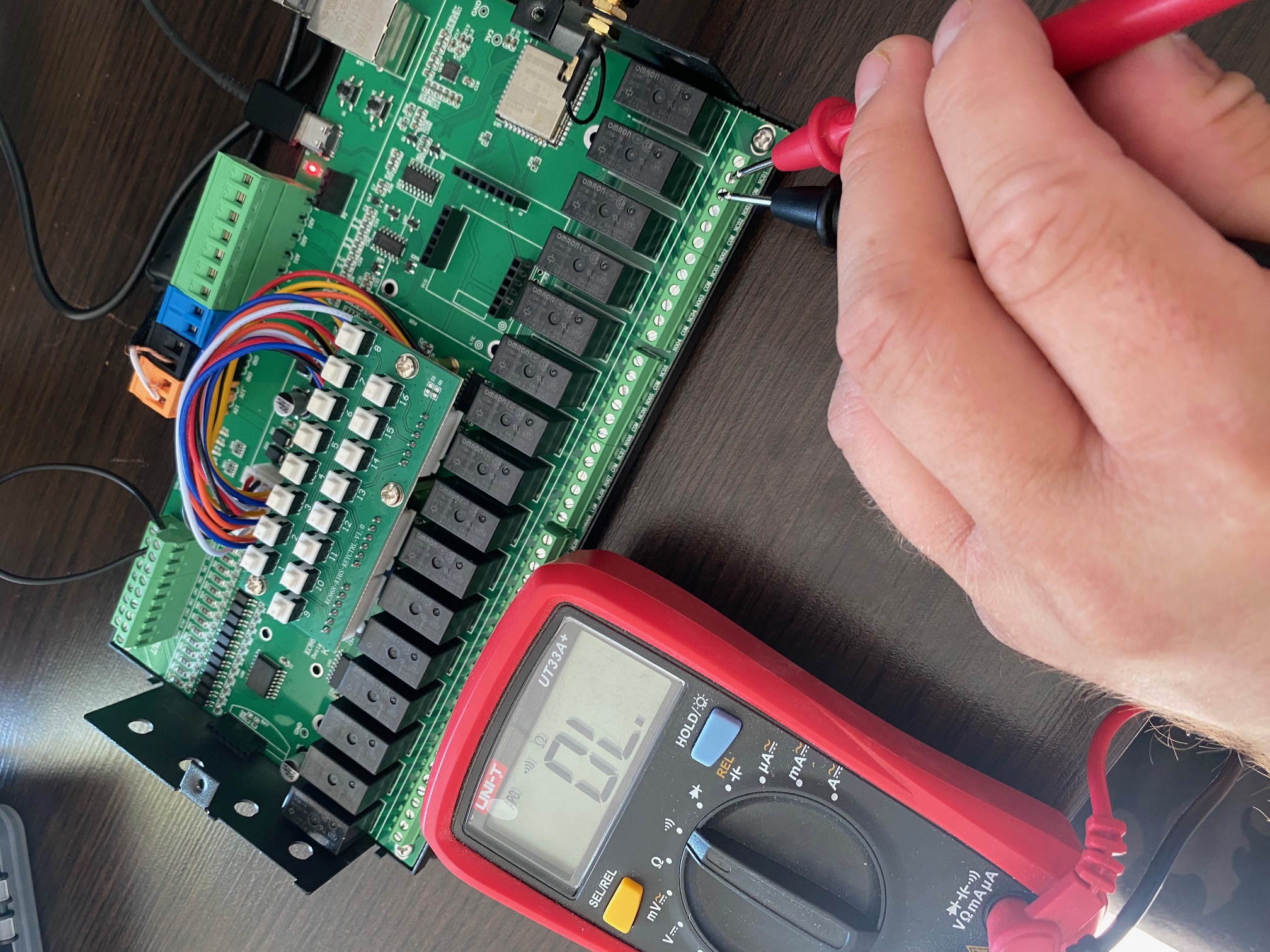

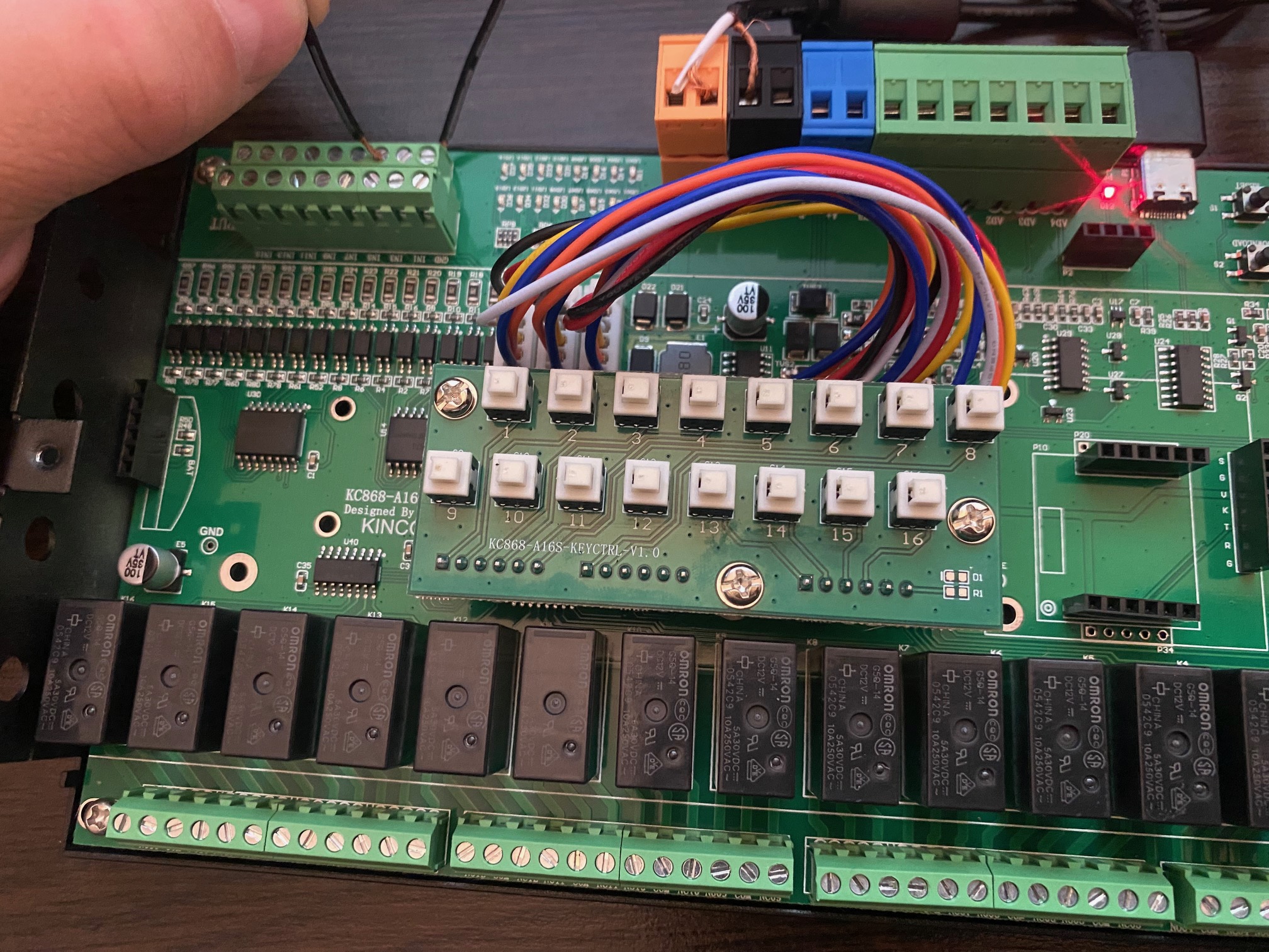

do you means: relay work well , only INPUT not work?

if you want INPUT trigger OUTPUT, need config in yaml file. such as:
binary_sensor:
- platform: gpio
on_press:
then:
- switch.toggle: light1
pin:
pcf8574: pcf8574_hub_in_1
number: 0
mode: INPUT
inverted: true

Thank you for your help. I changed the code using the on_multi_cilck command, (I read another topic on the forum)
