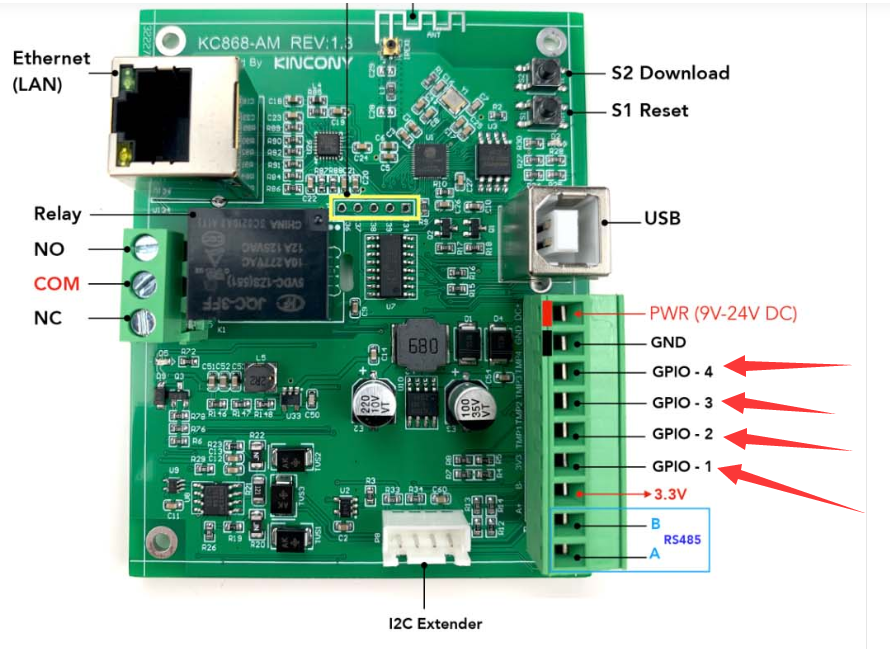

I want to make KC868-AM to be able to receive requests to activate build in Relay (15) (for alarm siren) and all other GPIO pins (5, 13, 14, 33, 36, 37, 38, 39, 34) act as an input (for basic alarm system magnetic NO switch and motion sensors).

I successfully flashed KCS v2.1.1 firmware BIN file and connected to the device, but I cant access free GPIO's and in IFTTT dont have an option to set up digital or analog conditions - only time or temperature.
Maybe I am doing something wrong?
yes, because KC868-AM interface for user only 4GPIOs, that's for sensor use.
Perhaps you could also consider ESPHome as firmware for the KC868-AM. That would integrate well with HomeAssistant, either over MQTT or over the Homeassistant API protocol.
