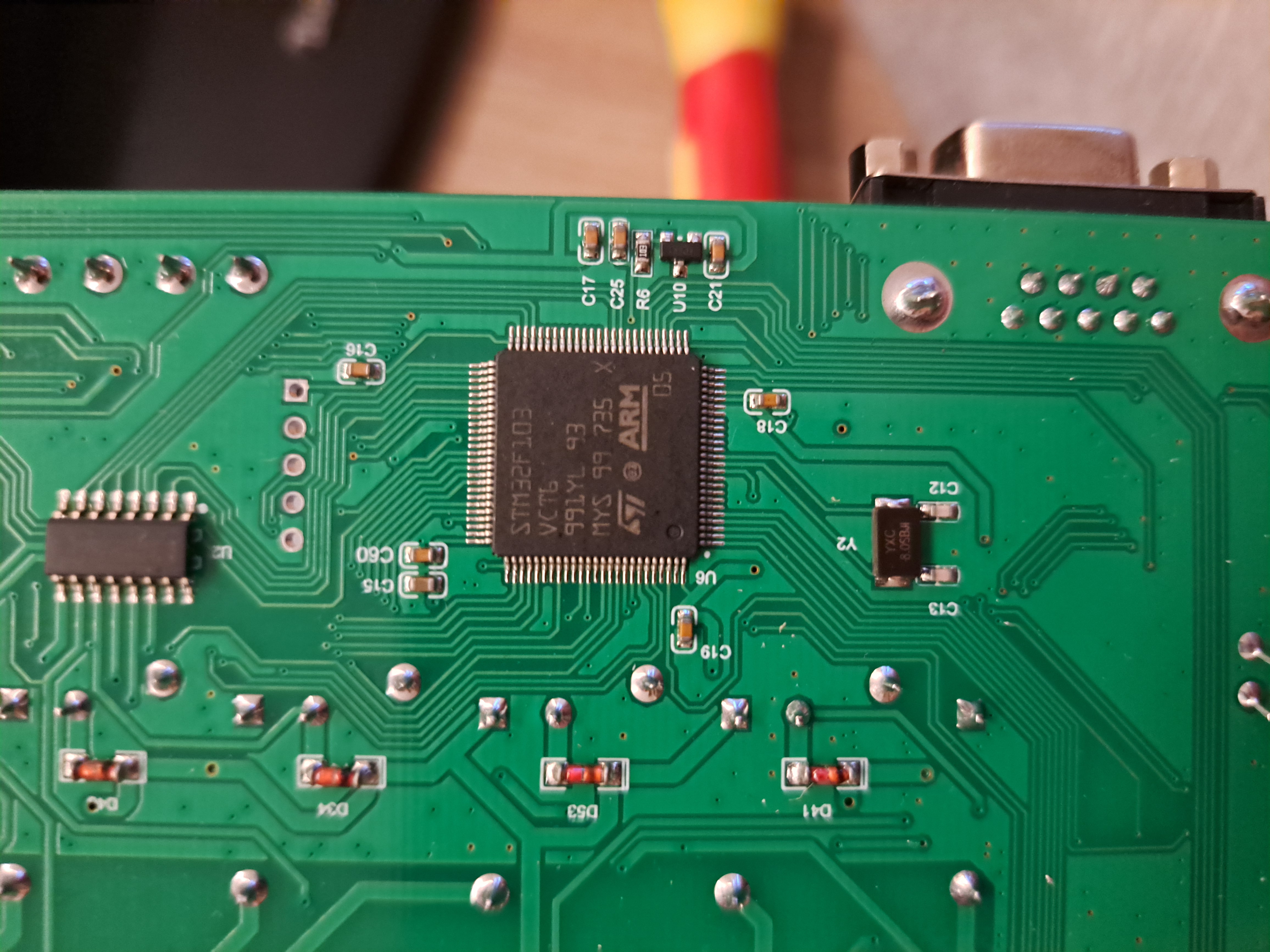

make sure your KC868-H32B CPU chip is AT32F403AVGT7.
if your board CPU is STM32F103VCT6 or GD32F103VCT6, there is no enough memory for new firmware update, they memory is 256K. new firmware is >300k, so can't use it.
How can I find out what my CPU is? because I updated and it doesn't work at all my H32B
take photo of your PCB chip, the biggest chip.
STM32F103
VCT6
991YL 93
MYS99735
STM32F103VCT6 support MAX firmware 128K size, so you need download a older firmware , file <128K.
