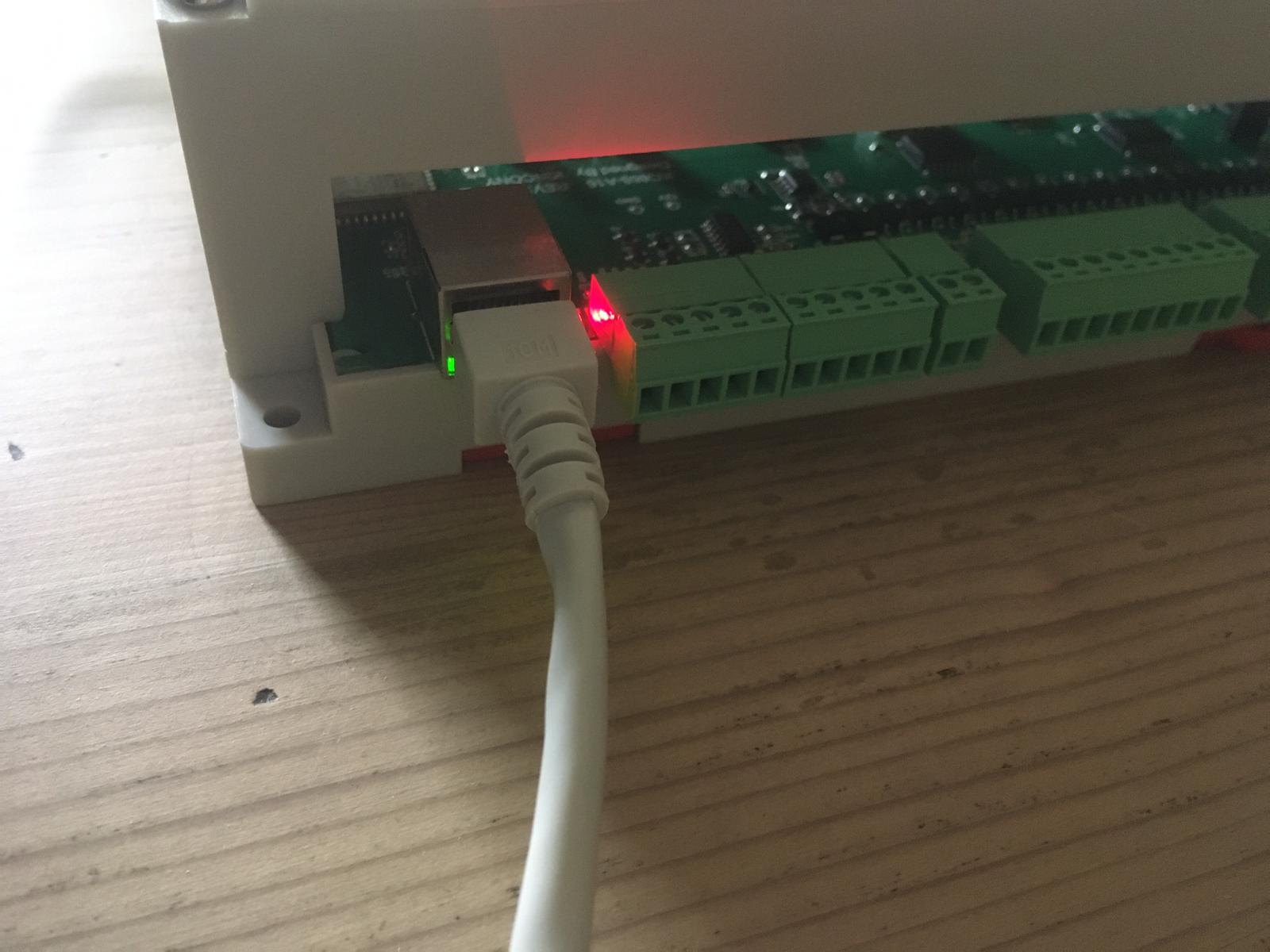

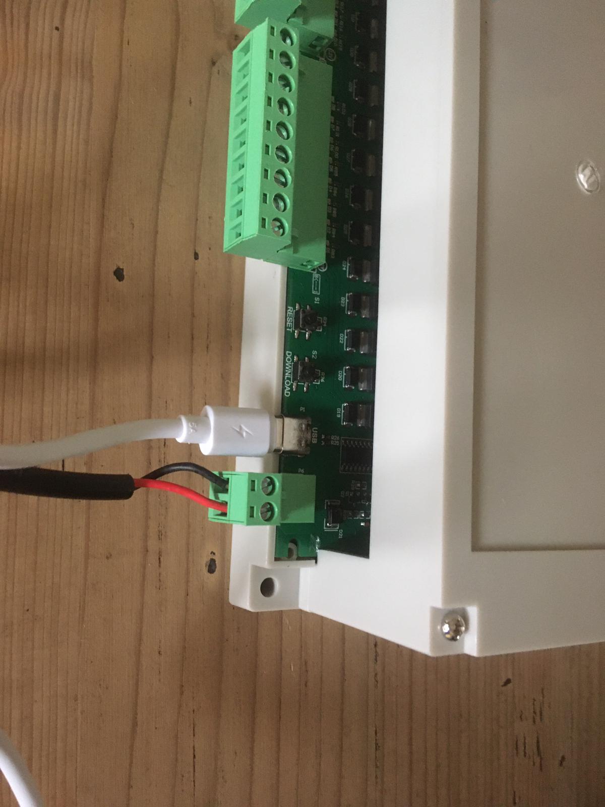

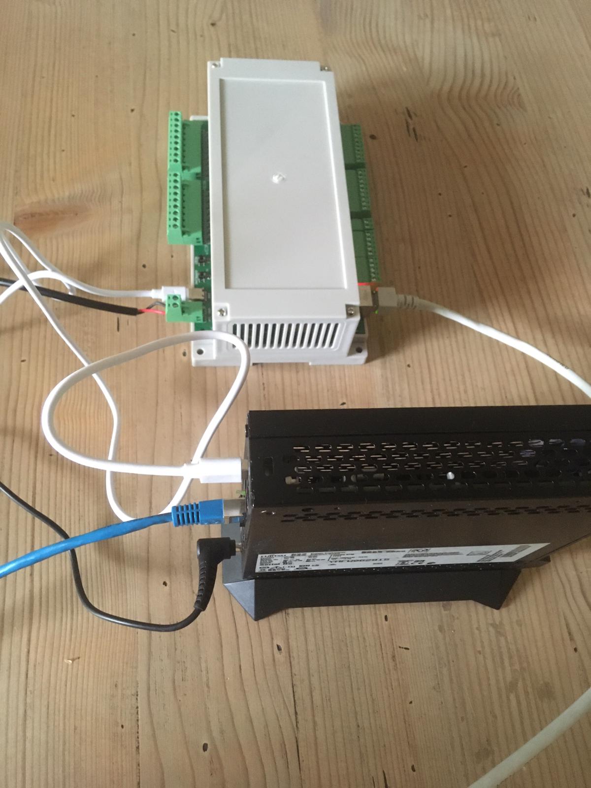

take a photo how you wire your board.
Hello, I have attached a few photos of how I connected the board. However, I haven't done any further wiring yet because I wanted to finish the firmware and the setup in Home Assistant first. I hope you can do something with the pictures and can help me.
Thanks
Moritz
what's BLACK device? router? or server?
The black device is the Home Assistant server

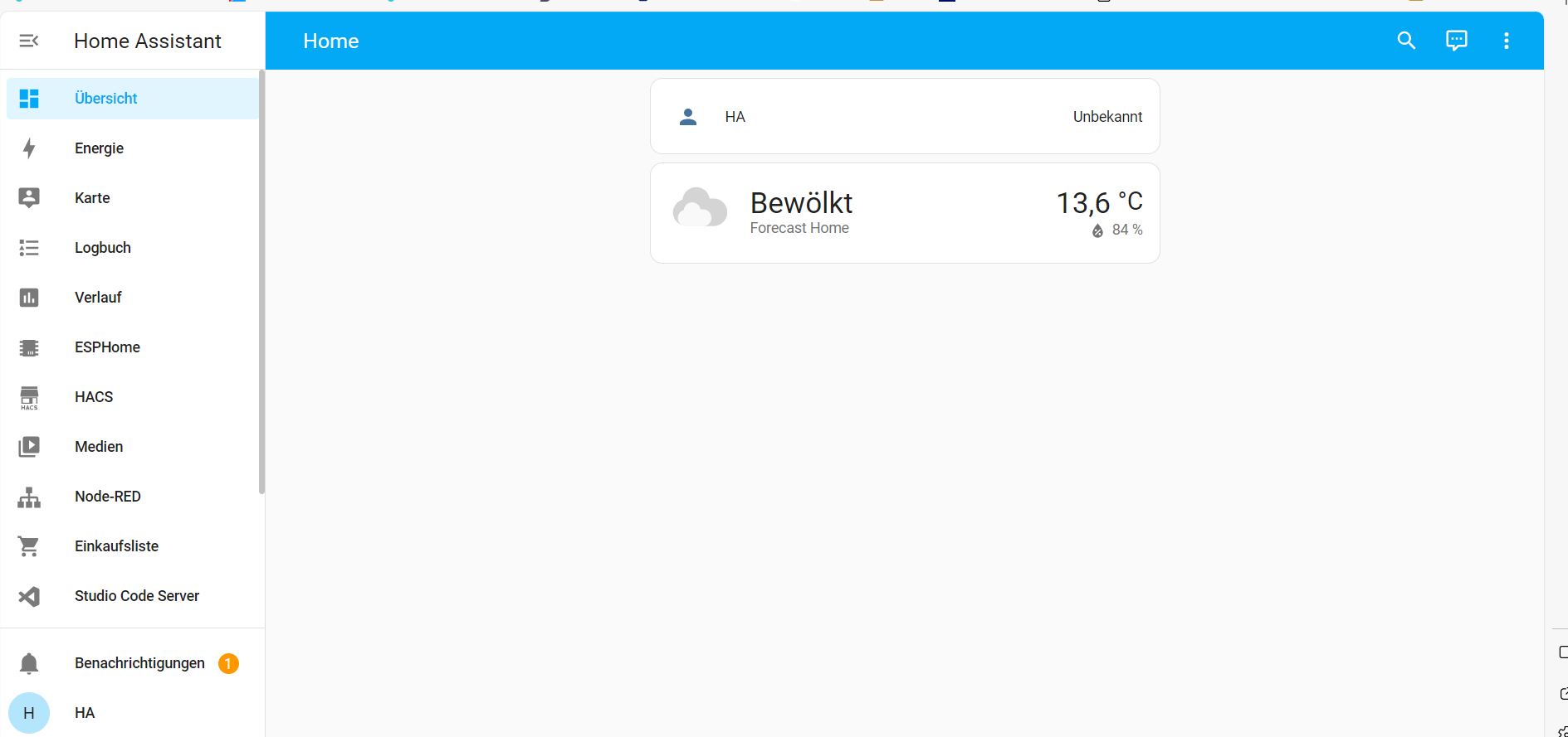

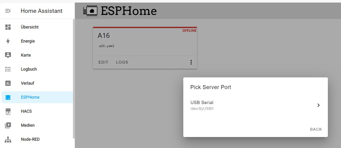

how you download fimware by home assistant? which way? take screen photo. whether you have enabled your serial port in your home assistant server? all need to confirm.
I have at Home Assistant, EspHome and this works with Python. Serial port is enabled he recognizes the device also and tries to install it with the software with the yaml code from the forum. Thereby the error message appears. Therefore I think it will not be a software problem. Is there the possibility to trigger the flash chip manually? Possibly this has a defect?

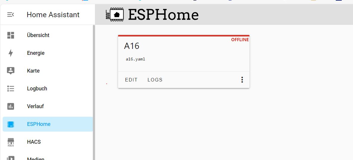

please find attached the desired photos from my HA set-up as well as the error messages appearing when installing the YAML code (your zip-download version). The A16 does not react at all and does not generate an IP-address in my network. I hope, that you will be able to provide some corrective measures and that the A16 is not damage for exchange. I am looking forward to hear from you, thanks
