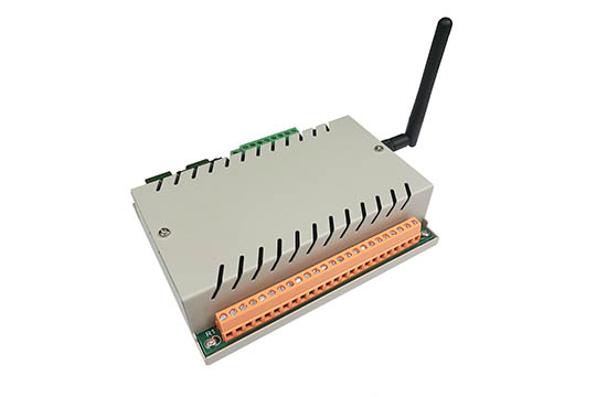

improvement:
1. Support connect to 2 cloud server work at the same time by UDP (KinCony's Cloud server) and MQTT (private MQTT broker server)
2. Fixed controller have delay time when send a large number of commands control relay in TCP Server mode.
3. add auto switch communication line function: if "wifi" and "ethernet " all use by "UDP" work mode connect to KinCony's cloud server. when ethernet line is disconnected (or bad), controller will switch to use "wifi", if ethernet cable is connected, then will switch to use ethernet line connect to cloud server again.
4. when use KinCony smart home app by "UDP" work mode, if turn ON/OFF any relay will feedback the relay state and digital input state to MQTT message.
5. add MQTT query relay state and input state command.
payload={"relay8":{"read":1}} will feedback 8 relays and 8 input state
6. add RS232 command for wifi and ethernet work mode reset
send:"reset-lan" will set "ethernet" work mode by TCP Server and IP static=192.168.1.200
send:"reset-wifi-lan" will set "ethernet" and "wifi" work mode by UDP , IP mode by DHCP
download the ZIP file , unzip update the bin file for KC868-H8B relay controller by USB-RS232 cable.
Relay8_V434_210730.zip (Size: 39.63 KB / Downloads: 300)
