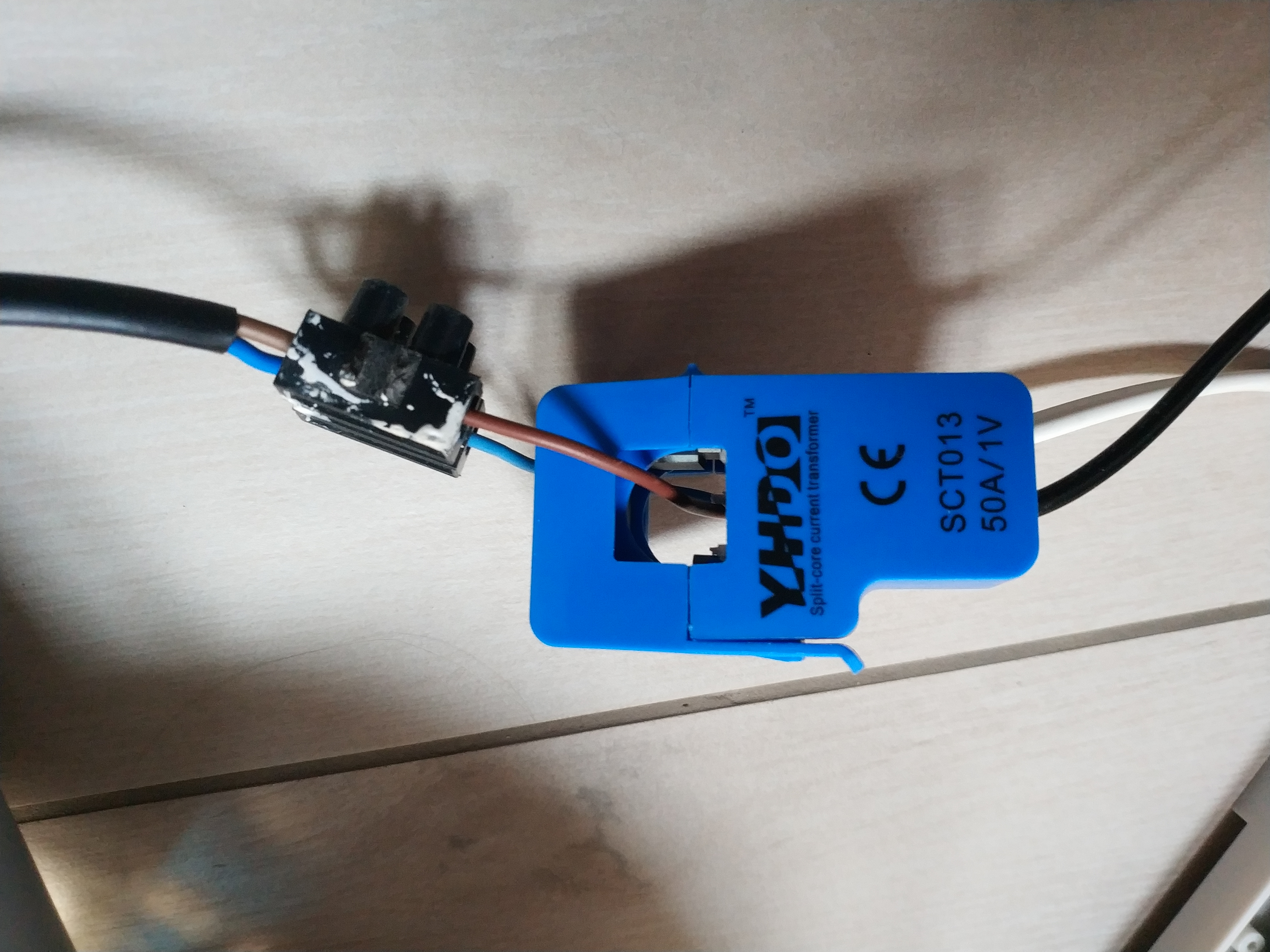

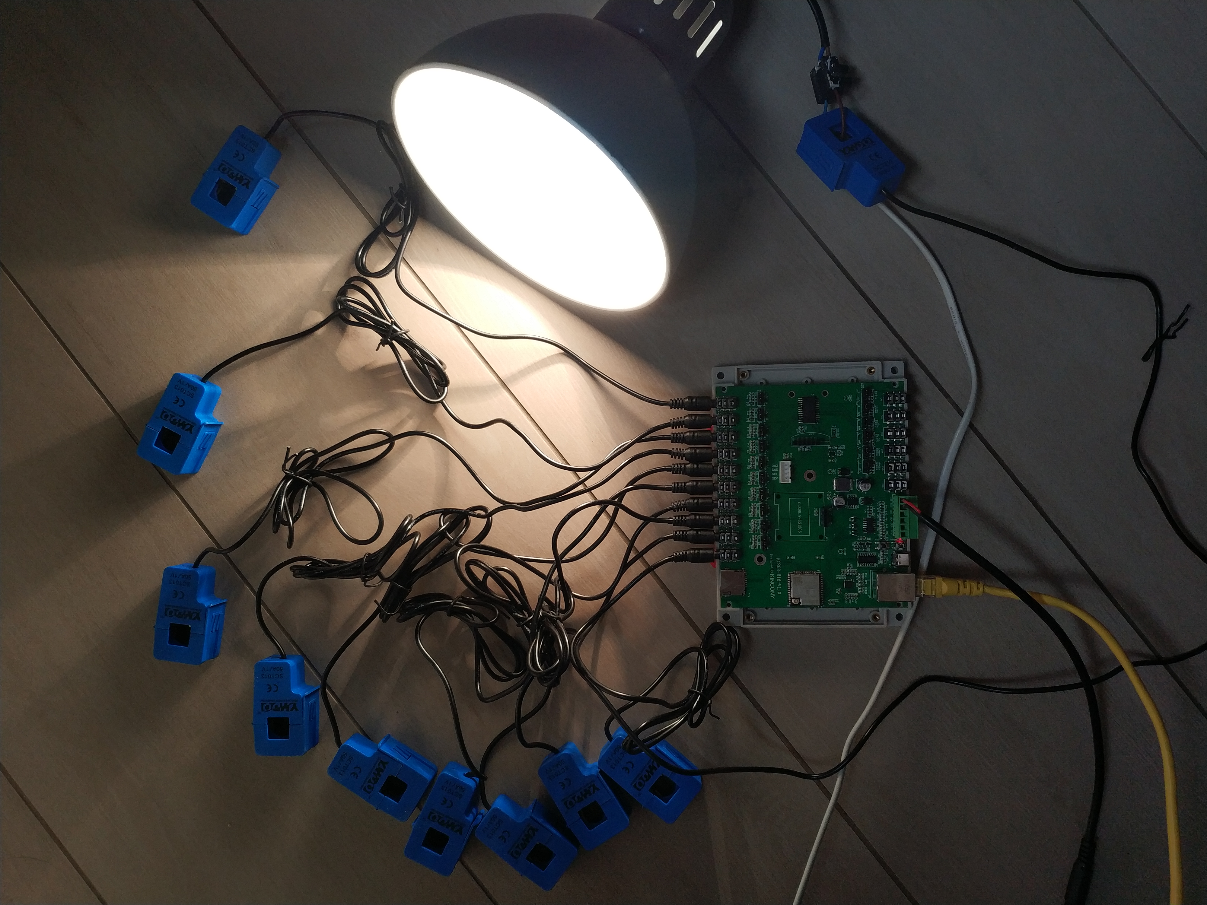

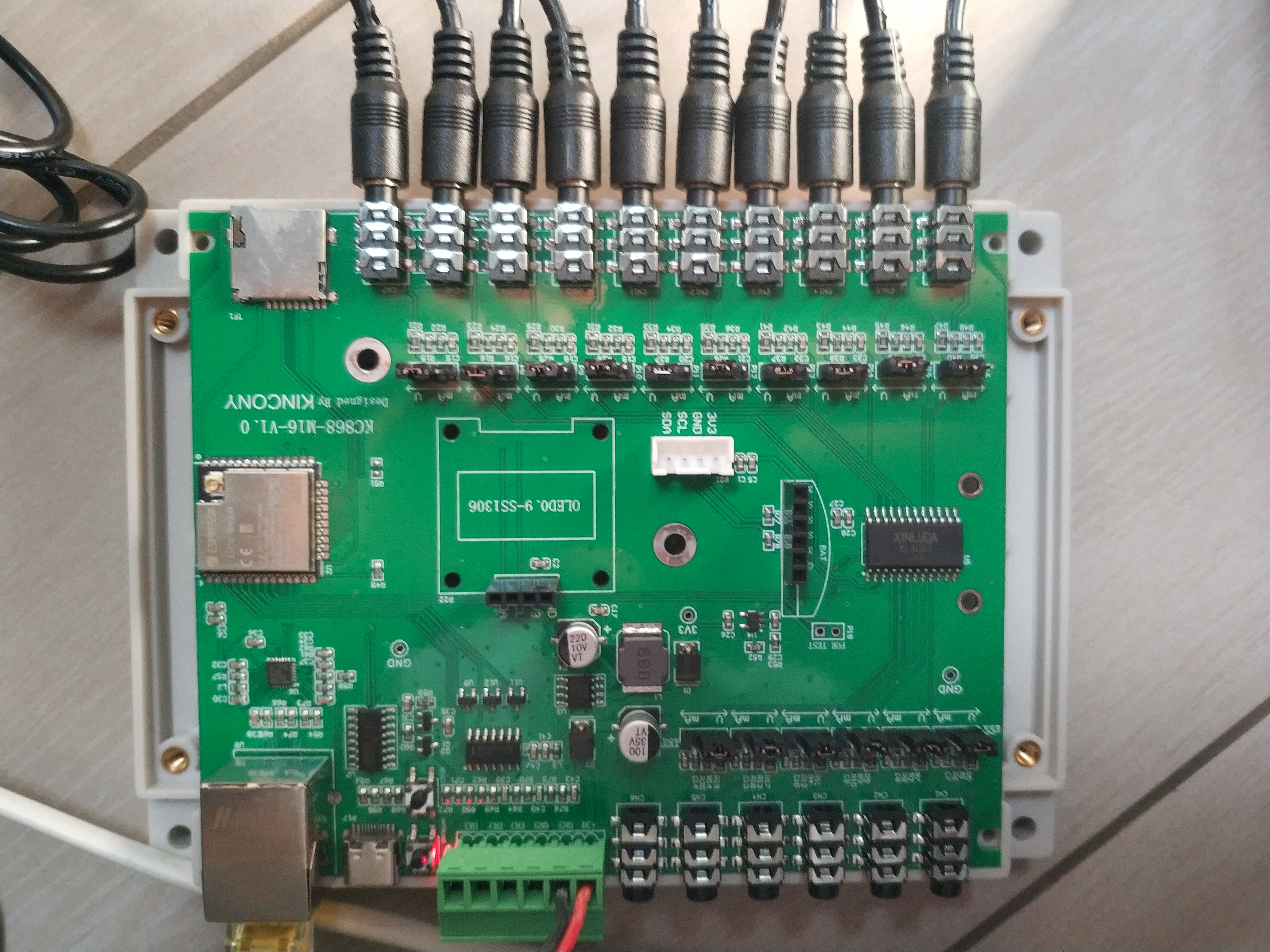

With this "esphome-web-5a54b8_ethernet.yaml" that has the ethernet configured it gives me these logs: "logs_esphome-web-5a54b8_logs_ethernet.txt". I can see the values on HA but after connecting all the clamps and putting a 100w incandescent lamp on channel 1 I don't see any reading. I have 50 -> 1v clamps, the board configured all clamps in volts, the readings it shows are all noise, none gives high values.
Attached is a photo of the assembly
I'm using the dc12v power supply that came with my order from your store, i could look for another one but I have measured the output and it gives 12,16v, it seems correct.

2. if you use 100W light, 50A CT sensor is too large, you should use miniest 10A CT sensor is better.

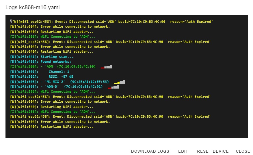

1. I have tested with the phone next to the board at 1 cm and it detects it with a very low and unstable signal. I attach the logs too

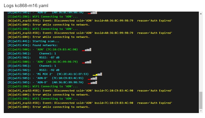

    I tested with a Netgear power sopply and the wifi has the same problem of signal.  I attach image capture too.
2. You are right  50A CT sensor is too large, but measuring the same with the clamp empty is normal? because there is no difference between bulb on and off. I think I could get more accurate measurements with a 10 gauge but I don't know if it's normal that it doesn't measure anything?
I have done another test with a 100a -> 50mA clamp like the one in the video, changed the jumper to Amperes of channel 1 using a 2000W dryer and it works. Voltage clamp measurements may not work?

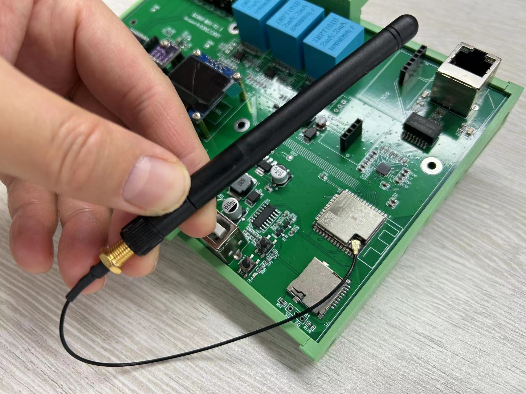

1. i see, you have not installed wifi antena, so the signal is bad. your esp32 wifi module have IPEX socket, use for extender wifi antena. here is photo.
2. M16 board support “voltage" and "current" two types of CT clamp sensor. so you need to set jumper on PCB according to your CT sensor type.
