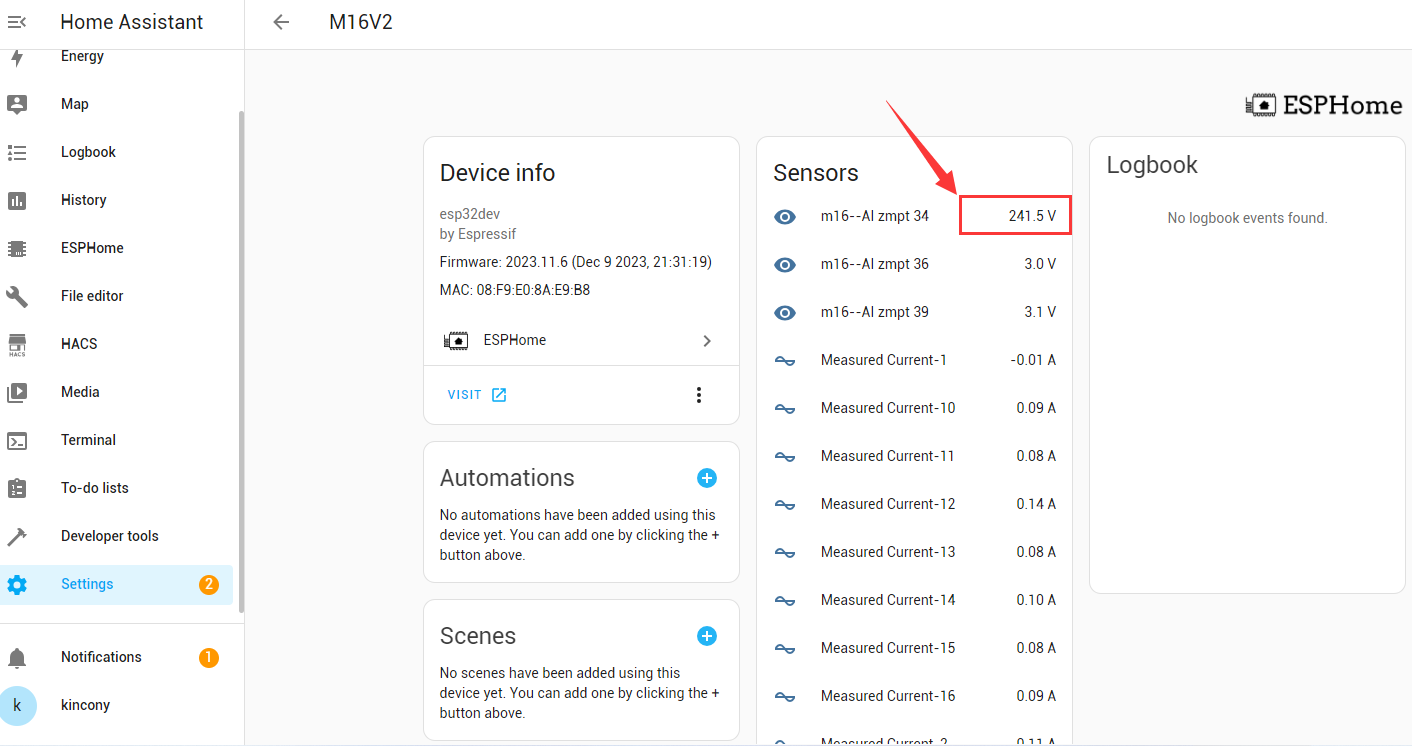

1. run arduino calibration program code to find your "Sensitivity" value for ESPHome M16v2 component.
here is arduino code: https://www.kincony.com/forum/showthread.php?tid=3089

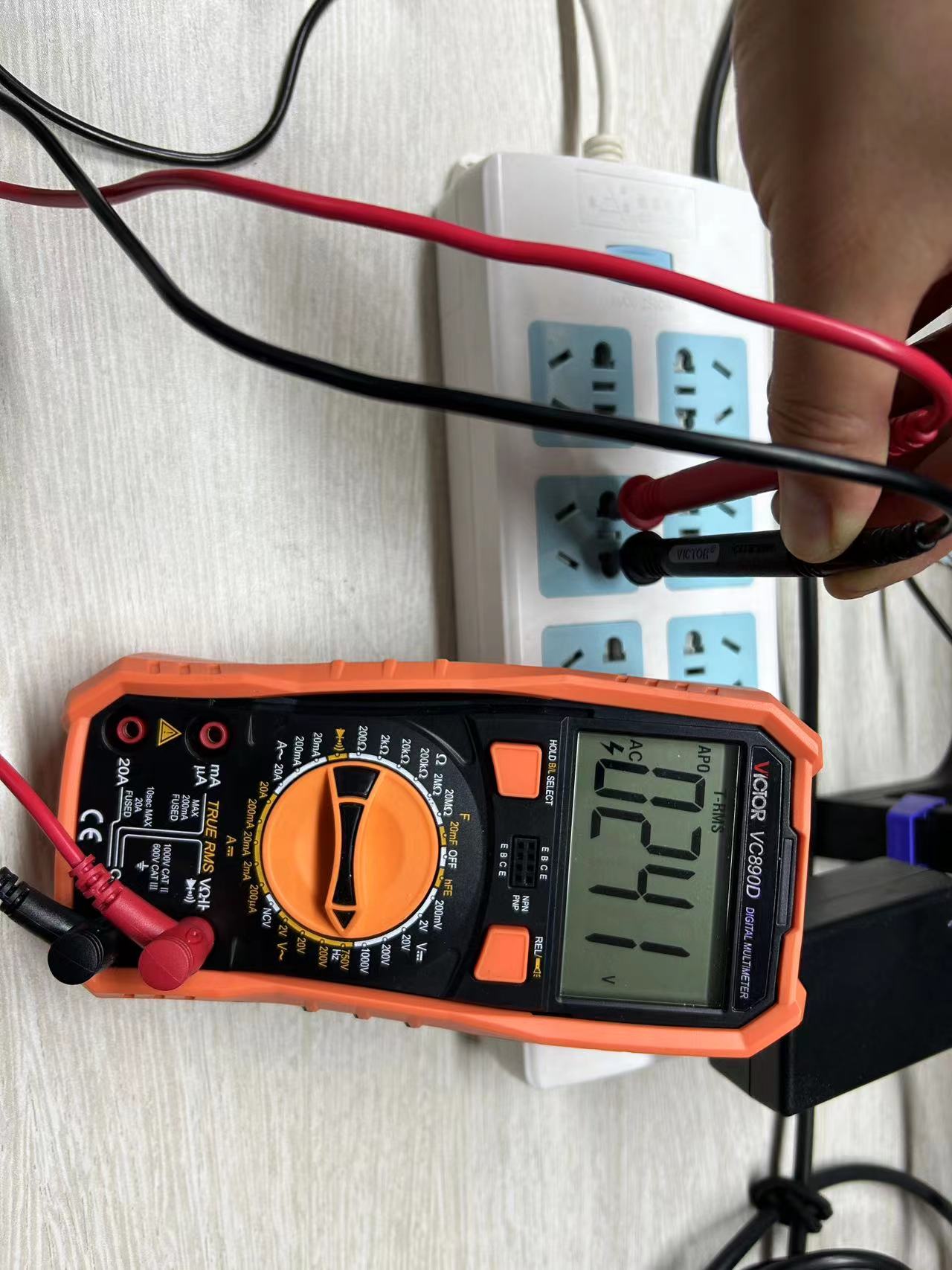

before use this arduino code, you need install "ZMPT101B" arduino library firstly.
then before run this code, use multi meter test your L and N voltage , then only "Change this based on actual voltage" in code:
[Image: attachment.php?aid=3696]
[Image: attachment.php?aid=3697]
when running this code, serial port will print  "Sensitivity" value at the end.
[Image: attachment.php?aid=3698]
then change  "Sensitivity" value in home assistant "/homeassistant/esphome/zmpt101b/zmpt101b_custom_sensor.h"
[Image: attachment.php?aid=3699]
now it's completed.
[Image: attachment.php?aid=3700]
Hi,
Thanks for the info. I ran the procedure for all three phases and slightly adjusted the custom sensor code:
I have different sensitivity values for each sensor and that's why I ended up with this:
#define SENSITIVITY_L1 523.0f
#define SENSITIVITY_L2 513.0f
#define SENSITIVITY_L3 530.25f
    if(this->adcPin==34) {
      this->zmpt101b->setSensitivity(SENSITIVITY_L1);
    if(this->adcPin==36){
      this->zmpt101b->setSensitivity(SENSITIVITY_L2);
    if(this->adcPin==39){
      this->zmpt101b->setSensitivity(SENSITIVITY_L3);
Voltages now kind of match my voltmeter's measurement.
