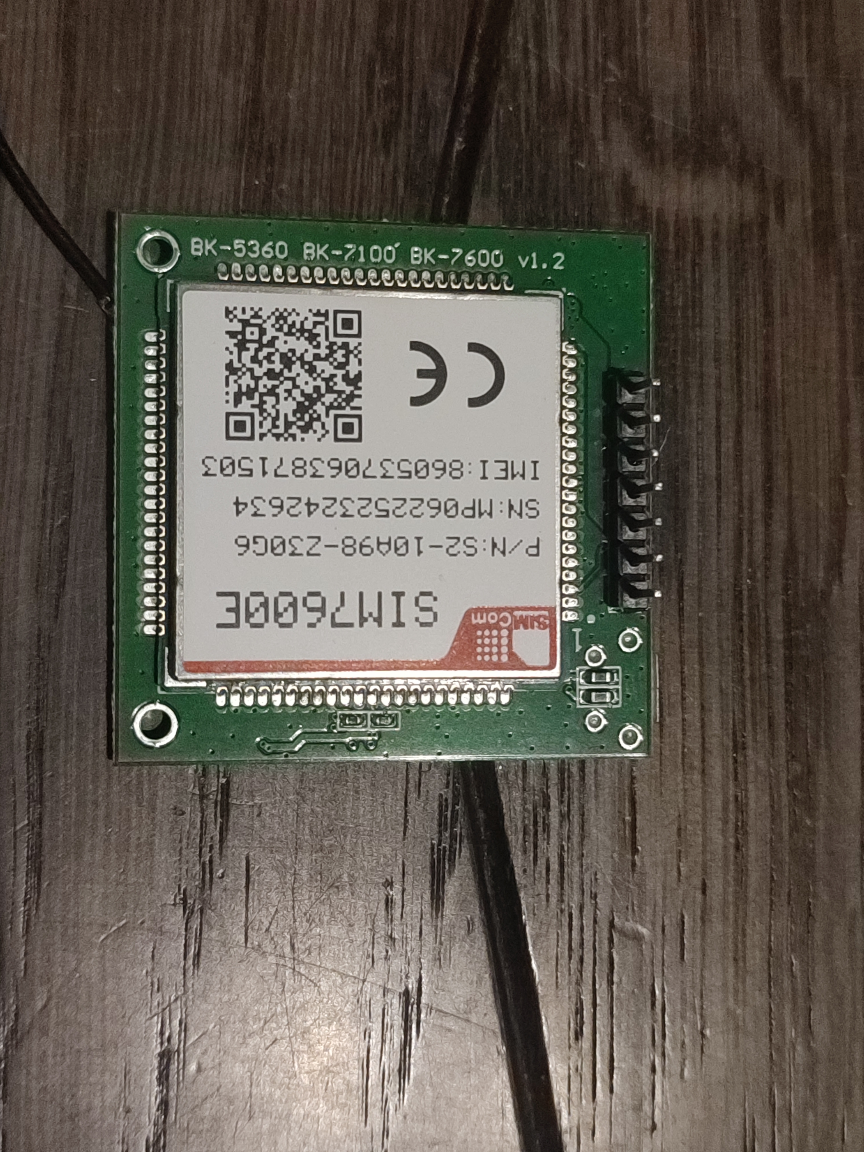

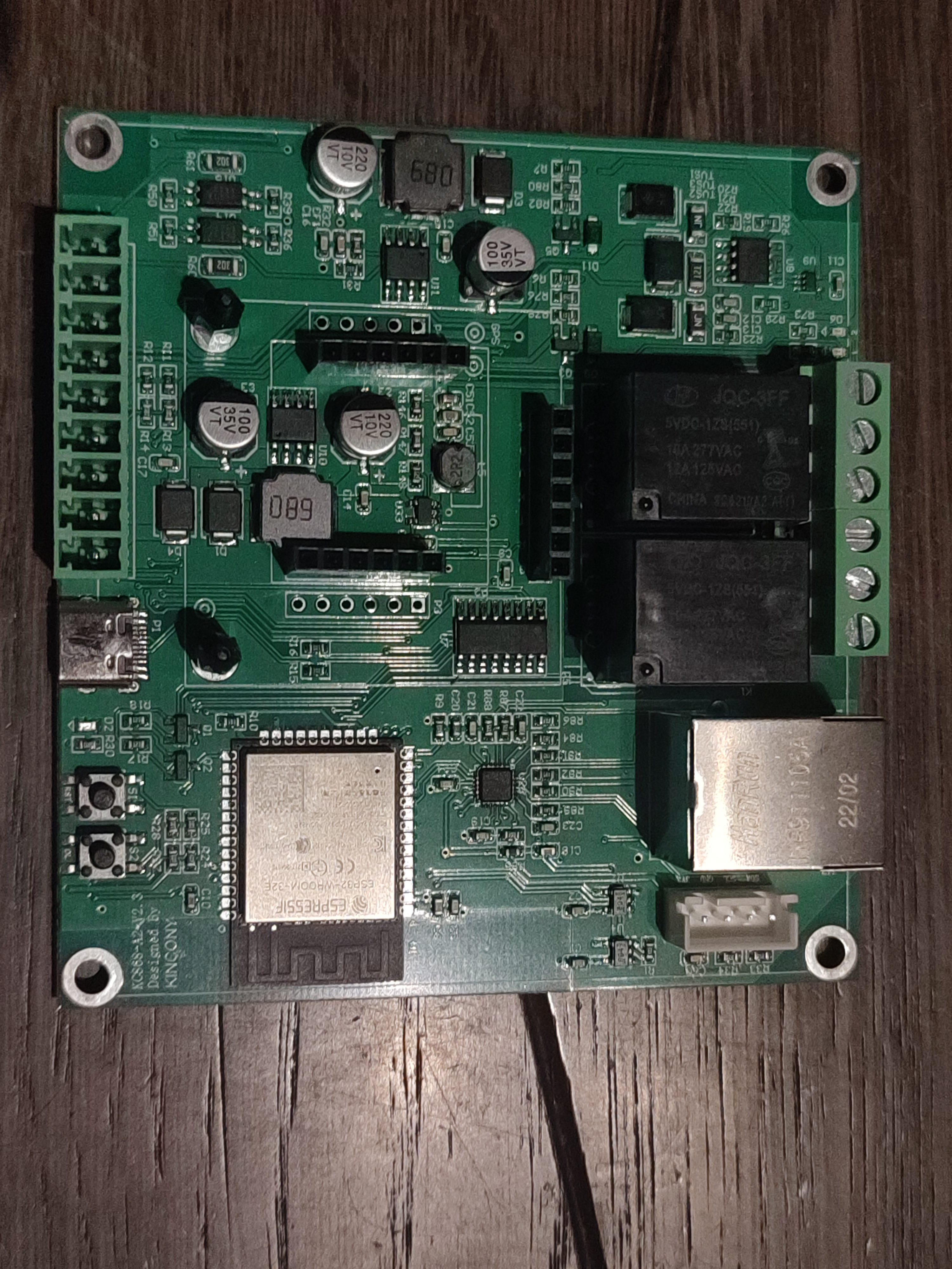

Has anyone managed to get a SIM7600 module to work on the KC868-A2 device ?
ESP32 TX pins shall be PIN34 but this pin in defined as "input only" in ESP32 documentation.
So software crashes on begin function (error "tx_io_num").
Thanks !
