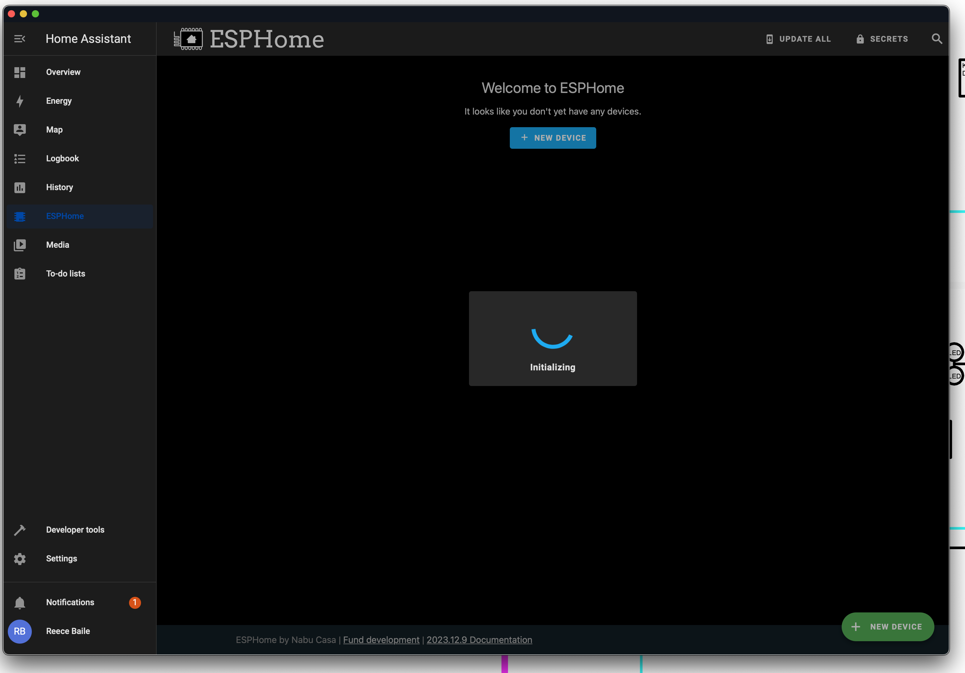

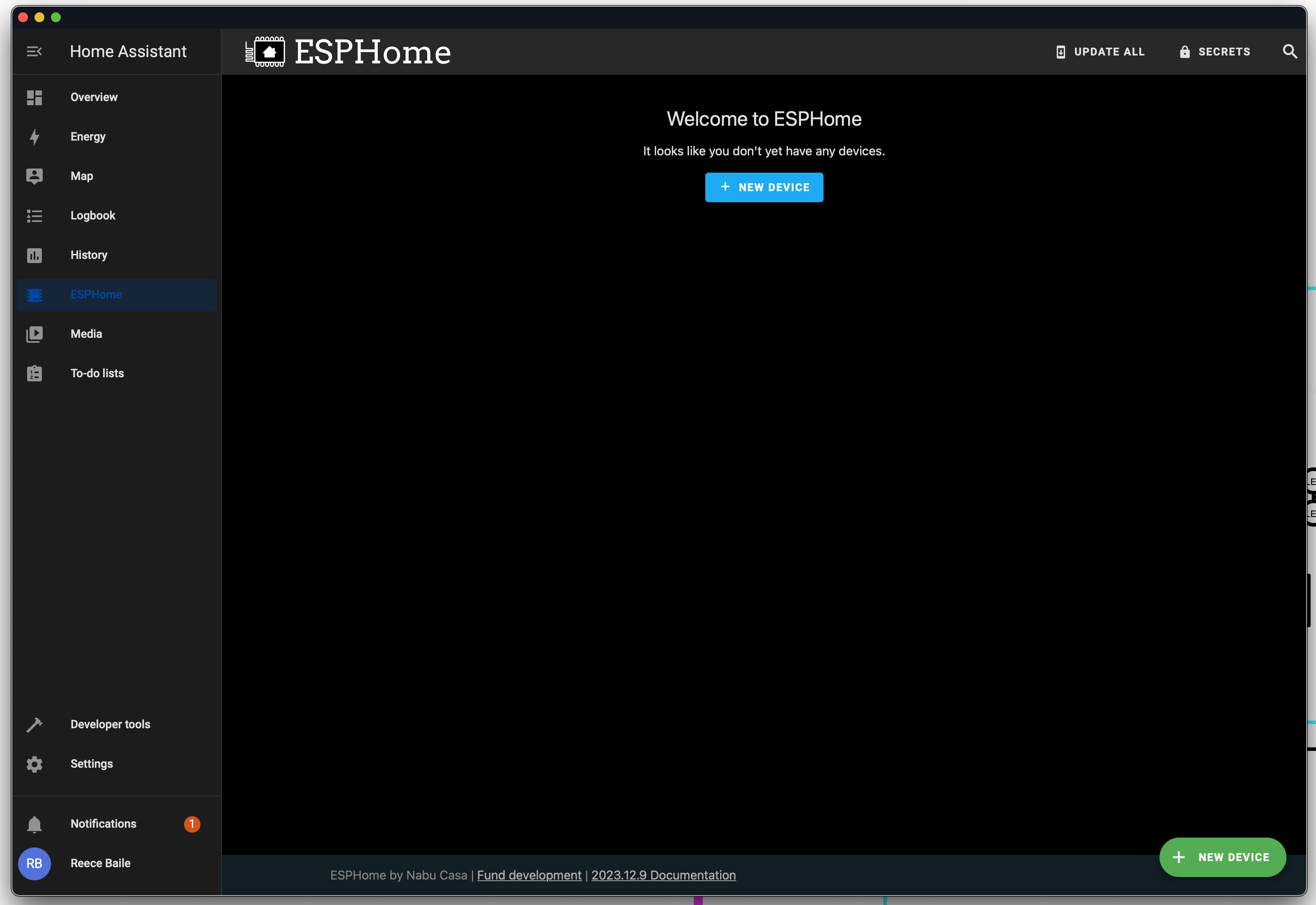

Hi, I'm having difficulties with this device (KC868-A8). I have it plugged into my ethernet switch with cat6 cable, and into my computer with usb. at first I was able to see the device from ESPHome running on Home Assistant and configure through home assistant. Now it does not detect the device when I try to +New Device it just says initialising but never detects it. Also, the ethernet socket on the device no longer lights up (im sure it had yellow light before when I plug in the ethernet cable).
Has my device's ethernet/serial connection failed?

do you download ESPHome firmware by USB cable? you can connect your A8 board with your PC by USB cable, check it whether can be detected.

Yes, I've tried plugging usb into my computer (iMac), as well as the raspberry pi with is host for Home Assistant. Home assistant is communicating well between my iMac and the pi. I was able to see the device before on home assistant, now it doesn't detect it.
Im sure the KC868-A8 had a yellow network light on it previously when it was detecting in home assistant? now it doesn't...

when A8 connect to your iMAC, USB device can be detect?

Not any more. It did when I first tried it. After 1 day, it no longer detects the device
yes I have the ch341 driver installed

ok, that mean A8 hardware is OK. you can delete esphome device, re add a new device, use another board name for a test.

this is your esphome problem, you can delete your esphome addon, re isntall it.
