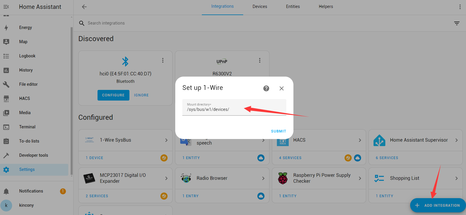

After installed the package in HACS, install the 1-Wire SysBus integration under Setttings-> Devices & services.

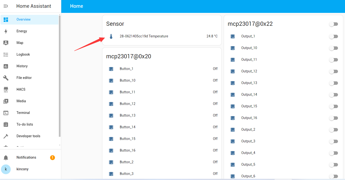

Entities
Upon startup of the platform, the 1-wire bus is searched for available 1-wire devices creates entities based on the sensor unique id:
sensor.28.FF5C68521604_temperature
