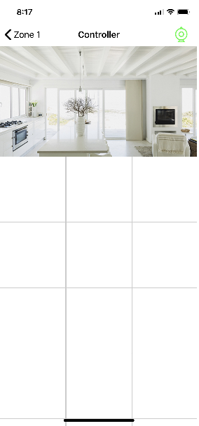

i tried with 2 units of KC868-H8 and same problem.   although the unit are online (picture attached) when I go the part where the controller can be controlled no sliding on/off can be seen. I tried it a couple of times but the other unit H4 that is connect  i was able to control it.
can you change your mobile phone to wifi and 4G with internet for a test.
if also have same problem, send private message about your user name and password, we have a test.

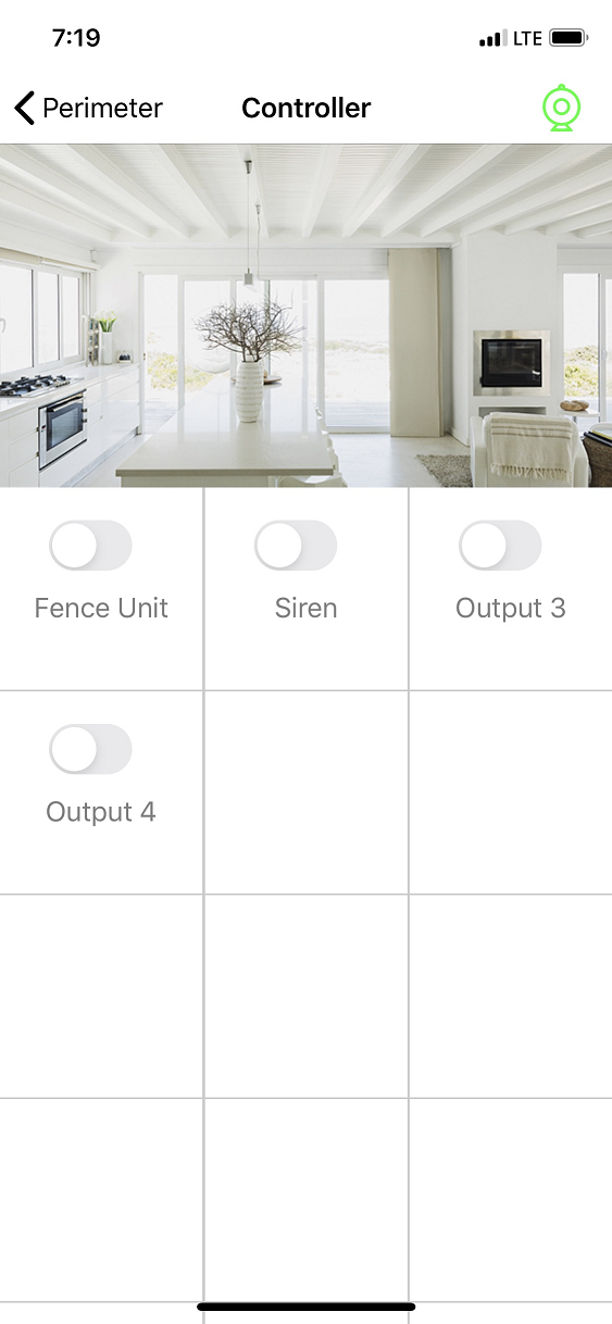

You can see for attached file,  using the same phone,  for KC868-H4, the slide for the on/off switch comes out. the signal for the phone is LTE also.
even if i switch to a different wifi signal, the same happens for the H8 units (both of them) while for the H4  unit , the slide is there.    please note the wifi signal and time
can you control H8 with 3G signal? sometimes there is internet service company line problem, when wifi can't use, but 3G or 4G is work well. I think you can have a test.
