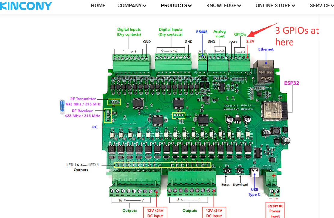

I need to know which physical pin to connect the ds18b20 to, and i'm using arduino ide and c++ to code. Please point me to the specific schematic and code.
DS18B20/DHT11/DHT21/WS2812 LED strip -1: GPIO32
DS18B20/DHT11/DHT21/WS2812 LED strip -2: GPIO33
DS18B20/DHT11/DHT21/WS2812 LED strip -2: GPIO14
schematic pdf: https://www.kincony.com/download/KC868-A...ematic.pdf
GPIO 32,33,14 are not options on the KC868-A16! If they are, please show me a photo of where!
Can you please refer this to someone who understands my question!
see here photo, 3 gpios for user.
None of these gpios are 32, 33, 14. They are labeled gpio 1 to 3.
I,ve tried assigning these as the one wire bus, but nothing works.
Why is this such an issue for you? Am I not making myself understood?
labeled gpio 1 to 3 means GPIO 32, 33, 14
Not use GPIO1, GPIO2,GPIO3. You should use GPIO32,GPIO33,GPIO14.
