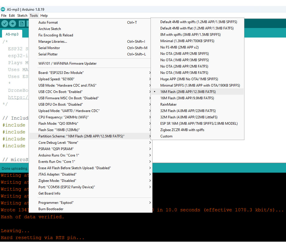

BIN file (you can use esp32 download tool download to ESP32-S3 with address 0x0 then directly to use) download:
.zip   AS-mp3.ino.merged.zip (Size: 878.75 KB / Downloads: 814)
arduino IDE compile setting:
