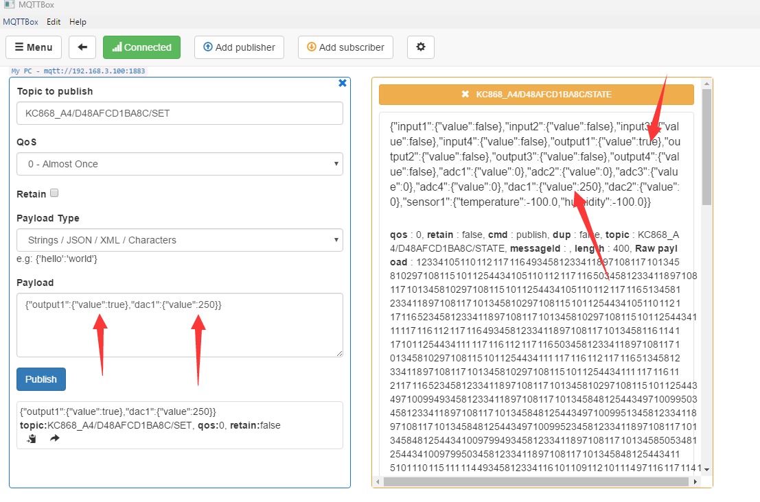

v2.2.7 improvement:
1. Fix the problem that the mqtt command does not support the simultaneous processing of multiple commands
2. Fixed mqtt instructions run_rf, run_ir, set_beep returning wrong json format
for example:
{"output1":{"value":true},"dac1":{"value":250}}
{"output1":{"value":true},"output2":{"value":false},"output3":{"value":true},"output4":{"value":false},"dac1":{"value":125}}
these can write in one payload.

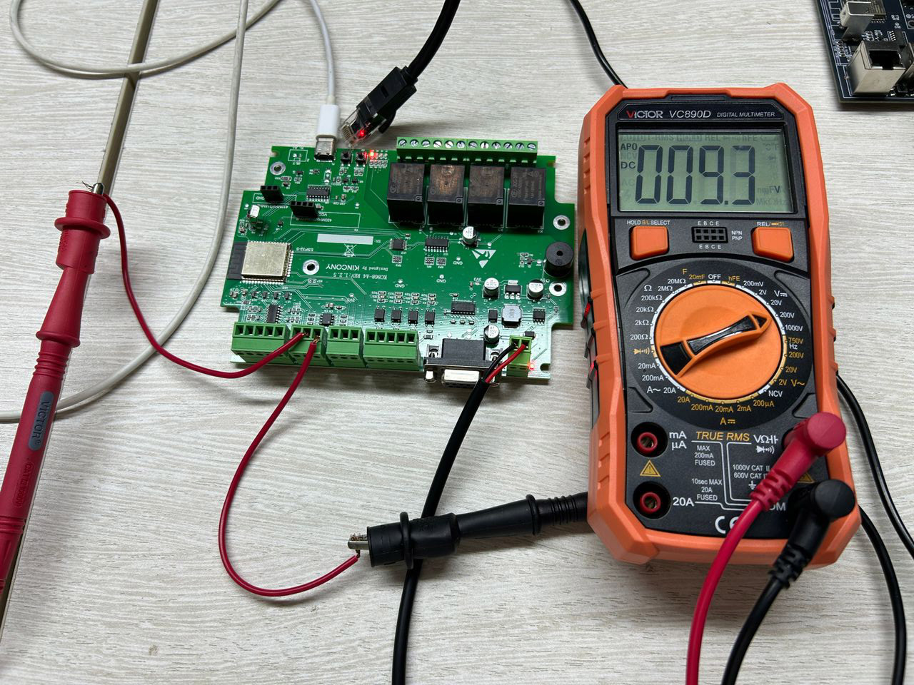

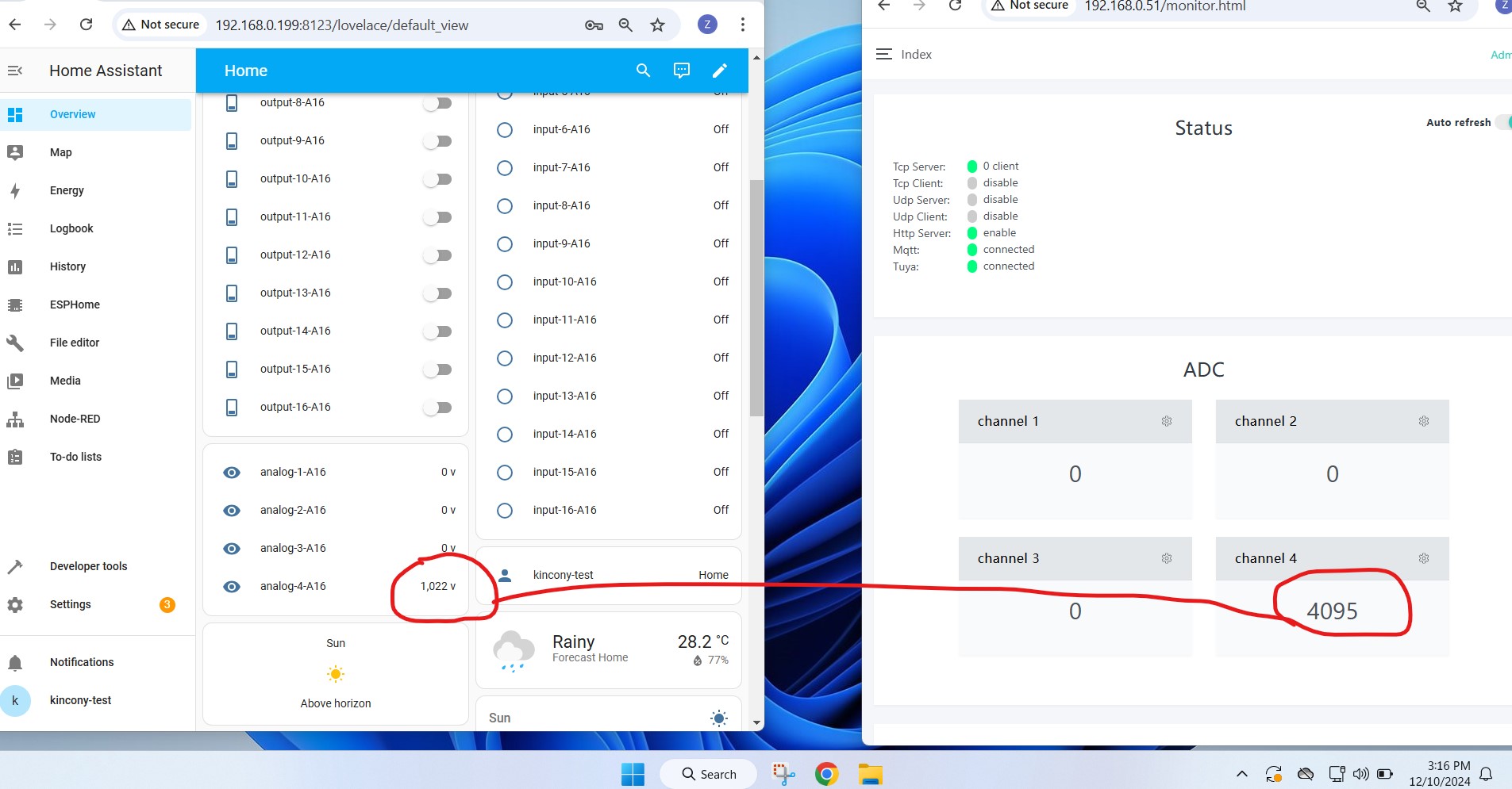

I just want to ask if this is a bug or I just missed something?
(1) The ADC data on my home assistant is not updating automatically when I adjust my potentiometer connected to Channel 4 (CH4). The A16 was integrated to HA thru MQTT with KCS firmware.
But I observed that the data on HA will be updated only when i click any output switch on home assistant. Its like ADC values on KCS is not throwing data to MQQT unless there is someone that will trigger to update the TOPIC state

1. Click the gear button to set the minimum threshold for data reporting
2. Go to "sensor" webpage, set all gpios for DHT11, then you will see the value.

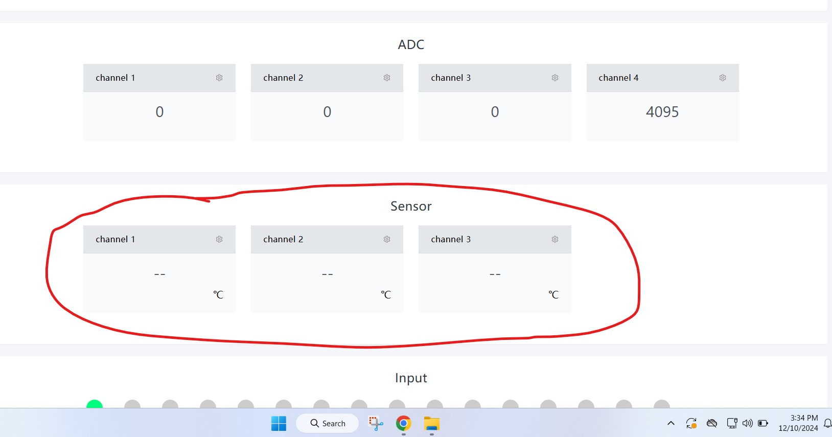

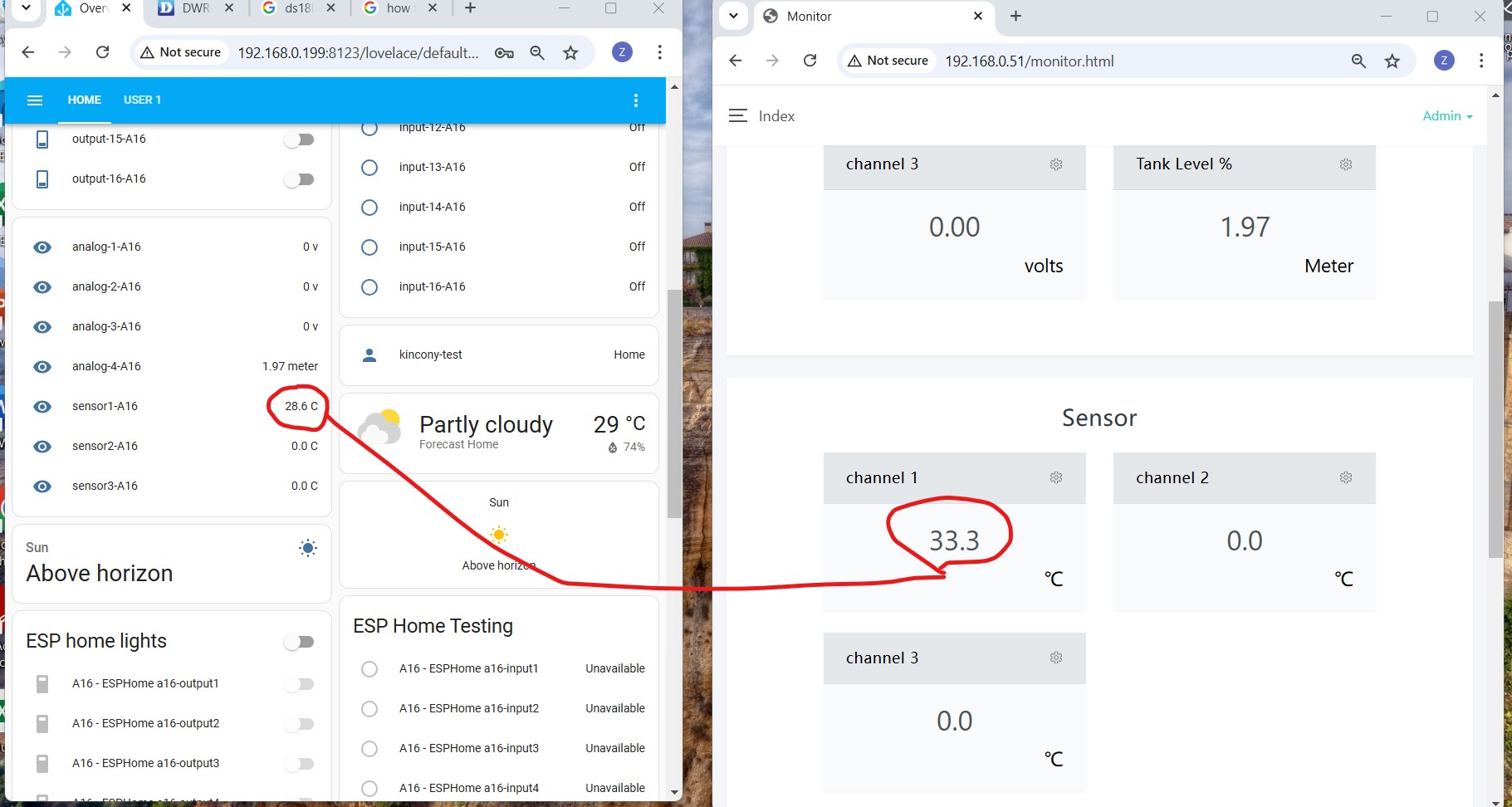

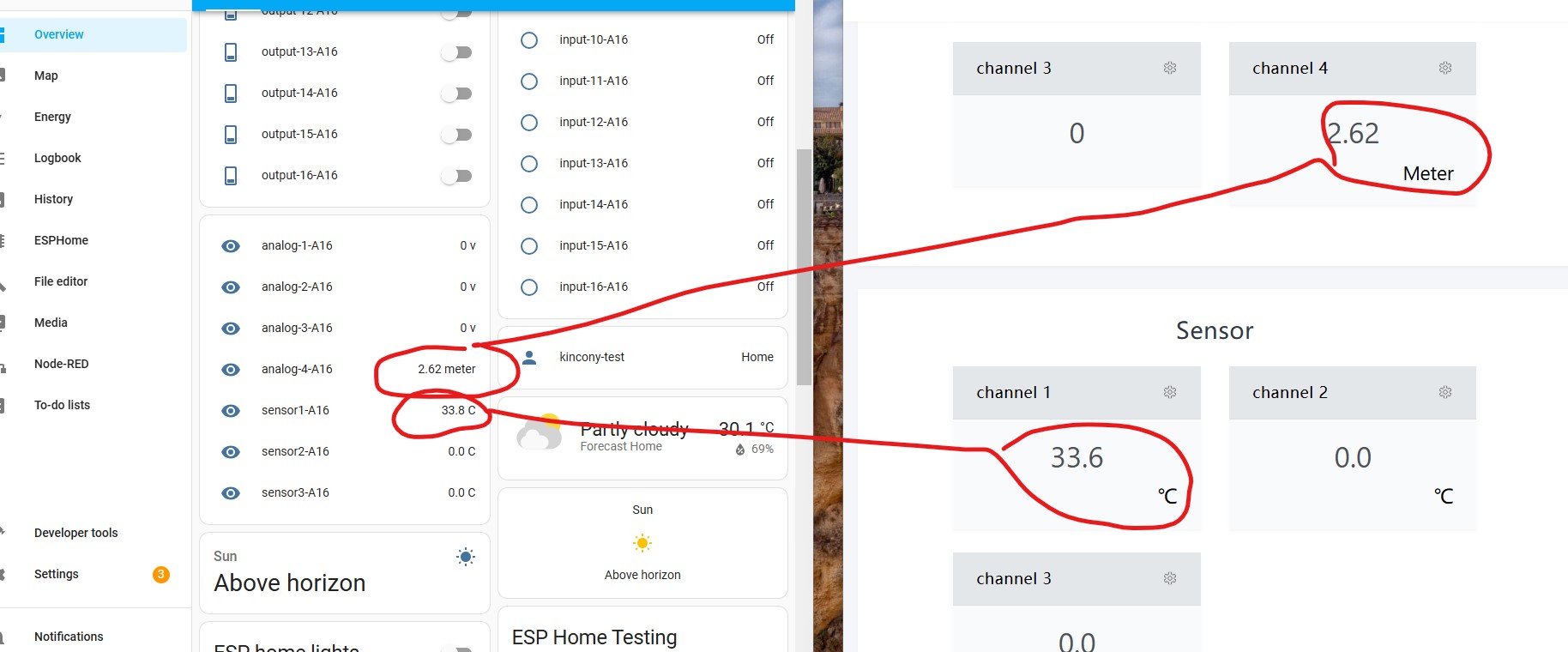

Now, I have another encountered problem, the temperature data on my Home Assistant is not updating, see image below:
I put a tested to input different numbers from 0.1 to 10, but still not updating, see image below for reference.

can you test with this firmware whether work well.
.zip   KCS_KC868_A16_V2.2.8.zip (Size: 763.42 KB / Downloads: 686)
(12-13-2024, 03:58 AM)admin Wrote: can you test with this firmware whether work well.
Thanks Admin, this v2.2.8 is OK. Already solved. Thanks for the fast feedback.
