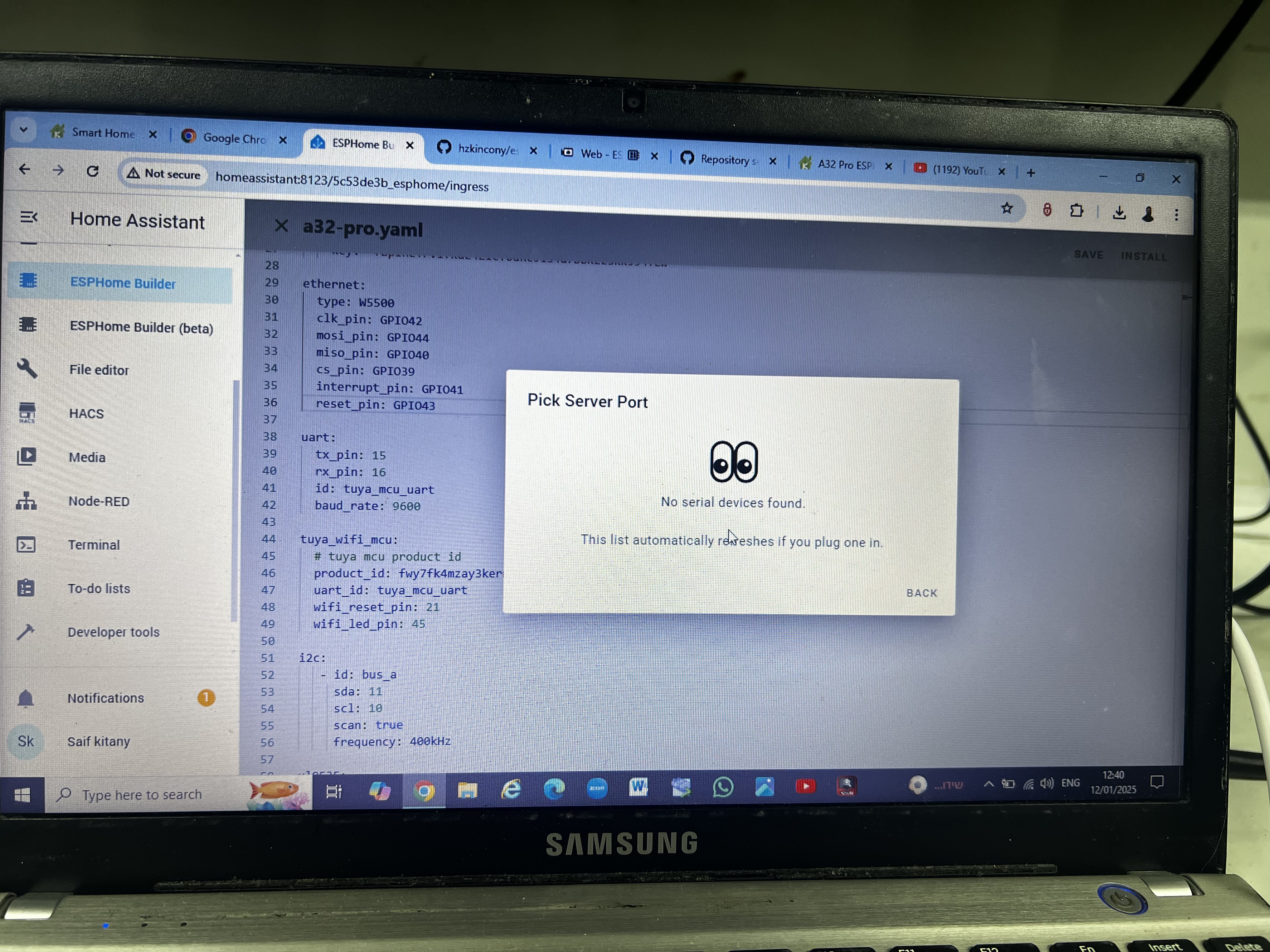

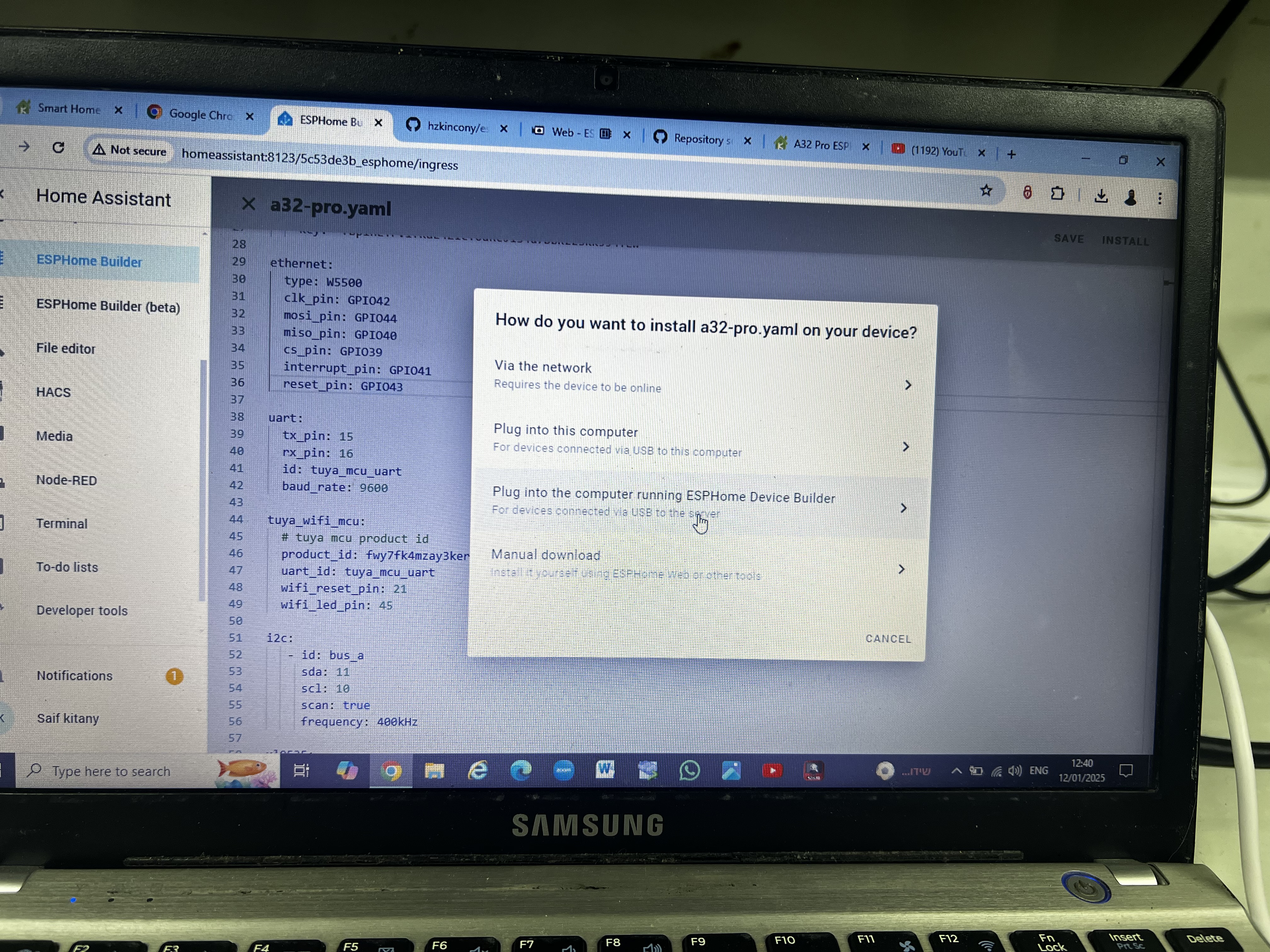

I installed esphome buldier add on and trying to install the yaml file, but i get this messageshown in the pictures.
My a32 pro connected by usb type-c to server 16 usb port.

what's your server? raspberry pi? you should enable USB port.

answer my question. where installed home assistant software.
01-13-2025, 05:19 AM
On the kincony server 16 raspberry pi
01-13-2025, 10:14 AM
default disabled USB port, you need to ENABLE. how to do , see here: https://www.kincony.com/forum/showthread.php?tid=1980
