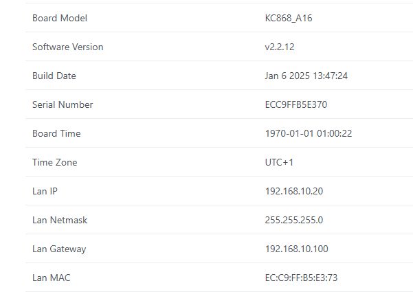

i have a problem with the NFP, in fact impossible to have a correct display with the right time zone.
What is the reading cycle of the NTP server?
The internet connection is good.
This NTP server works well on all my computers

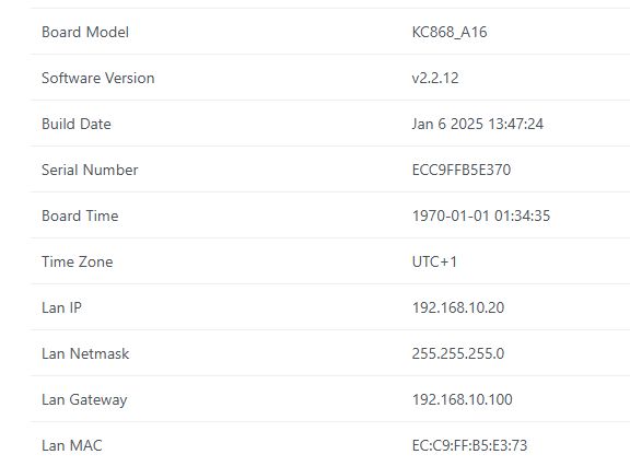

The capture 3 is the time of my computer
Regards
Board : K868-A16
Firmware :  v2.2.12

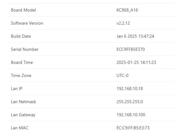

try test with this new firmware
.zip   KCS_KC868_A16_V2.2.12.zip (Size: 763.79 KB / Downloads: 712)
Hi,
Ok with the firmware,
but for me there is still another problem
If we restart the card the time is not up to date
1.After a rest you have to read the NTP server immediately to have the time and synchronize with the other equipment.
2. what is the reading cycle of the NTP server?

For me it is not stable.. I have the impression that this happens when there is a static IP, can you see on your side.
Board : K868-A16
Firmware :  v2.2.12
after 1h30 still not up to date
Board : K868-A16
Firmware :  v2.2.12
