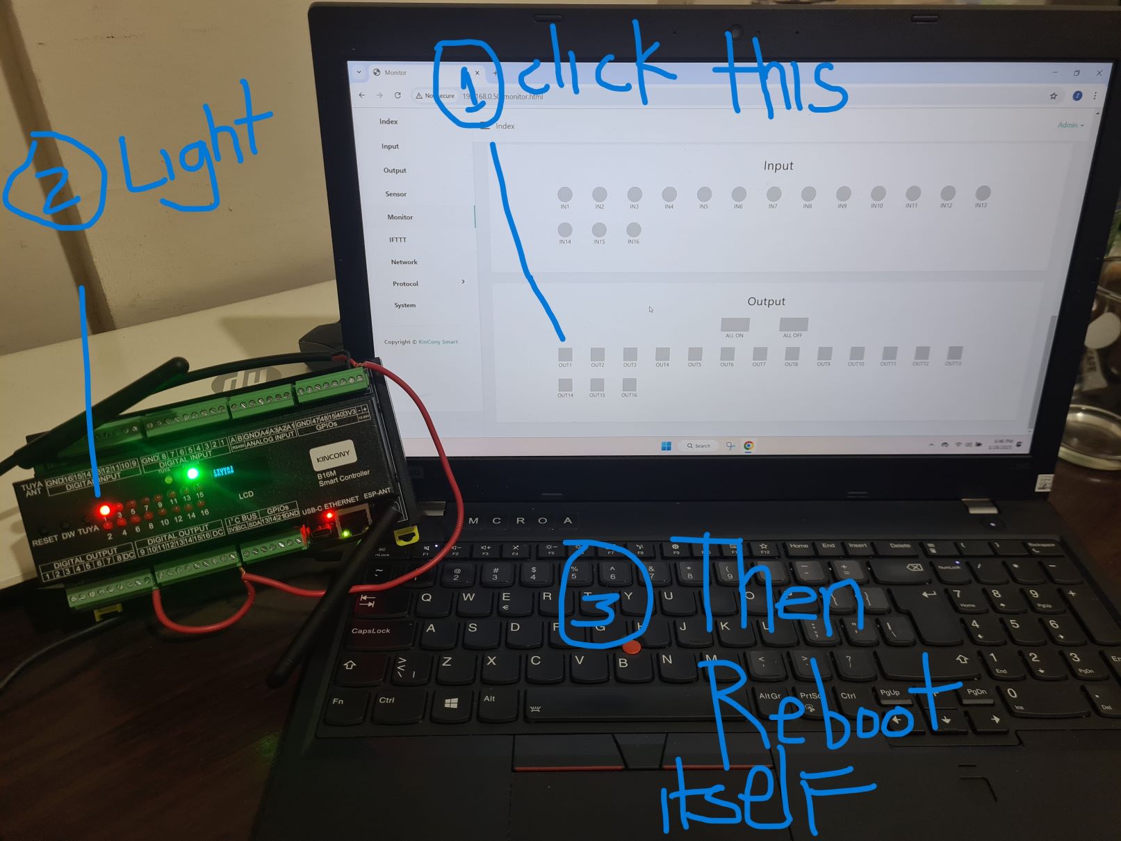

(2) But when I am clicking any of the 16 switches (1-16 OUTS), it reboots.
In the photo, I clicked OUT1, the RED LED on B16M lit, but the KCS firmware dont have color green as expected.
(3) Then after 3 seconds, the RED LED turned off then the board reboots it self.

But I think this is not a hardware problem, because i did this:
(1) I repeat the flashing, no MQQT, no Tuya linking, just a bare.
I open its IP at 192.168.4.1 as default, all 16 outputs are ok ok when i press, works normal.
(2) Then I set static IP, set to Static wifi mode IP, +8 utc, so far its working normal no problem.
(3) Then I link tuya and MQTT HA Auto discovery, at first 5 mins it ok., testing all button ok. Then after some short time suddenly it reboots again.
Then back to problem as stated in this thread (ALL ON and ALL OFF button on KCS are ok, but pressing individual switches it reboots)
( I disabled all automations on my home assistant just to test if this mqtt is the culprit)
The worst part are, when i disabled the MQTT of board to KCS and unlink my Tuya on my smart life account, the problem still present even Im back on my item(2) setup. Is it possible that a software problem embedded itself on the B16M board? Taka note that Im back to where I am at item no.2 where it is perfectly fine. Im confused what is wrong.
Admin, Please check why this problem exist. i will post my MQTT addon log on this thread
