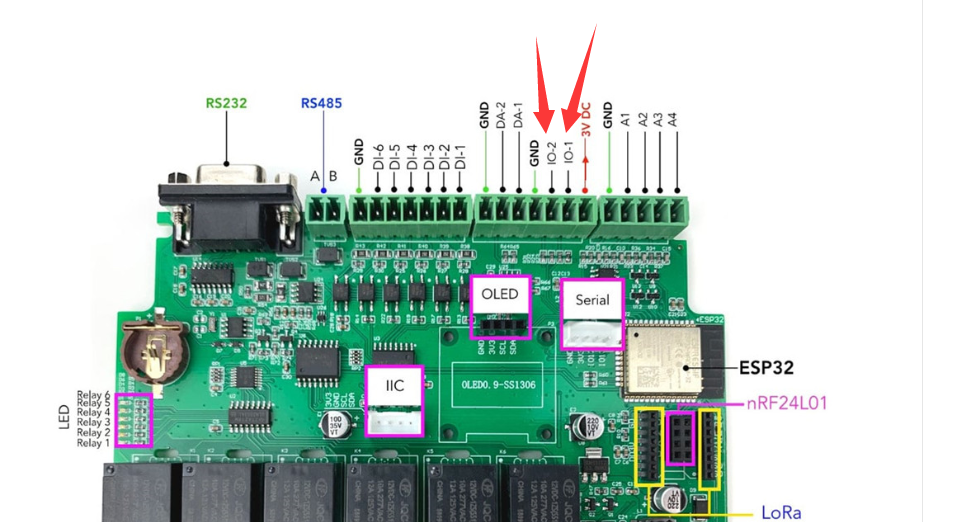

Trying to connect a flow meter to the KC868-a6-v1.3sp board. I expect around 500 Hz.
Are there any GPIO pins available for this on the board?

see this photo, here is IO1 and IO2 connect with ESP32 pins directly, you can use it.
(05-18-2025, 12:37 AM)admin Wrote: see this photo, here is IO1 and IO2 connect with ESP32 pins directly, you can use it.
