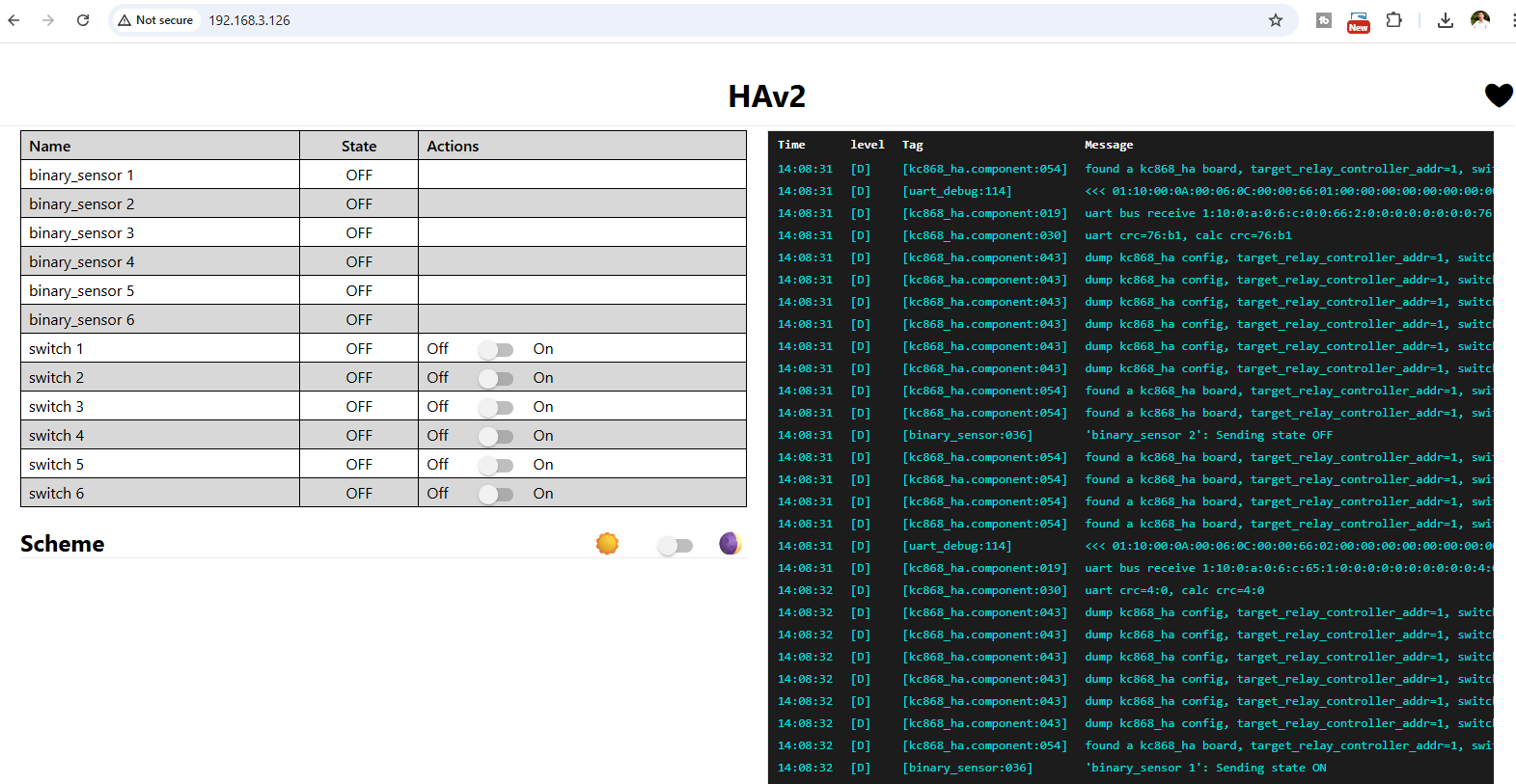

KC868-HAv2 work with F24 using ESPHome yaml
  friendly_name: HAv2
esp32:
  board: esp32-s3-devkitc-1
  framework:
    type: esp-idf
  baud_rate: 0
# Enable Home Assistant API
ethernet:
  type: W5500
  clk_pin: GPIO42
  mosi_pin: GPIO43
  miso_pin: GPIO44
  cs_pin: GPIO41
  interrupt_pin: GPIO2
  reset_pin: GPIO1
external_components:
  - source:
      type: git
      url: https://github.com/hzkincony/esphome-kc868-ha
      ref: v3.0.1
uart:
  - id: myuart1
    tx_pin: 16
    rx_pin: 17
    baud_rate: 9600
    debug:
      direction: BOTH
      dummy_receiver: false
kc868_ha:
binary_sensor:
  # The binary_sensor corresponds to the state changes generated by K1~K6 on the KC868 HA board
  # bind_output is required. Corresponds to the BindOutput parameter in HA485_Ctrl software
  # Other parameters refer to: https://esphome.io/components/binary_sensor/index.html
  - platform: kc868_ha
    target_relay_controller_addr: 1 # Default value is 1, corresponds to the Target Relay Controller Addr parameter in HA485_Ctrl software
    switch_adapter_addr: 10 # Default value is 10, corresponds to the Switch Adapter Addr parameter in HA485_Ctrl software
    bind_output: 1 # Corresponds to the BindOutput parameter in HA485_Ctrl software
    bind_output: 2
    bind_output: 3
    bind_output: 4
    bind_output: 5
    bind_output: 6
  # The switch is used to control the D1~D6 level output on the KC868 HA board
  # Other parameters refer to: https://esphome.io/components/switch/index.html
    bind_output: 1
    bind_output: 2
    bind_output: 3
    bind_output: 4
    bind_output: 5
    bind_output: 6
web_server:
  port: 80
.txt   HAv2-F24-yaml.txt (Size: 3.04 KB / Downloads: 400)

download yaml:
.txt   HAv2-F24-Tuya.txt (Size: 20.91 KB / Downloads: 371)

certain buttons define modes that allow the others to change their function, and led lights to turn on to signify the mode your in,
my wish is to use the same switch for :
lighting
blinds
music (basic controls)
controller is homeassistant where lighting , blinds and music have control endpoints.
HAv2 only support "single click" way. if you want "1-click", "2-click", "hold on" different actions. you can connect with controller's digital input ports directly, that supportted.
(01-09-2026, 01:03 AM)admin Wrote:
(01-08-2026, 10:57 PM)swisstmack25 Wrote: I have bought the F24, multiple HAv2, and multiple six contact switches same as  shown in the photo above.
is there a way to implement the following:
single tap - achieved
double tap ?
long press
lighting
blinds
Can't you program that in ESP home or automate it in HA?
HAv2 use by ARM CPU, not ESP32, so can't use by ESPHome.
