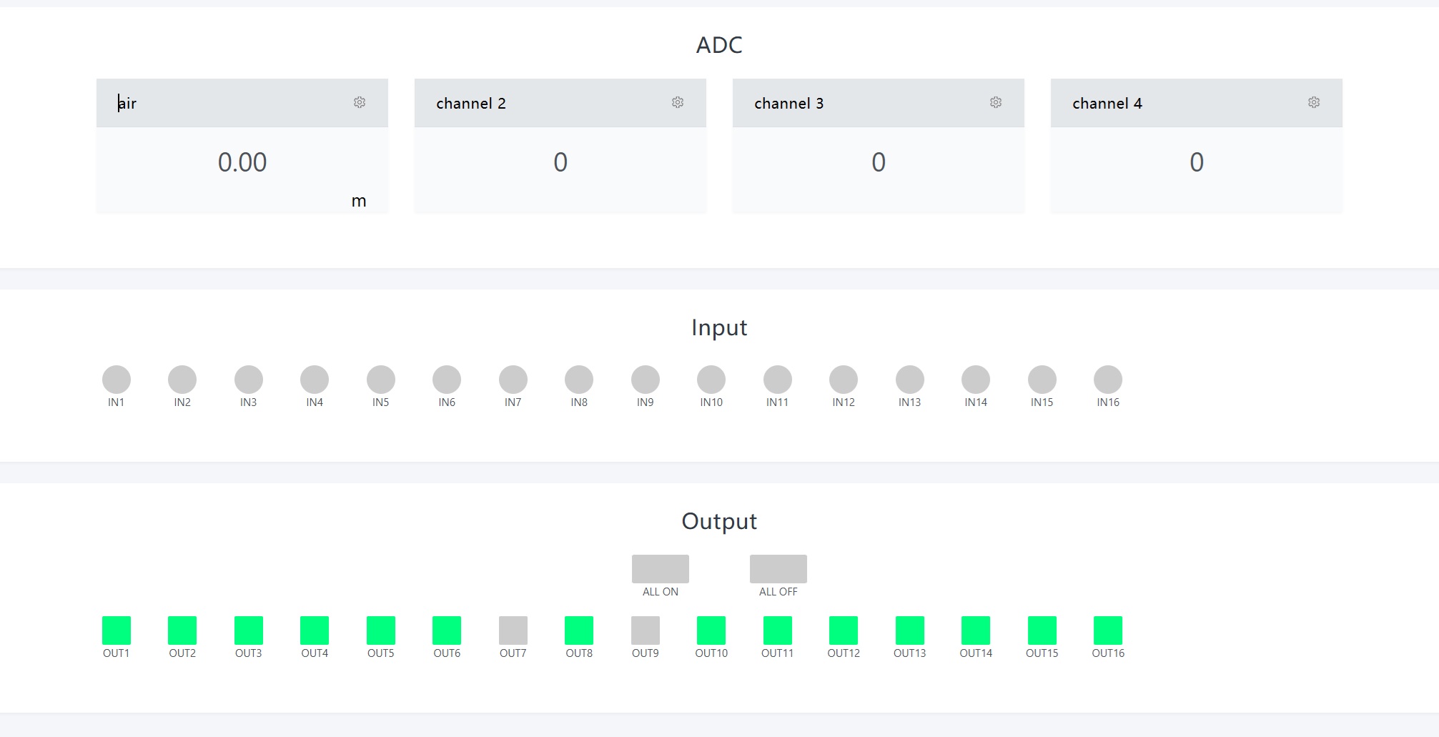

Good afternoon, I have a problem. with  KC686-A6 and KC868-A16 panel
I installed new firmware,I connected everything and everything works.
but,On the web browser and on the phone  Only relay outputs work fully!!
like INPUT or ACD NOT!!! There are no errors, nothing.That is, they can be registered and something can be done with that.
You can make whatever you want with programming that.
the phones are not pressed either
Also, when connecting buttons or sensors, they do not give any sign of life.
Maybe there is something missing in the code Well, as I understand it, the firmware has everything included, just like in the video on the official website
What could be wrong or where is the problem please tell me ?
Thank you very much have a nice day

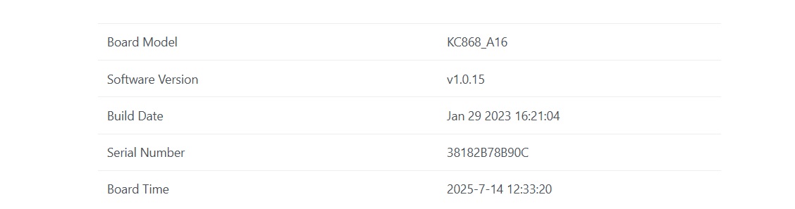

please use the newest KCS v2 firmware , here is download link: https://www.kincony.com/forum/showthread.php?tid=8267
KCS v2 online guide: https://www.kincony.com/esp32-kcsv2-firmware.html
Wink
(07-14-2025, 09:36 PM)admin Wrote: please use the newest KCS v2 firmware , here is download link: https://www.kincony.com/forum/showthread.php?tid=8267
Thanks… it helped… everything seems to be working now.
I just don’t understand why you keep posting videos with old firmware and don’t immediately highlight the new ones, even on the website.
Everyone just ends up doing the same thing over and over again for no reason…
because software always update.
