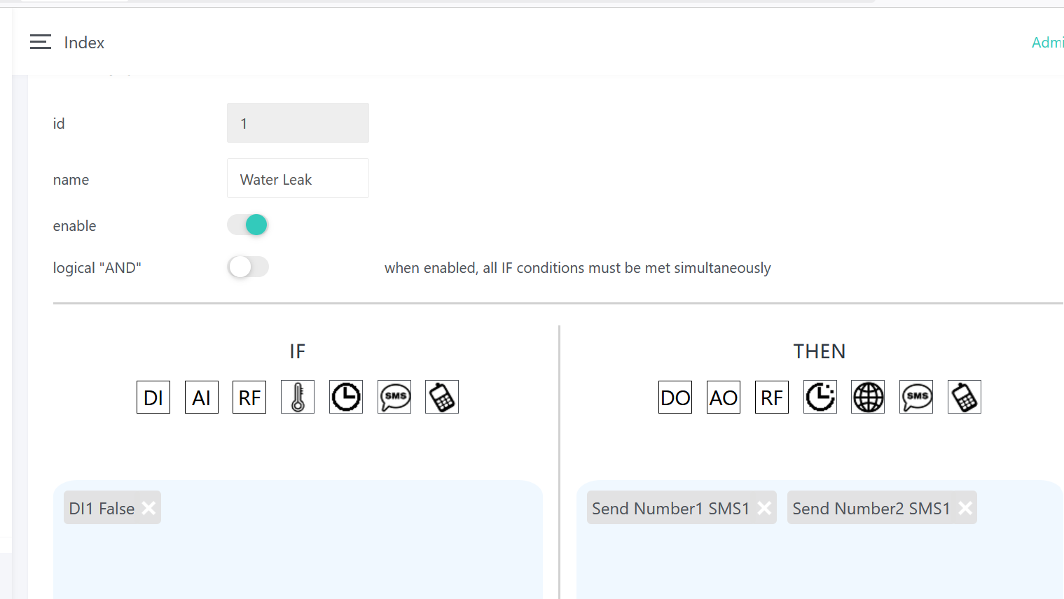

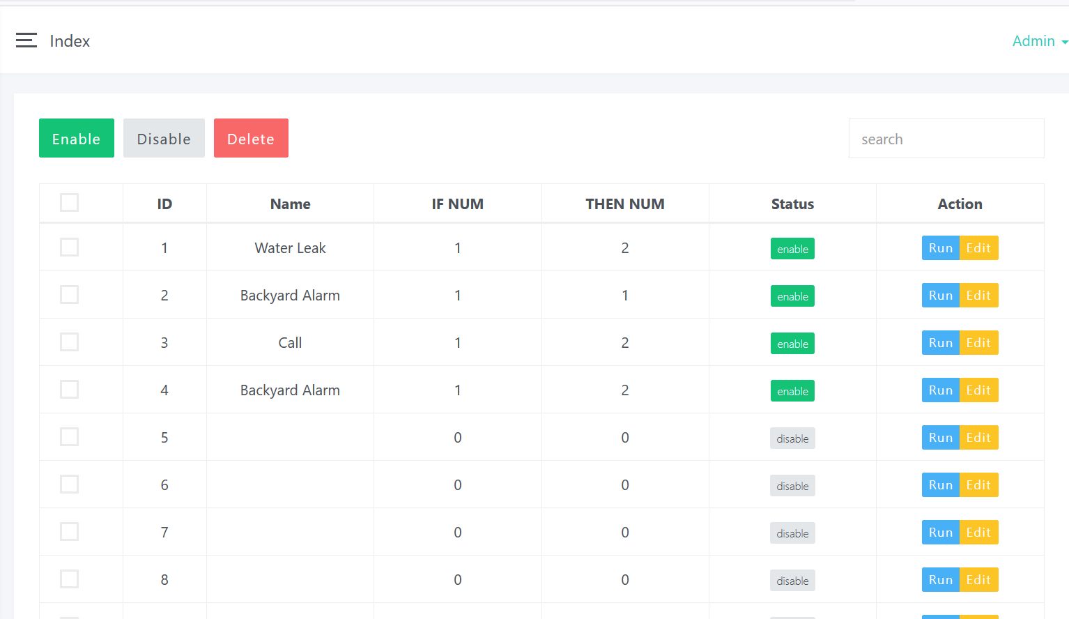

I have configured IFTTT to send an SMS once DI1 is True, but it doesn't send an SMS when DI1 is True. I changed DI to false it was the same result.
I did test 4G SIM7600 and it worked perfectly. It can send the test SMS and can make test call. But in IFTTT configuration, it does'nt send SMS or make call.
take photo of your setting screen.
what A32 Pro KCS firmware version you are using?
(07-19-2025, 12:11 AM)admin Wrote: take photo of your setting screen.
Photos of A32 Pro IFTTT attached
please use the newest firmware: https://www.kincony.com/forum/showthread.php?tid=8112

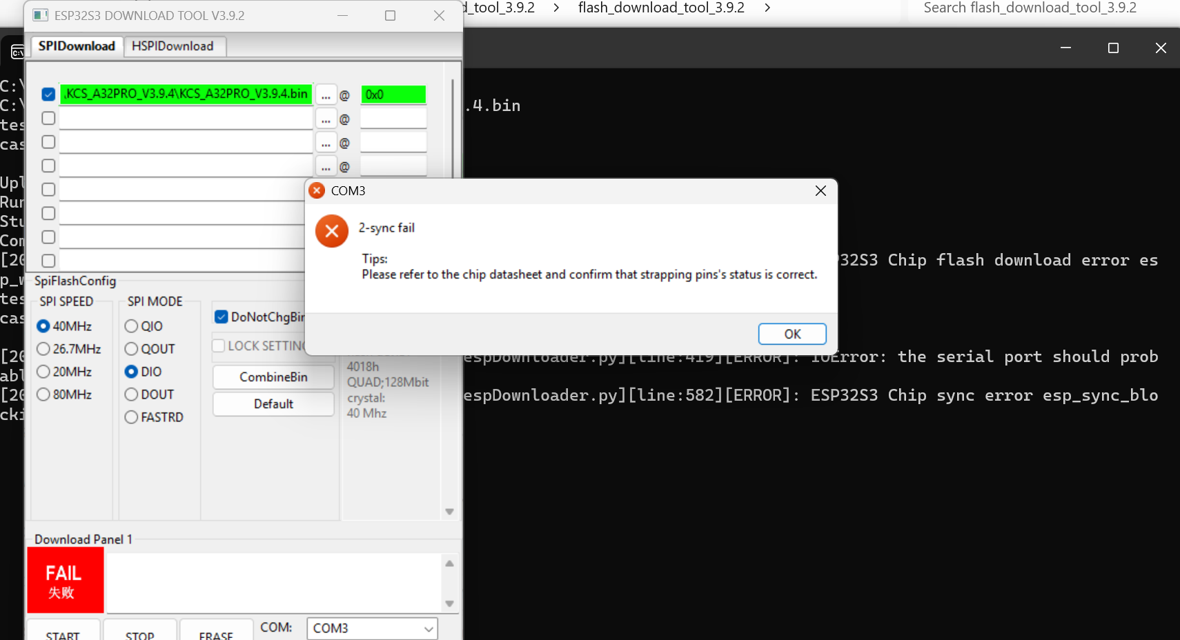

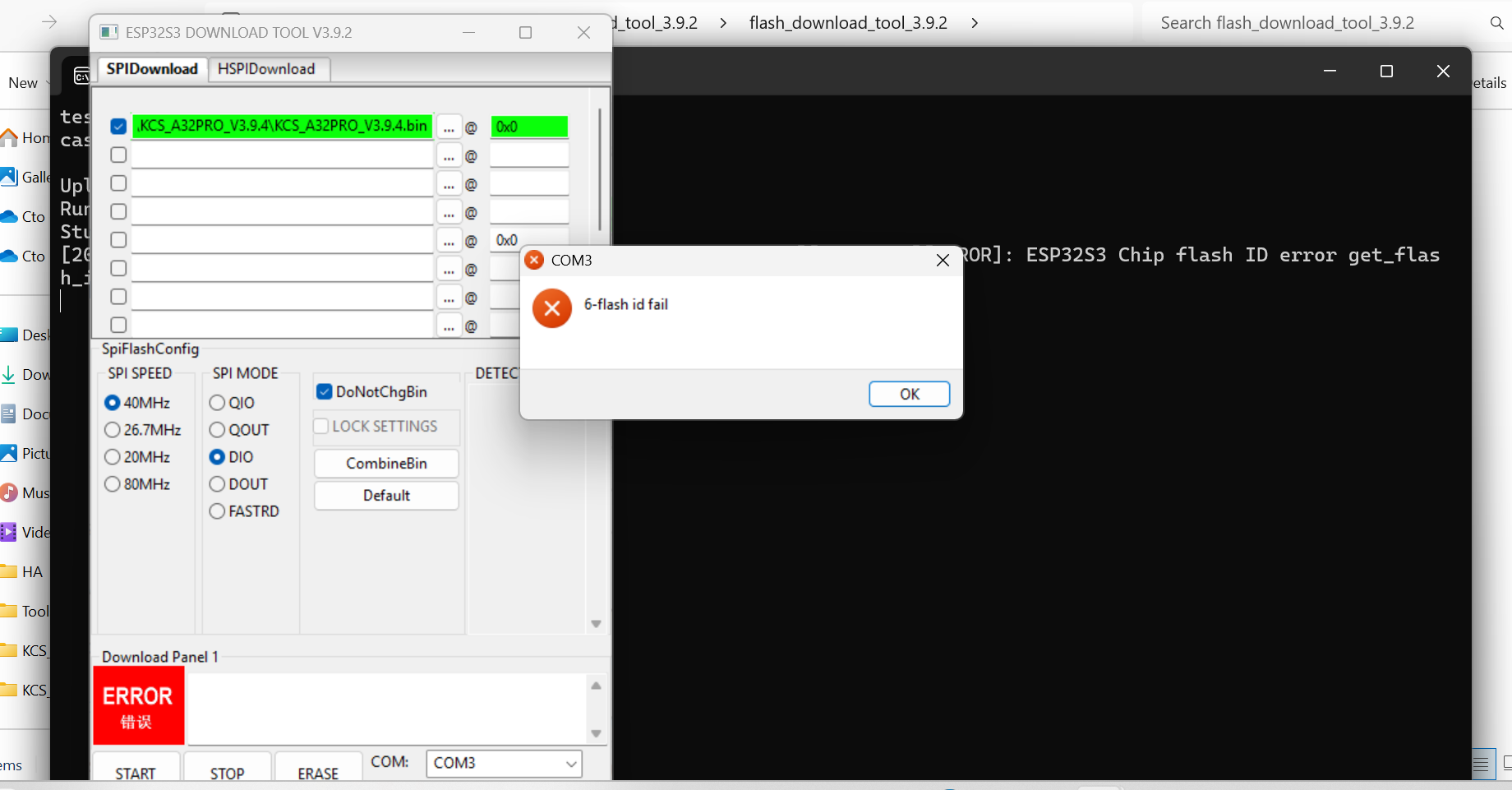

(07-20-2025, 01:51 AM)admin Wrote: please use the newest firmware: https://www.kincony.com/forum/showthread.php?tid=8112
I tried using the latest firmware as directed, but I'm getting errors. I powered off, held the download button, and powered on again. On flashing, I still get an error as shown in the photos
I have sorted out all the errors. System working fine now
ok, good.
