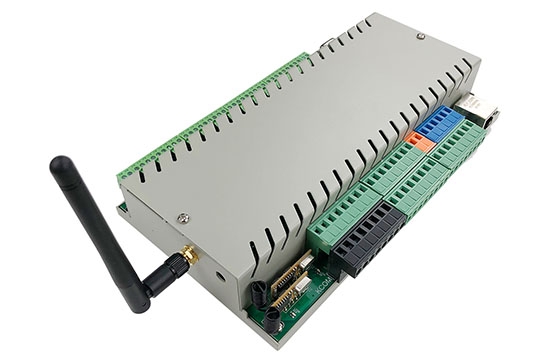

KC868-H32BS V1.39 new firmware update
[Image: kc868-h32bs_pix550.jpg]
improvement:
fixed bug sometimes can't save the setting after reboot.
download the ZIP file , unzip update the bin file for KC868-H32BS relay controller by USB-RS232 cable.
.zip   H32BS_V139_211010.zip (Size: 51.11 KB / Downloads: 1,117)
firmware update tool download: https://www.kincony.com/download/KC868-C...loader.zip
after flashing and hit run , ethernet leds of of the server of h32bs not lighting , how to reset?
if have problem, you can download from a old firmware version.
Do you using KC868-H32BS? take a photo of your controller.
(10-19-2021, 05:21 PM)deliad Wrote: after flashing and hit run , ethernet leds of of the server of h32bs not lighting , how to reset?
do have download V1.39 have problem,  download V1.36 is no problem?
(10-12-2021, 01:29 AM)admin Wrote: [Image: kc868-h32bs_pix550.jpg]
improvement:
how can i update with Ethernet not  USB-RS232?
KC868-H32BS only support update firmware by USB-RS232.
