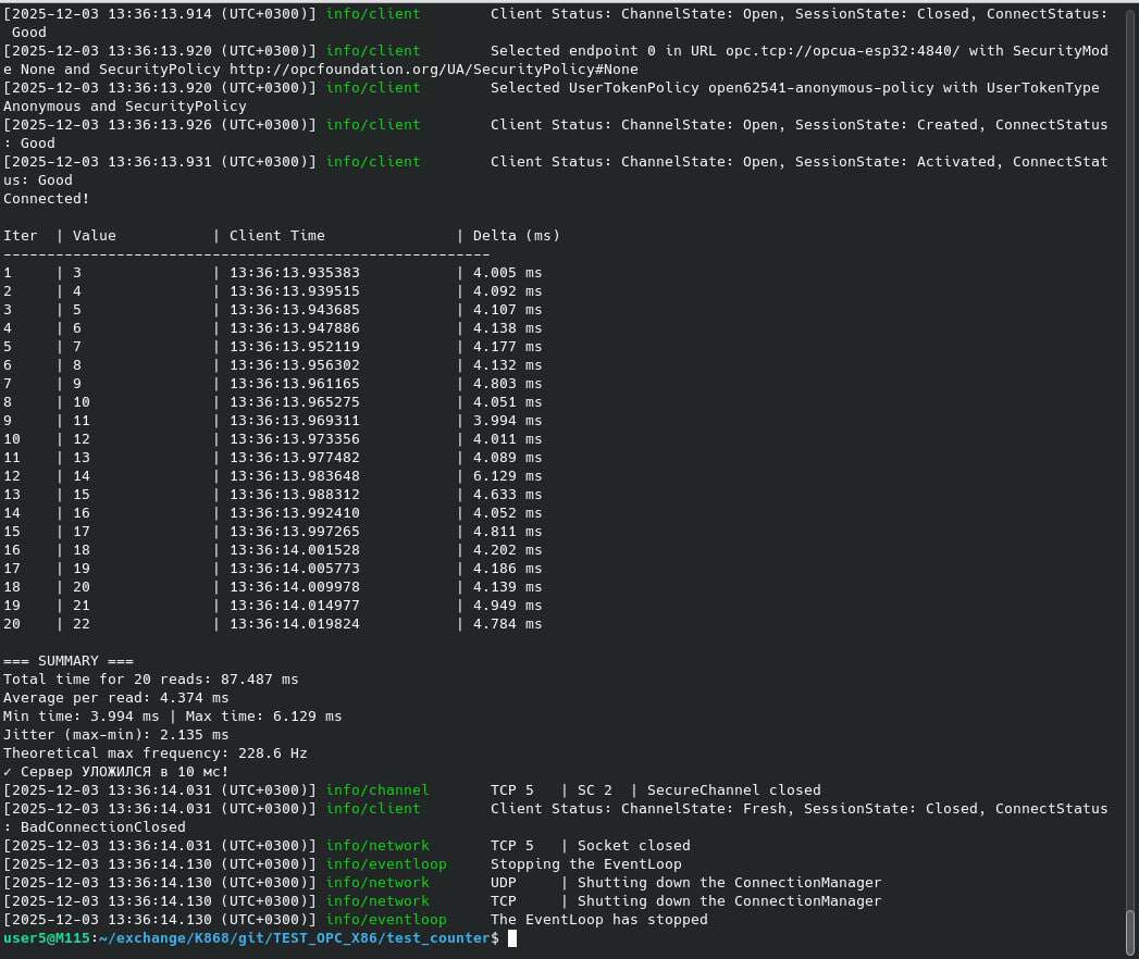

  • Performance: Achieves consistent read times of less than 5ms per tag in testing.

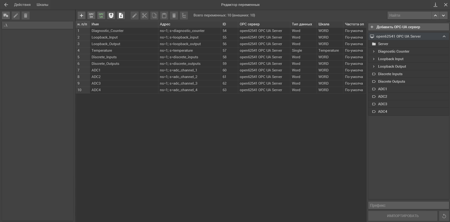

  • Real-World Validation: Successfully integrated and tested with an industrial SCADA system (Simple SCADA). Screenshots are attached below.
  • Complete & Open: All source code is available, documented, and ready to be built upon.
3. Proof of Concept & Evidence
The project is not a commercial product but a verified and stable proof-of-concept. The screenshots below show the server's data points (tags) being actively read and monitored in a real SCADA client interface, confirming successful integration.
*(Прикрепи здесь 1-2 ключевых скриншота из Simple SCADA)*
