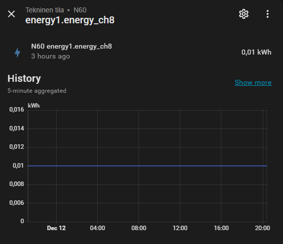

N60 not sending energy (kwh) information in MQTT message:
Example Monitor1 Channel 8:
Home Assistant data
Data from Kincony webUI
MQTT data from MQTT Explorer
N60 is periodically sending kwh energy data but is not correct.
