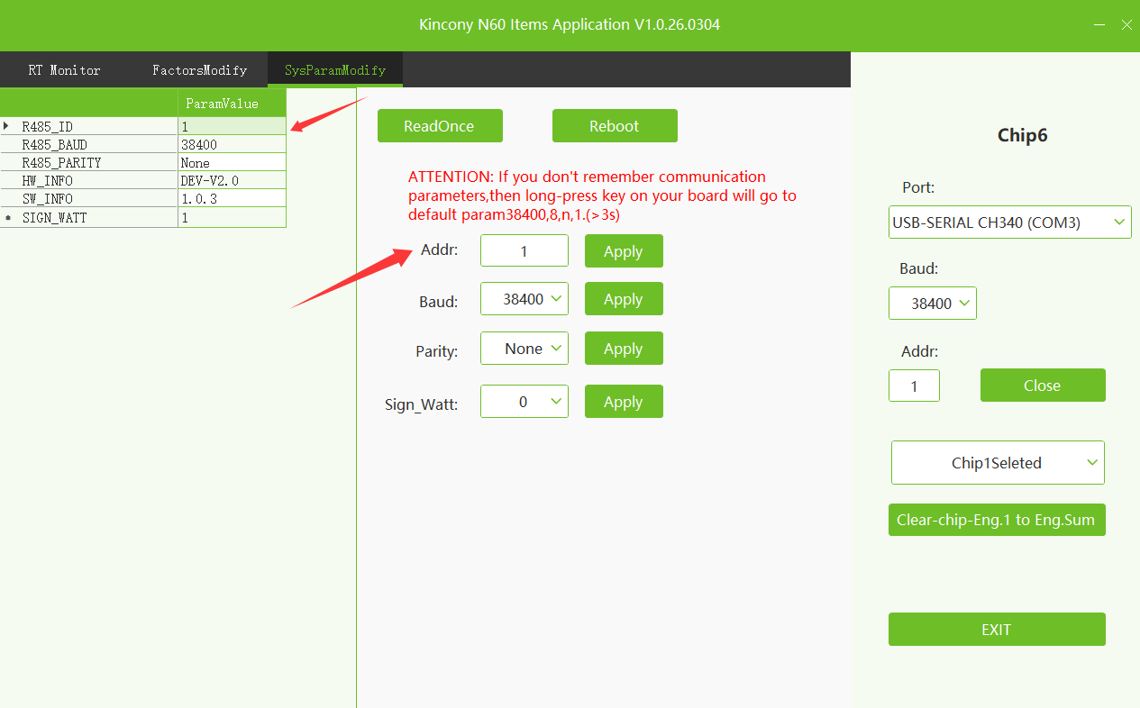

03-05-2026, 12:39 AM
You can use PC software, connect to Nx board by USB-RS485 adapter . So that can set for RS485 modbus address.

i suggest you wait for some days, we will release new ARM CPU firmware and PC software soon.
it will support 0.001kwh for unit.
