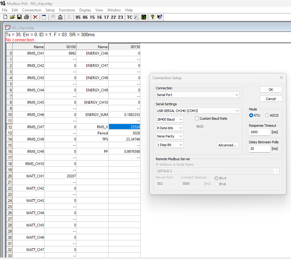

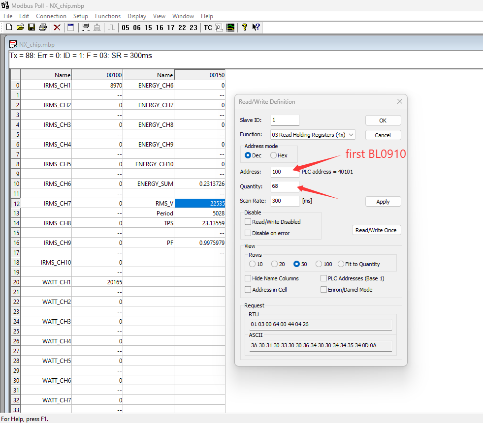

how to read BL0910 energy chip RAW data by modbus pull via RS485

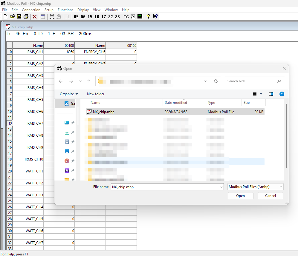

1: open NX_chip.mbp in modbus pull software.

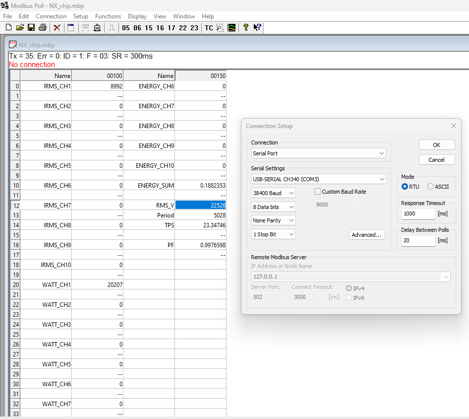

2: set COM port. you can use USB-RS485 adapter connect to your computer:
3:

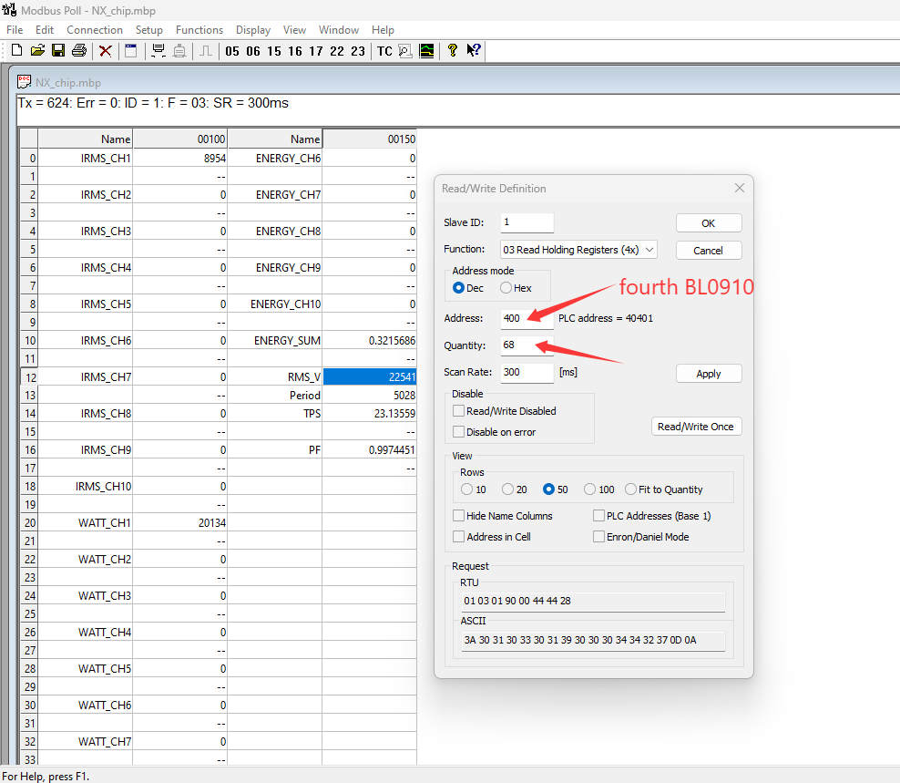

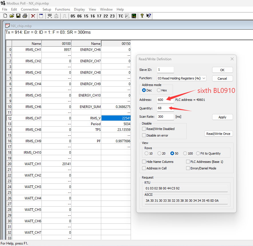

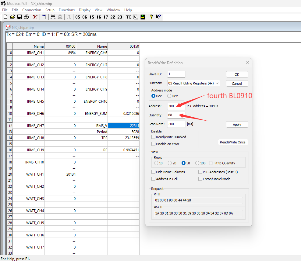

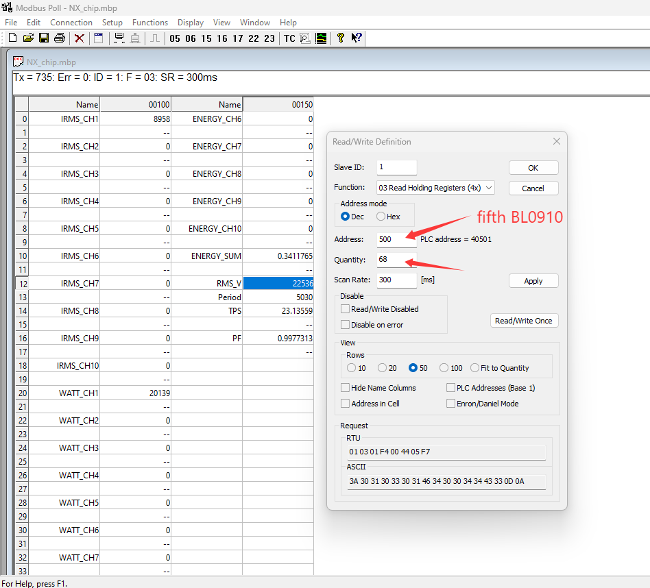

you can read BL0910-1 chip from address 100 , register count: 68
you can read BL0910-2 chip from address 200 , register count: 68

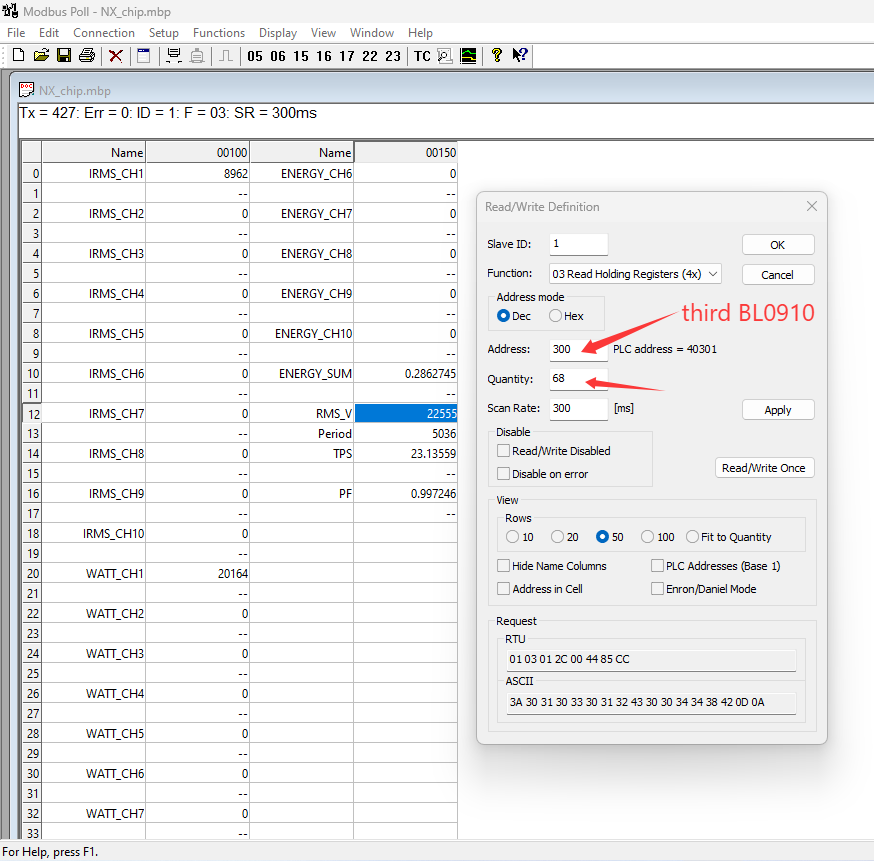

you can read BL0910-3 chip from address 300 , register count: 68

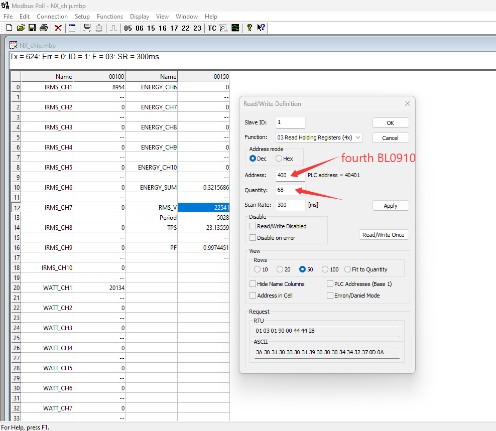

you can read BL0910-4 chip from address 400 , register count: 68

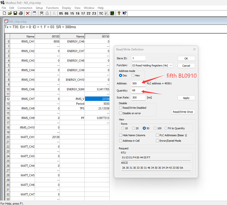

you can read BL0910-5 chip from address 500 , register count: 68

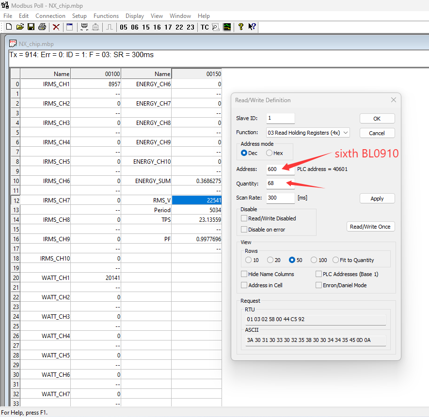

you can read BL0910-6 chip from address 600 , register count: 68
