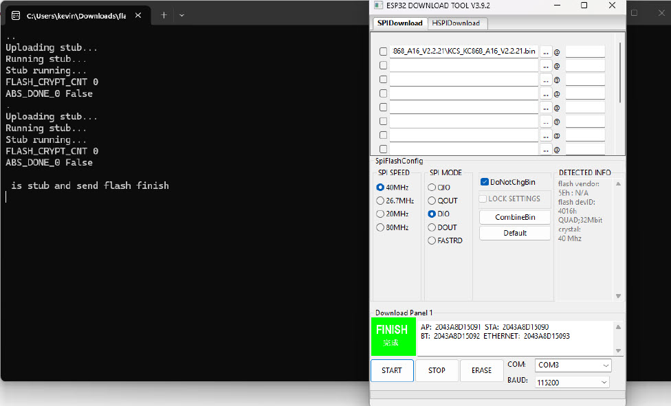

take a screen photo of your ESP32 download tool. how you set.
(10-07-2026, 11:43 PM)admin Wrote: take a screen photo of your ESP32 download tool. how you set.
OK here is 1st screen and then the screen after an erase and a download
you have lose step-3. you should select the file item. you can compare with your photo.
[Image: esp32_download_tool_2.png]
DOH!! missed that so easy to do!. Yes I have it working but I have had to revert to what I think is quite an old .bin file V1.0.10 - any other files I try to load wont work.
