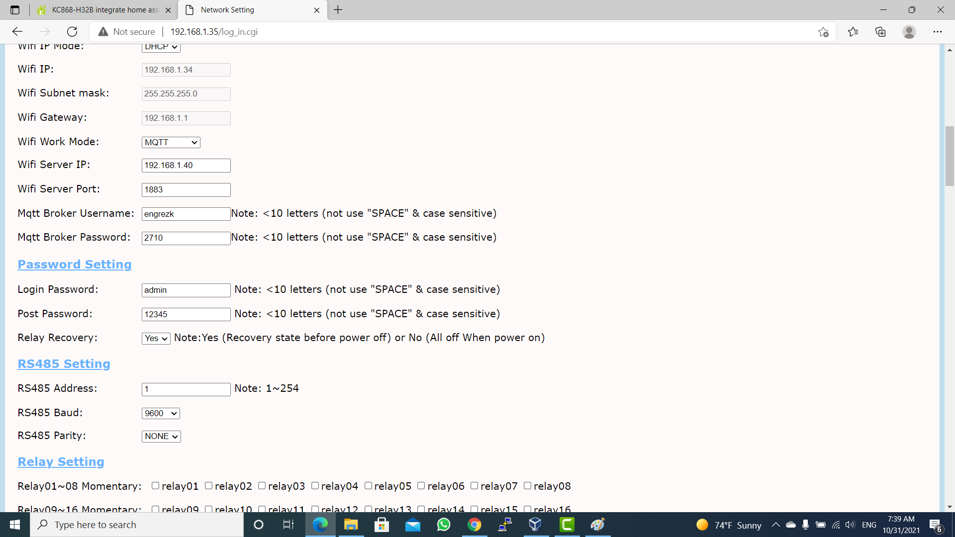

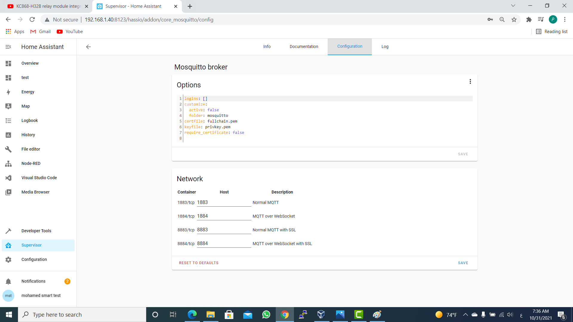

1. you have not use the user name and password for your Mosquito, but i have seen set in your H32BS' network setting.

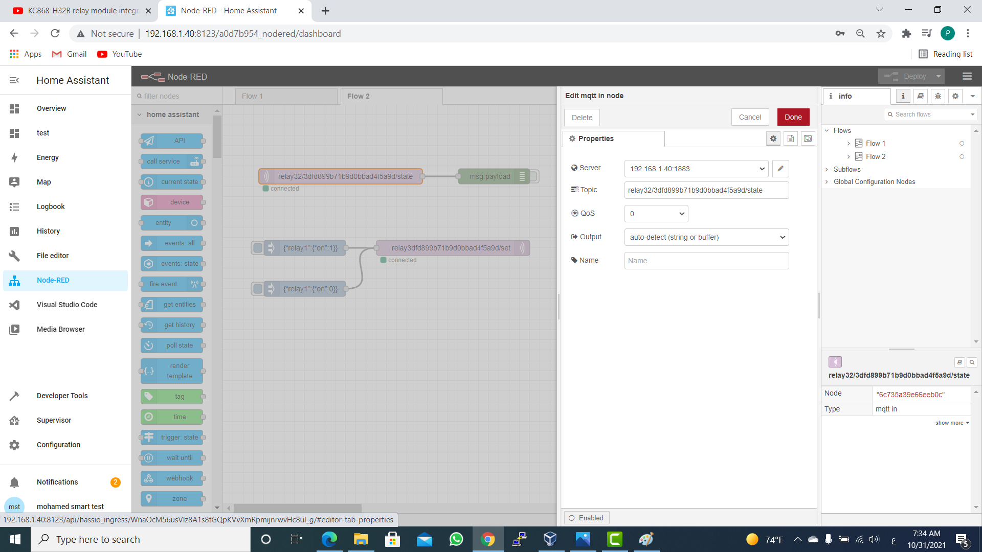

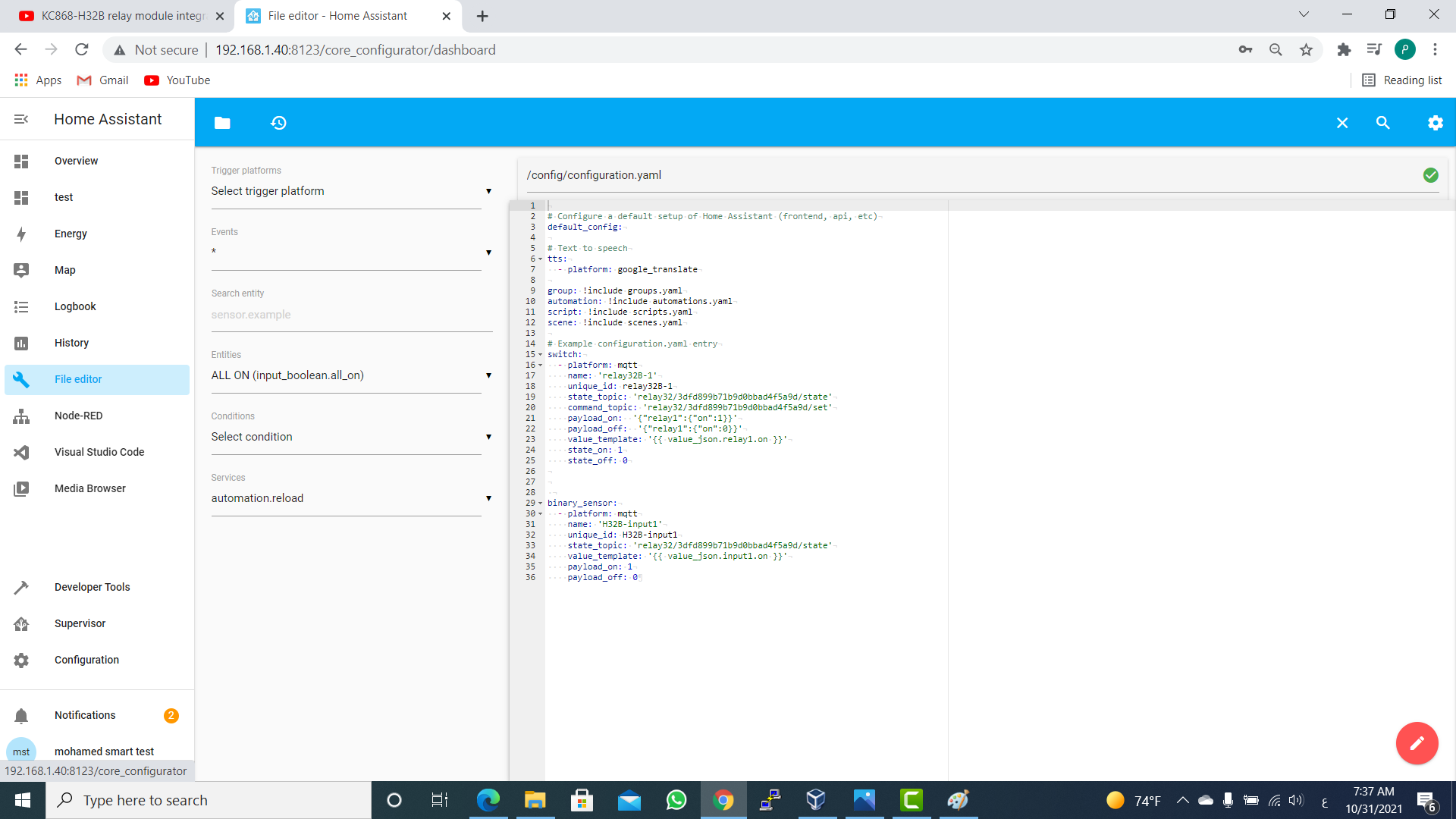

2. H32BS already support MQTT, so you can integrate directly to home assistant without use Node-Red.
3. suggest use ethernet MQTT, now i have seen you are using wifi by MQTT.
4. i think you can do as this video tour:https://youtu.be/Yrat7hVzXRw H32BS and H32B is same way for integrate with home assistant.
